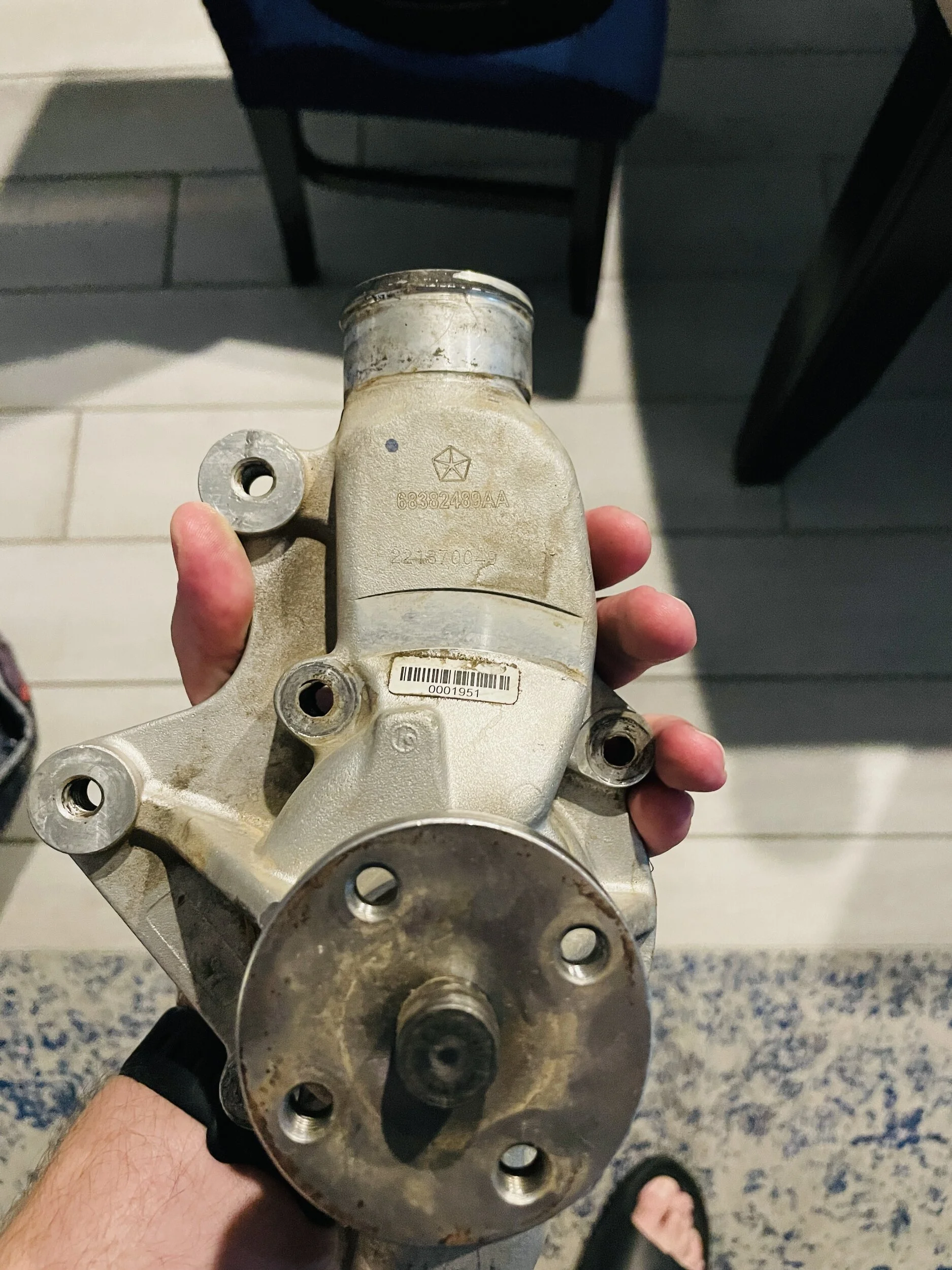

I just replaced my mopar water pump 68382489AA with a gates replacement.
The pump lasted 13 months and 14k miles.
Is that normal?

Was it a true mopar? I bought what I thought was a mopar pump from wermopar.com in 2016. In 2021 after 60k miles it failed. Turns out there were no Chrysler/mopar indicators on the pump. I've since gone with a Gates. It has maybe 5,000 miles on it though.

No, not normal. What’s the fluid look like?

To be clear, it didn't fail or leak, but it was the source of squeaking under the hood that I wasn't going to live with, and it was getting worse.

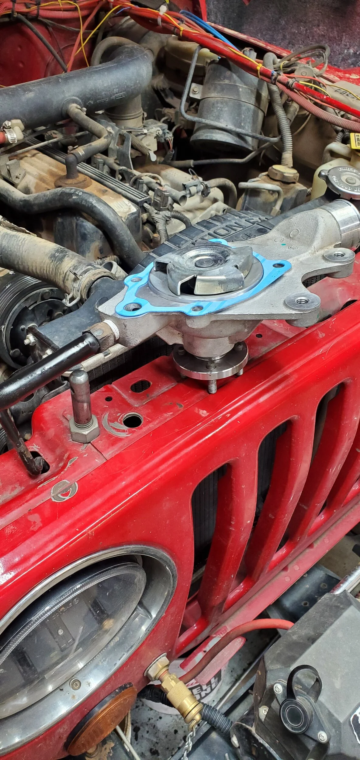

Water pumps are one of those "you never know" situations. I always replace them when I get a new to me vehicle - the one time I didn't, it failed in fairly short order. I knew better, and it bit me in the ass. It was my TJ! I replaced it with a Gates.

I installed a Gates almost exactly 3 years ago. IDK how many miles, but I drive it pretty regularly around town. Mine definitely had a metal impeller (since somebody else brought it up).
