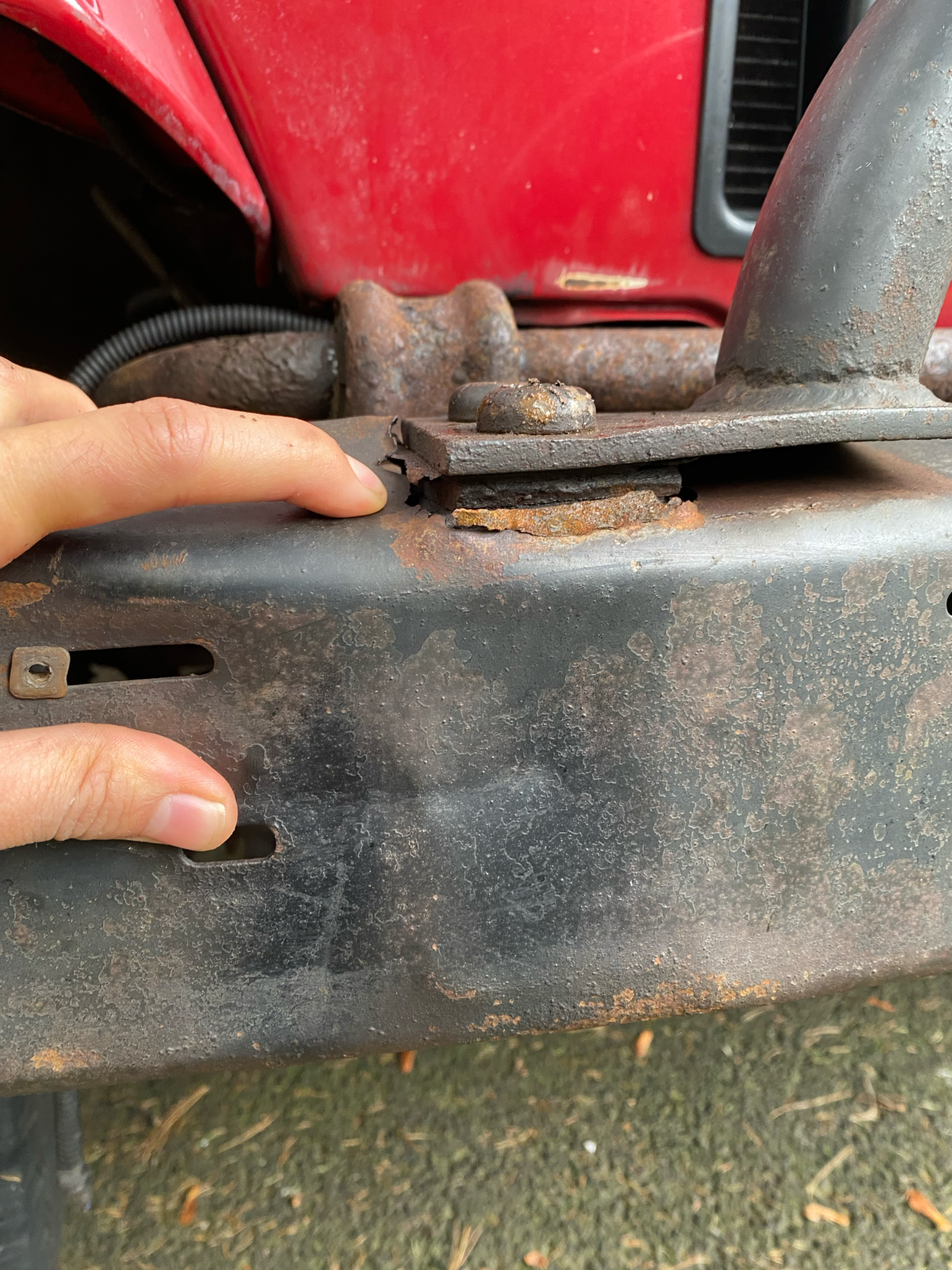

what should have been a 5 minute job has become extremely frustrating. The welded nut inside the frame of the jeep where the bumper screws onto has broken off. Since the nut is not attached to anything I can't fully unscrew the screw. I also can't hold the nut with socket or even needle nose pliers, as its pressed up too close to the wall of the frame with no room to fit anything in-between (yet still enough space for the nut and screw to spin around indefinitely.
Will I have to cut off the bolt head and drill down into the screw to completely destroy it and pick out the pieces?
The other Torx bolt (stripped out) is stuck fast, ive already used head on it, so I guess I will have to buy an extractor kit.. Most on Home Depot have low ratings, any recommendations for a good set that will get the job done on the first try?

The GREATER issue of concern would be the cracked frame rail behind the bracket where the bolts screw into...
Both pictures 2 and 3 show the cracks above the bracket and will need to be repaired prior to reattaching the brackets.

Is that the frame or the bumper? I thought that was the bumper...

the bumper the cracked. the screws are actually screwed into a bull bar, and the bumper is cracked below.

Are you sure ?
Please provide additional pictures...
The frame rails are usually radiussed (rolled) when formed.
The bumper brackets usually have a 90*; to me the pictures indicate otherwise

I was thinking what he said - that's the bull bar end bracket, on the bumper, on the frame horn, with the crack in the bumper (rust induced?).

The torks head bolts go thru the hoop mount base then thru what appears to be a stock bumper and screws into the clips which are attached to the frame rail.
Since you are probably going to replace the stock front bumper once you get the torks bolts removed; why not cut a circular hole in the front of the bumper to access the threaded end of the torks bolts and the clips.
I wouldn’t mess with an extractor set.
I’d put a Torx socket in that stripped head, weld it, maybe over weld it, to get it hot AF, then use a breaker bar to turn it out.
