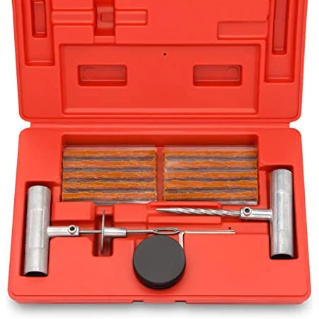

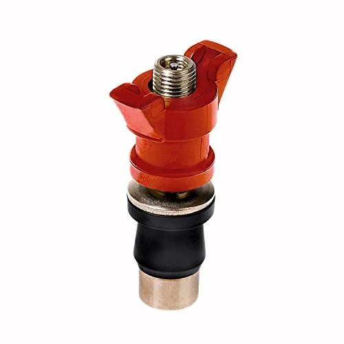

I did the Nevada Trophy event a few years ago, https://www.nevadatrophy.com. not as intense as what your talking. It is a timed event so we ended up driving much faster than I normally would. What I learned is to make sure everything is strapped very tightly down, and don't us a bumper mounted tire rack. I had a 35" tire along with a couple of Rotopax for gas. By the end I was using watch straps to keep it closed. This was a Rock Hard 4x4 bumper which is very well made an heavy bumper I would add an air compressor not a tank as those can run out and take up valuable space. Also a tire patch kit and Colby emergency valve stems
