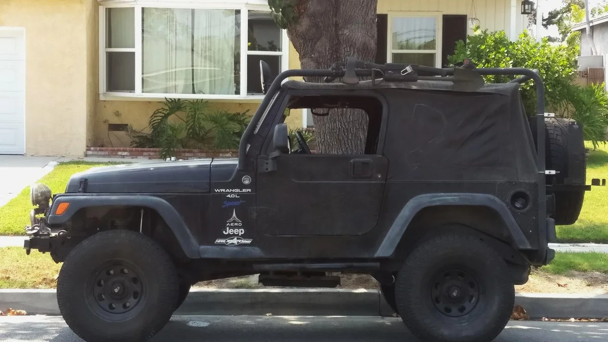

I am looking at learning aluminum welding and replacing my outer cage with an aluminum one. It's for storage only and maybe a rooftop tent, but not protection. I noticed significant body roll reduction when I took it off to repair it.

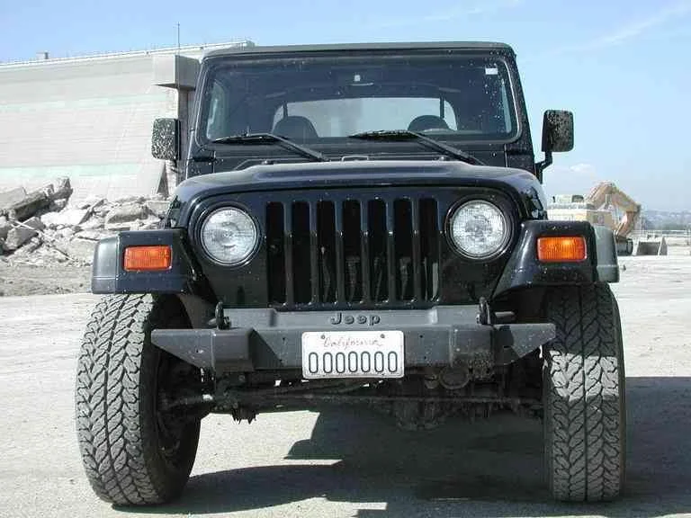

I assume the stock front bumper is about as light as you can get?
I have been considering a tummy tuck for a while for several reasons including weight reduction. Maybe need to start researching more on that....
Yeah, Stock bumper is 21 lbs with end caps. I plan to trim/shape the bumper for aesthetics so should have it down to 18 lbs. My XRC bumper is listed at something like 62 lbs and winch with hook and fairlead is 94 lbs according to SmittyBilt. So, 156-18= 138 lbs saved! I'm not including the 4 lbs for both factory tow hooks which I may or may not install for now. Also, Not sure if listed bumper weight includes both D rings or not but as you can see, I leave them off when just driving around town.
Forgot to mention in my above response that a general rule of thumb is that every 200 lbs = 1 mpg gained.
And, I PLAN on doing this with the OEM bumper...
Nope. The Savvy front bumper with hardware weighs the same as a stock bumper.
Just weighed the OEM front bumper yesterday...21 lbs with end caps. Savvy listed as 30lbs (assuming without optional build options like winch mounting plate or bar). But for all intents and purposes, 9 lbs is a negligible difference.
Just weighted the OEM front bumper yesterday...21 lbs with end caps. Savvy listed as 30lbs (assuming without optional build options like winch mounting plate or bar). But for all intents and purposes, 9 lbs is a negligible difference.
There is not a 9 lb. difference.
