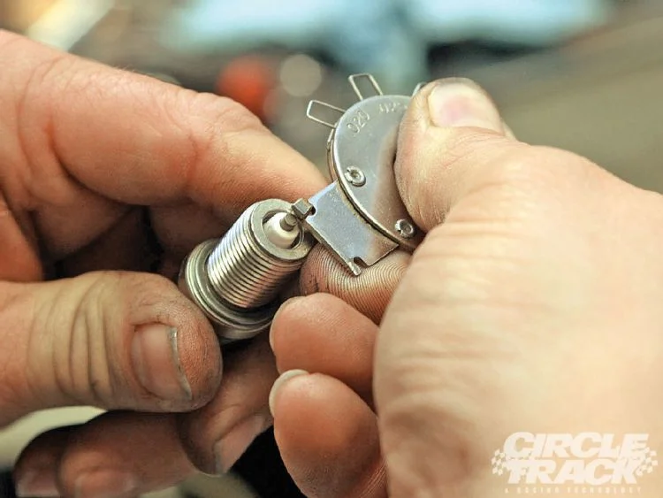

I was told (or read....) that you shouldn't adjust the gap on platinum or iridium plugs as they come preset, and can be damaged if you try and change it. Do you know if there's any truth to that?
I need to check the plugs in mine, and I don't want to damage new plugs if I need them.
The platinum or iridium electrode coating could be damaged if you used a tapered gap setting tool which would abrade the coating as it was slid through the electrodes to widen the gap. Like tapered edges or square loops of wire you force through the gap.
Don't use one like this on platinum or iridium plugs...
Gap setting tools with a notch cut into them that grabs the electrode next to where it is welded to the threaded area can bend the electrode up or down without damaging the coating.
Use one like this on any type plug including platinum or iridium...

Plugs supposedly come pre-gapped but pre-gapped for what? One gap setting is not going to be correct for every single engine it'd be the right plug for. Not to mention it is not uncommon for a boxed spark plug to be accidentally dropped before it's sold which can change its gap setting.
In my book, it's always best to spend 30 seconds on each plug before installing it to make sure its gap is correct. That can save a hard to diagnose problem later.
The coating could be damaged if you used a tapered gap setting tool which would abrade the coating as it was slid through the electrodes to widen the gap. Like tapered edges or square loops of wire you force through the gap.
Like this...
Like this...
Thank you sir. I only have a gap tool like that round Champion one. Time to get one with the notch I think. :)
