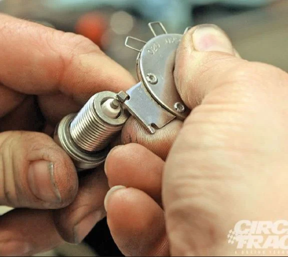

.035 is the official gap but the newer coil rail ignition gives so much more spark voltage that .040 is a popular/commonly used gap too.
Make sure to only adjust the gap with this type of gapping tool.
Don't use this style with the round tapered gap adjuster which can damage the platinum or iridium coating.
Reactions: Jerry Bransford
The platinum or iridium electrode coating could be damaged if you used a tapered gap setting tool which would abrade the coating as it was slid through the electrodes to widen the gap. Like tapered edges or square loops of wire you force through the gap.
Don't use one like this on platinum or iridium plugs...
Gap setting tools with a notch cut into them that grabs the electrode next to where it is welded to the threaded area can bend the electrode up or down without damaging the coating.
Use one like this on any type plug including platinum or iridium...

so what should the spark plug gap be on the Autolite XP985 be set at in my 2005 TJ 4.0 liter engine?
