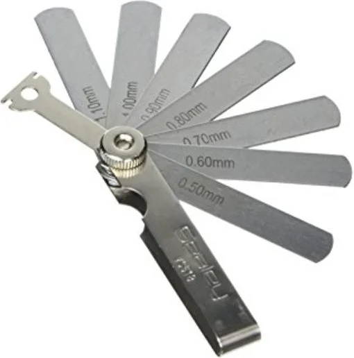

Ok, I'm going to pull the trigger on the AutoLite XP985 Iridium Plugs. They're expensive, but I'm certain, based on the reviews on this post, my own gas mileage and performance that once I make the change I should notice a difference.
Here's the question; in an earlier Post on this Thread, there's mention of gapping the plugs. Now supposedly, the Autolites come "Pre-Gapped". But I'll be damned if I trust them to be gapped correctly. So because their Iridium is it possible to use a Gap Tool like this; Without damaging the Plug and if so, what's to proper technique if any to increase/decrease the gap?
