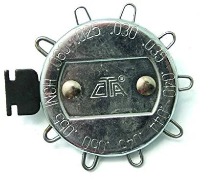

Make sure to not use a tapered style spark plug gapping tool on iridium or platinum plugs, they'll damage the coating. Use the type with the gapping tool that bends the electrode, like this one has on the left-hand side.
crap. I used the ramped one...

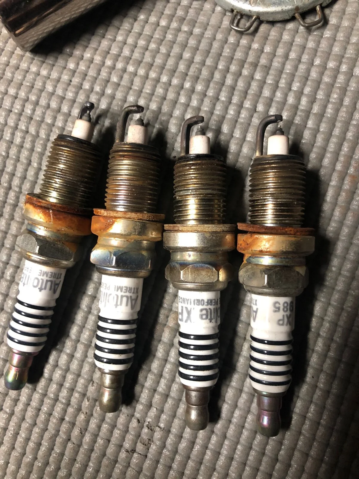

So got the plugs replaced this evening. They were also the XP, but the gaps seemed all over the place. Some were.040 some were .035, two were .025. Look pretty lean? View attachment 224156 I guess we'll see when I get the rest of the work done, waiting on a ODPA. Question though, is it necessary to use anti-seize on the coil bar bolts? Thanks!!
No antiseize needed for the coil rail bolts. If by that you're planning to put antiseize on the plug threads, use the smallest amount possible and make sure none can make its way to the electrode. Antiseize is conductive.
Look pretty lean? Im also tracking down elevated RPM when clutch is engaged when driving, it also had a run-on high idle the other day...ODPA going in, cant find a mopar sensor (discontinued), so its gonna be a Echlin. Going to clean the TB and idle control, maybe replace the O2s......hopefully these will solve it...Jeep was sitting for a long time...Lots of work to do still
