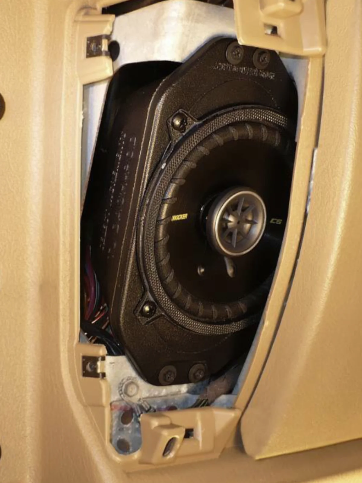

I put the forum recommended Kickers in my dash, and some older Jensens I had on hand in the sound bar. They sound VERY nice - in fact, so nice that I put Kickers in my other car with a similar betterment of sound.

CSC5 in the dash of the Jeep. It started with the stock HU, but I replaced that with a Jensen "Heavy Duty mechless" unit.
I honestly can't tell you the difference between the stock speakers and the Kickers with the stock HU. The stock HU had a blown CD player, and thus I couldn't play "my music" in the thing to be able to tell. But the combination of the new HU and speakers was so good that I put new 4x6 Kicker CSC in all 4 places on my old Mercedes, and I can tell the difference. That car already had a newer (2016) aftermarket HU in it, but I figured after 36 years, it was time to replace the speakers!
