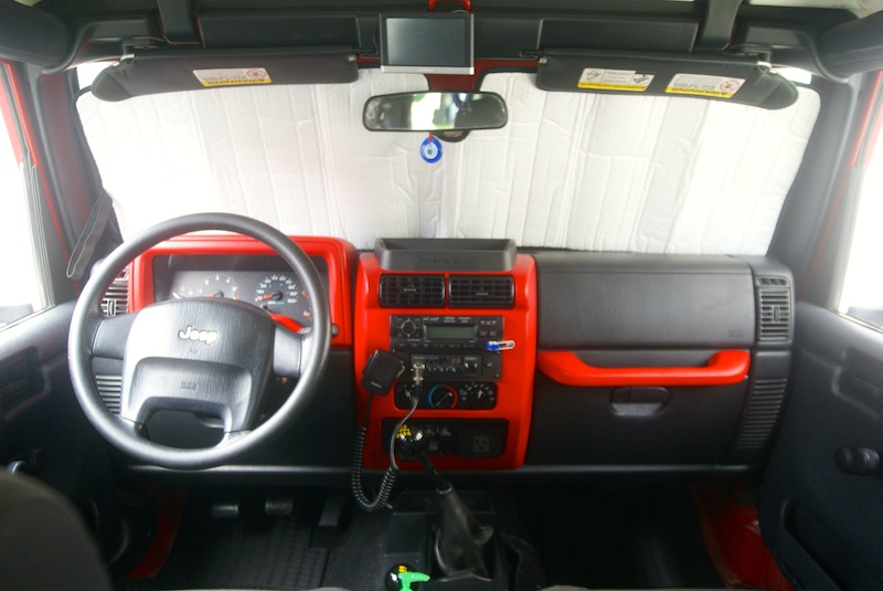

Why two??
CB, and stereo both.

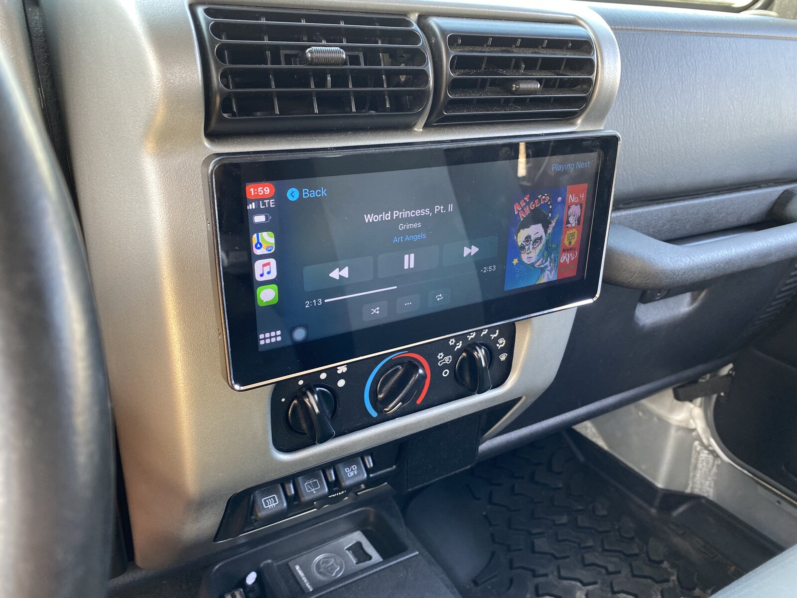

I've been thrilled with:
Joying 8.8" Single-DIN head unit floating bezel with CarPlay & Kicker CS speakers/Select Increment Dash Pods
For those that want a new head unit and don't want to swap in the Double-DIN bezel, I can't recommend it enough. It looks like it was made for the TJ, fitting cleanly between the vents and HVAC controls. I looked into other options but the non-widescreen aspect ratios on them didn't play nicely with the vents.
And while the Joying has its quirks (Chinese manufacturer, CarPlay implementation on Android-based HU), at < $400, it's a great deal.

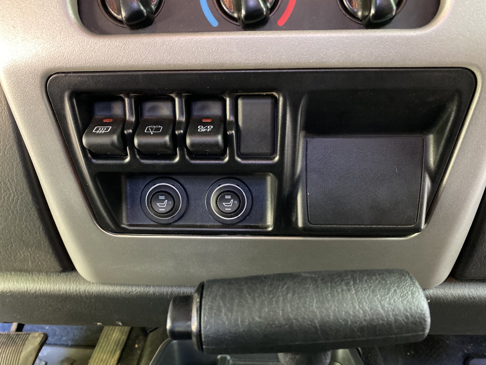

Heated seats - $50 kit from Amazon and about an hour install.

I still really like it. As I noted, it has a couple of quirks. Every few weeks it has an issue automatically connecting with wireless CarPlay and I have to reboot my phone. And the addition of the steering wheel controls is a must with no hard button for volume control. But I would definitely buy it again. The screen size and aspect ratio are perfect for the TJ

Definitely love the heated seats. Put my first set in my ‘04 Rubicon back in 2004 and have added them to every TJ and JK I’ve had since. Tough to top cool nights with the top down and heated seats.

What was involved with doing the remote locks and heated seats?
Remote locks
InstallGear Keyless Entry System... https://www.amazon.com/dp/B01MDLUTPC/?tag=wranglerorg-20
I used these actuators because they are smaller
Install Essentials 524N High Power Door Lock Motor https://www.amazon.com/dp/B0009SWLE6/?tag=wranglerorg-20
Heated seats
WATERCARBON Tech Era Carbon Fiber Seat Heater Kit Hi/Lo Setting, 2 Seats https://www.amazon.com/dp/B008D2LIRG/?tag=wranglerorg-20

How hard was it removing the seat covers and putting them back on properly ?
Reactions: Apparition
It’s easy in an LJ... You don’t even have to remove the seats from the Jeep and can just do it with the seat backs reclined and upholstery still in place. I think I got the elements installed on my current Jeep in less than 45 minutes.
For the seat back, with the seat reclined you can unclip the upholstery at the bottom. With the backing mostly still on the adhesive strips but started and folded at the top, slide the element up the seat back. Once you have it placed, reach up and start pulling the adhesive strip backing off. Run the wire out the back close to the center console and move to the base.
For the seat base unclip the upholstery behind the slider handle and roll the upholstery up as far as possible. With the backing mostly still on the adhesive strips but started and folded at the back, slide the element into the seat base. Once you have it placed, reach in and start pulling the adhesive strip backing off. Run the wire out the back close to the center console and move to the wiring.
