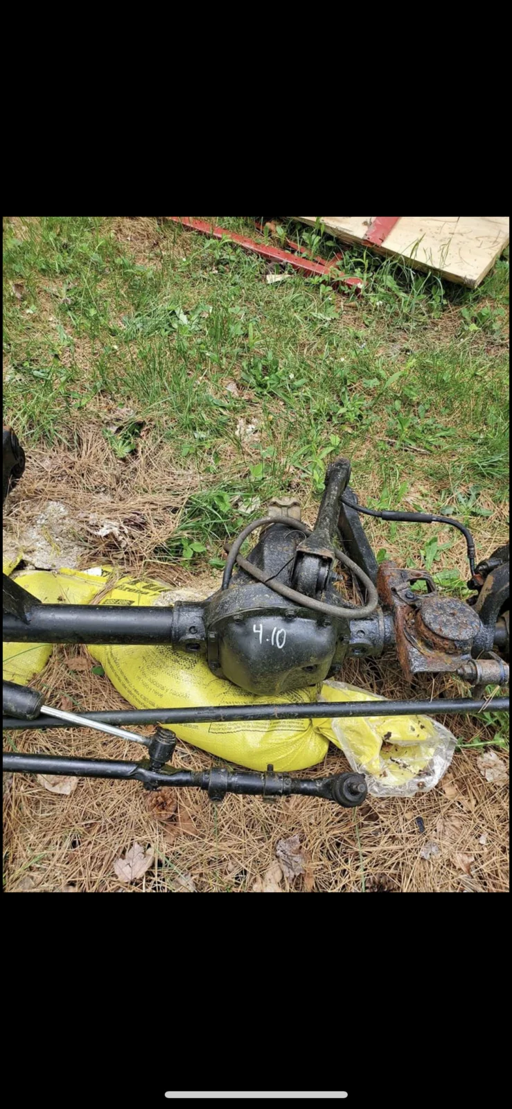

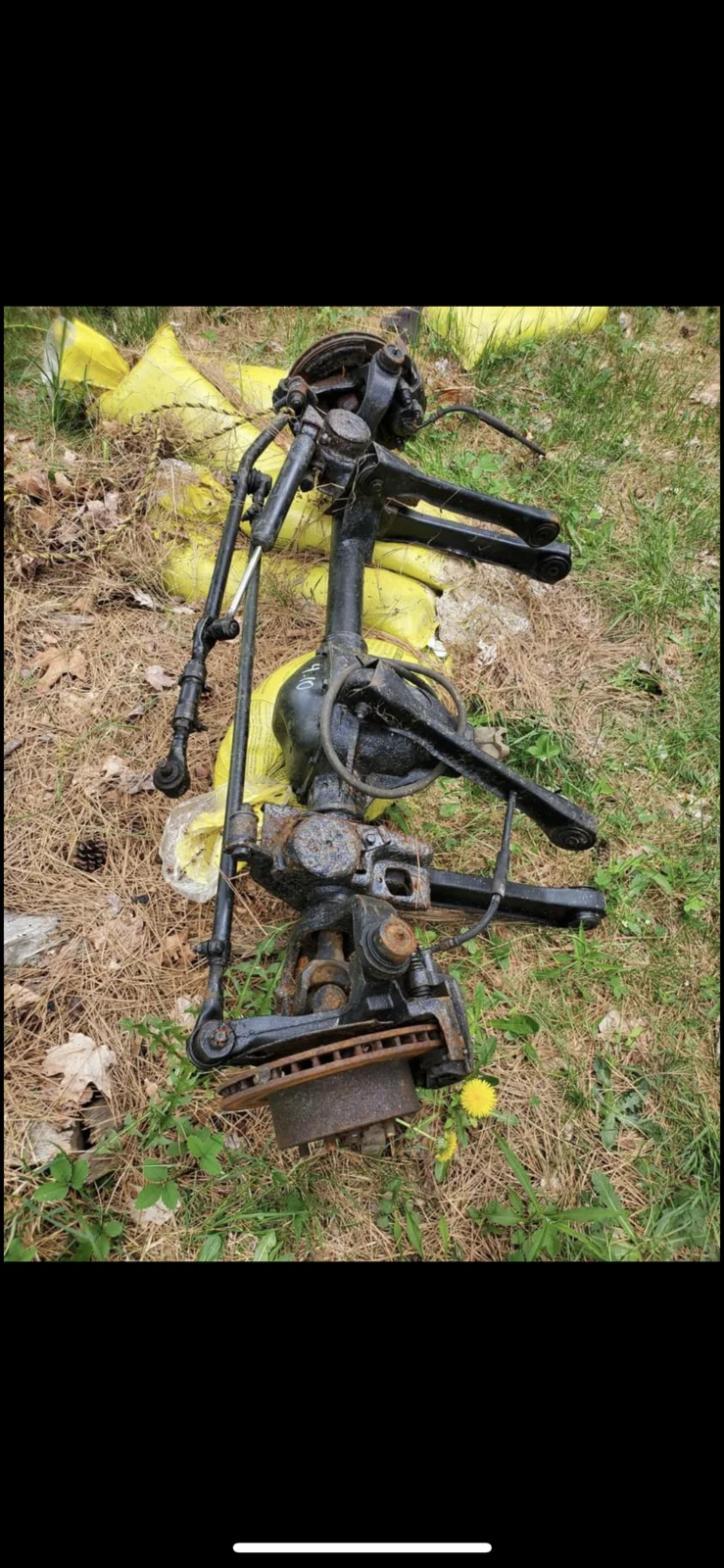

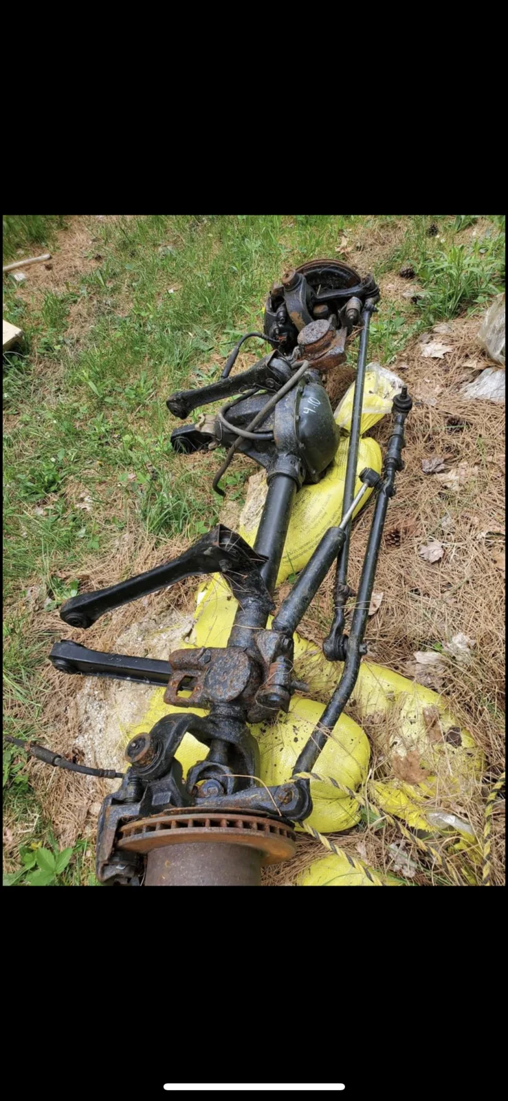

Hello! I’m looking for a Dana 44 front axle, this guy on FB Marketplace says he has a Dana 30 with the factory 4.10 gears from a 2004 sport, but they didn’t come with those gears, I’ve attached pictures. Could someone tell my by the picture if this is a Dana 30 or 44? If it’s a 44 then is it in good condition to buy? Price is $175. If it is a Dana 30 i have no use though. Thanks!!
A 4 cylinder would have came with 4.10s. It's a 30.
Definitely a LP 30. Good news is tag is still on it so as long as it has not had the ratio changed it is stamped on the tag along with the BOM.
