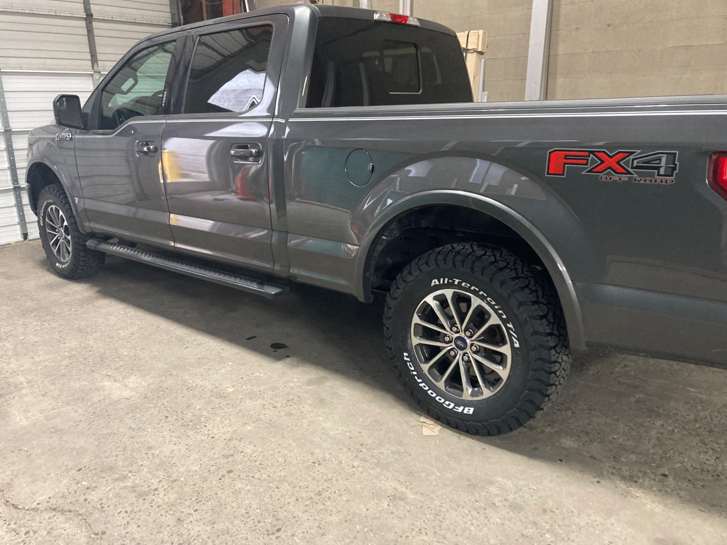

I posted this in my build thread last week, but I bought the DD new shoes. Falken Wildpeaks AT4W. The duratracs had 67k miles on them. I've only got about 400 miles on these but they're quiet and and seem to grip pretty well. No issues towing over the weekend. The Falkens are slightly narrower and heavier vs the duratracs and a little bit less aggressive.
