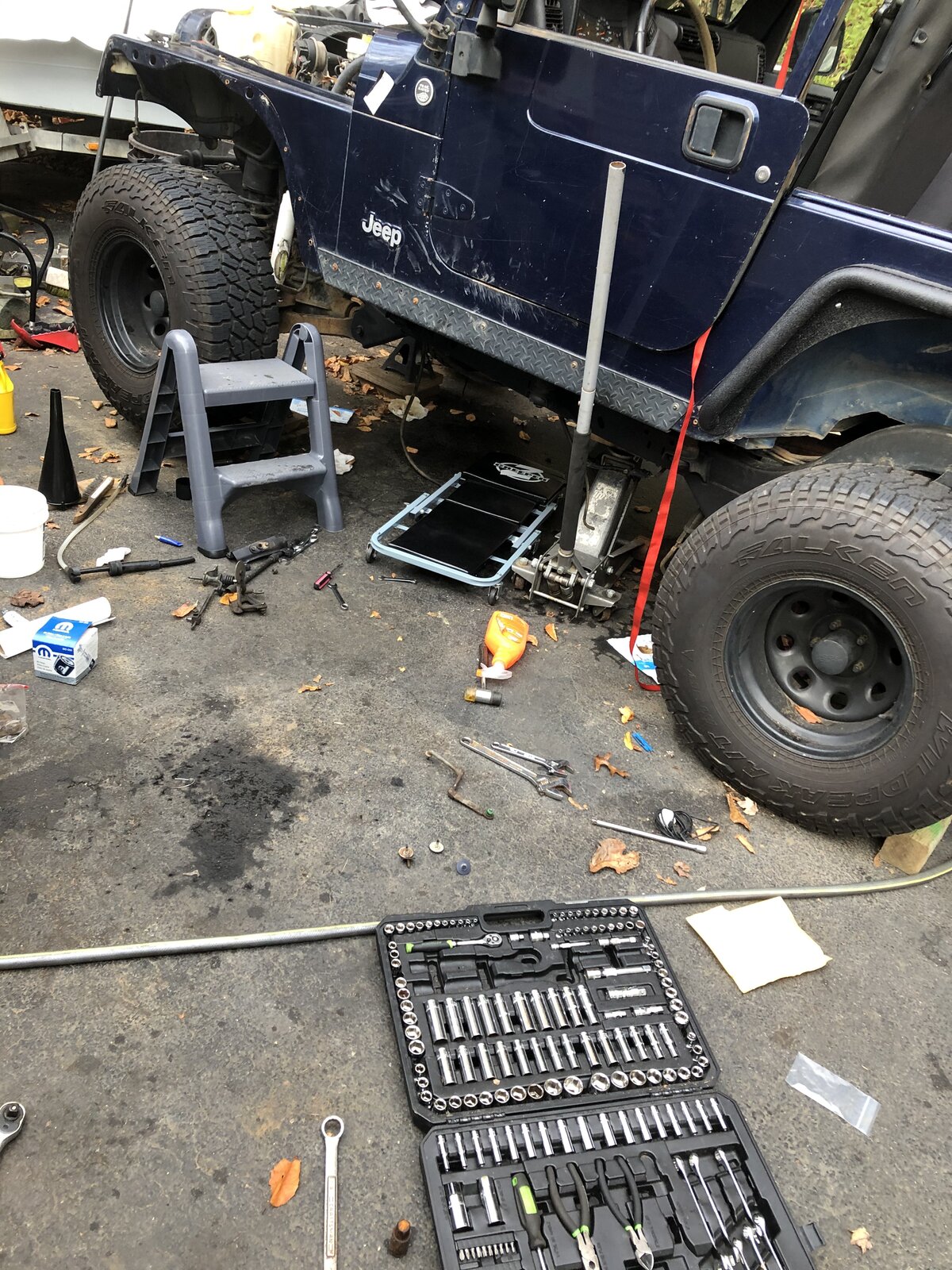

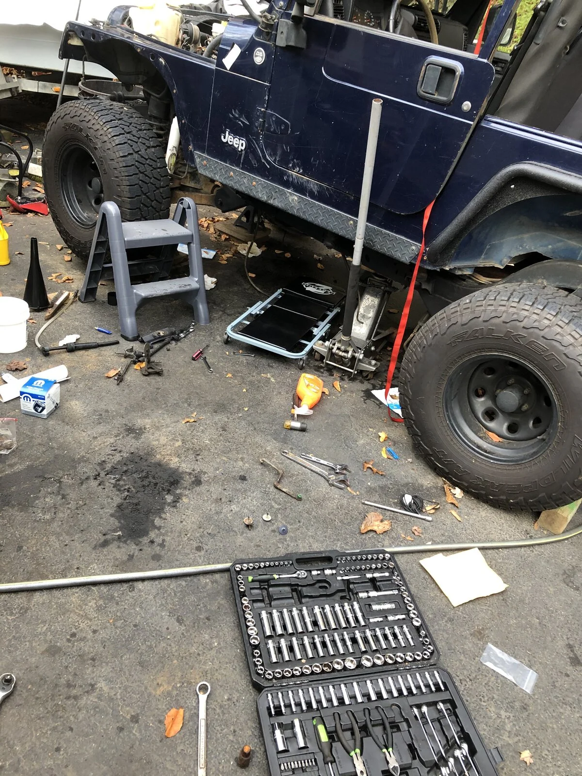

My kid got his new clutch in, tranny back up first try, RMS replaced while he was under there, Fomoto drain plug (which was open when he put the oil in (note to self) and a Savvy TC cable shifter in today, punched out his third cat, blasted and painted his oil pan...I watched, and drank beer. But I must say he is doing it right, Mopar parts, even ordered a metal TOB not trusting the plastic one that came w/ the LUK clutch kit. I'm proud of him for doing it right the first time.
Still waiting on my TPS to show up....so I can park mine for winter?
Yeah, this is pretty much what his room looks like :LOL:
I’ve had that same tool kit for years. I think @Apparition has one too. Best $80 I ever spent!

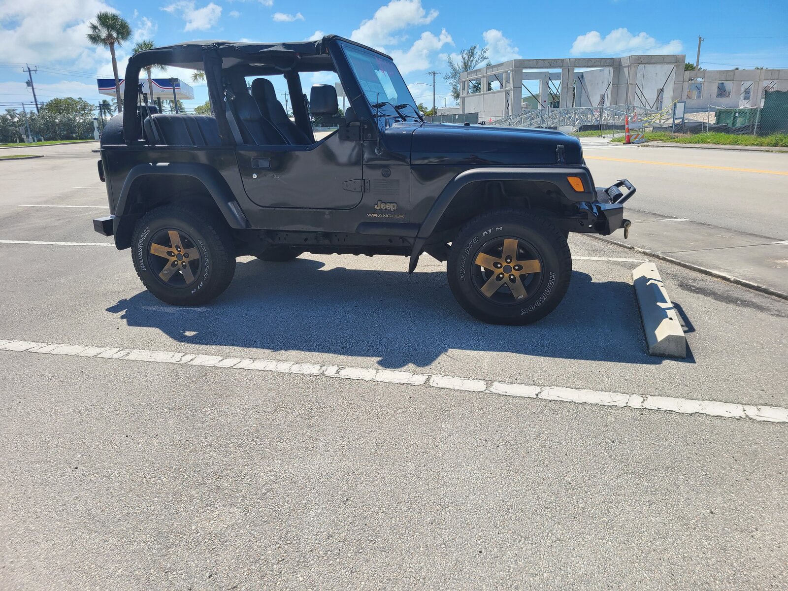

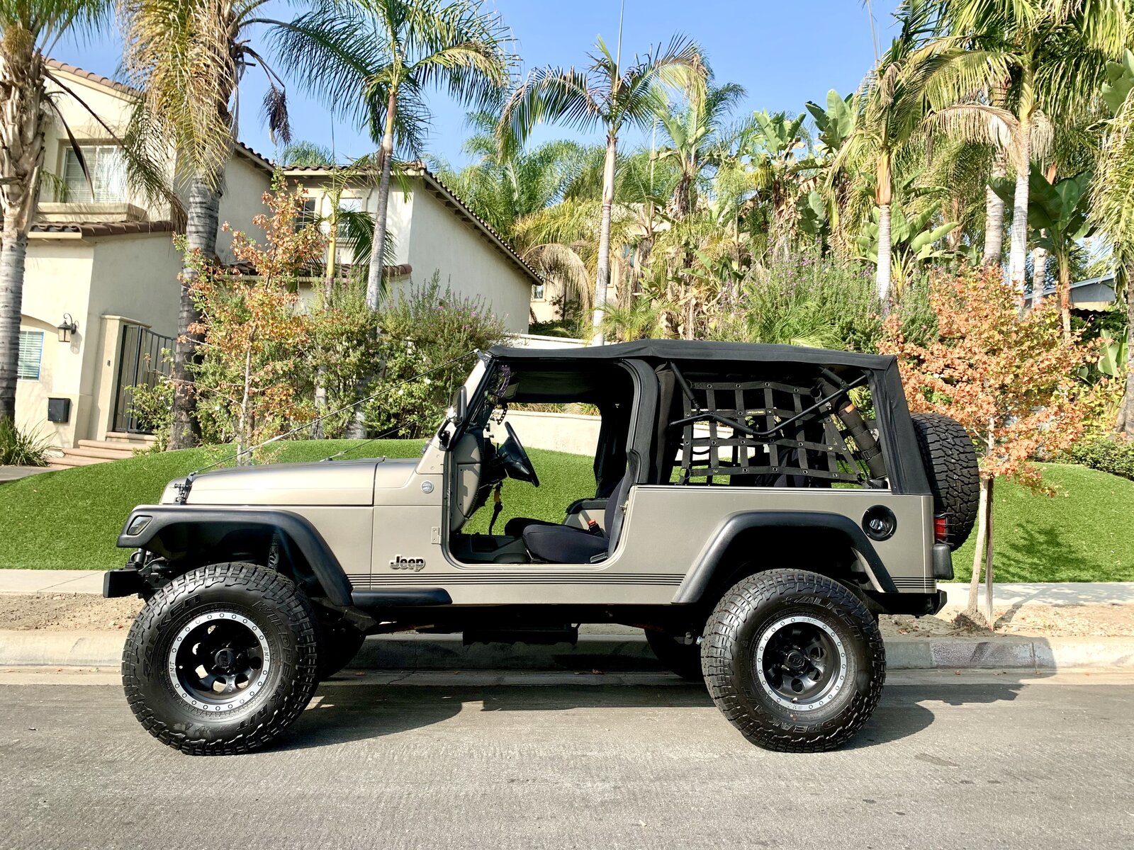

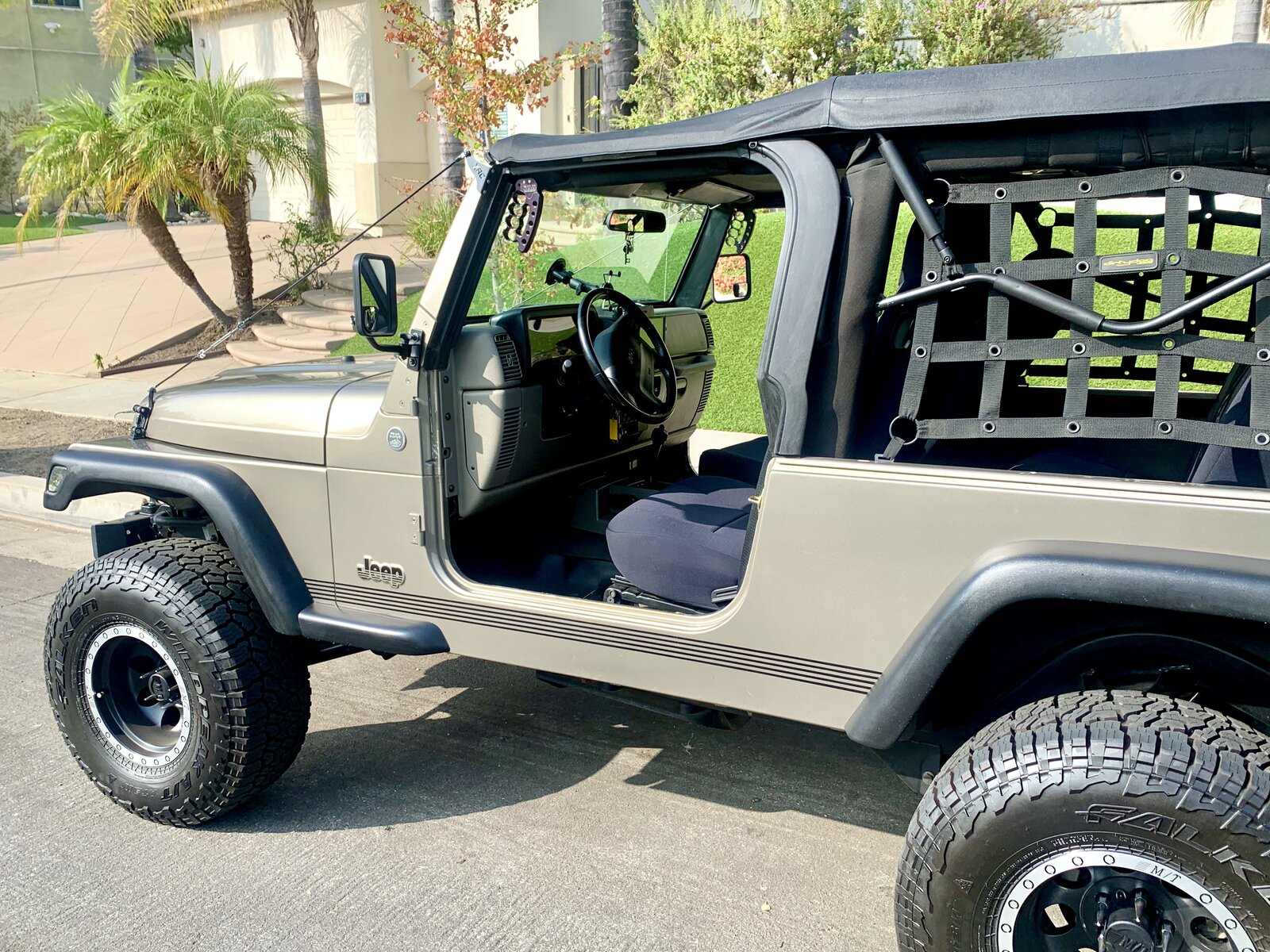

I bought it today!
FINALLY my first jeep. After years of drooling over my friends Jeeps and life getting in the way this one basically fell right in front of me! I have been on the lookout for a good deal and one in good shape for a while, let one go due to a decent amount of rust out in Cali a few years ago but then came across this 2004 Sport Se with just over 104k miles and honestly didn't think it would work out but I just picked up the keys and its officially all mine!! (Drove it home in the rain in true jeep fashion)

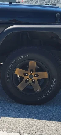

I would love to see a close up picture of ypur wheels. Do you know what was done to them?

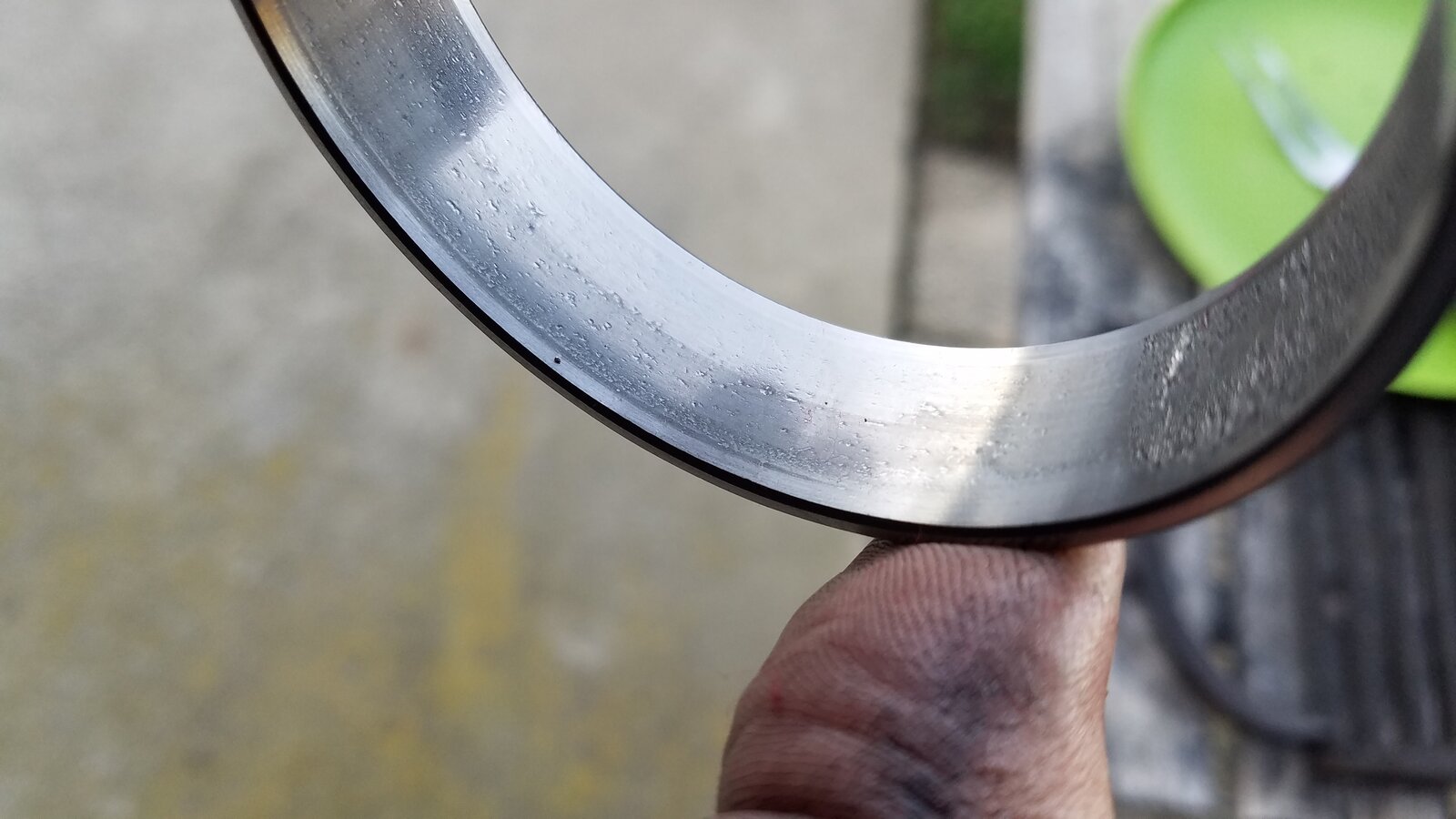

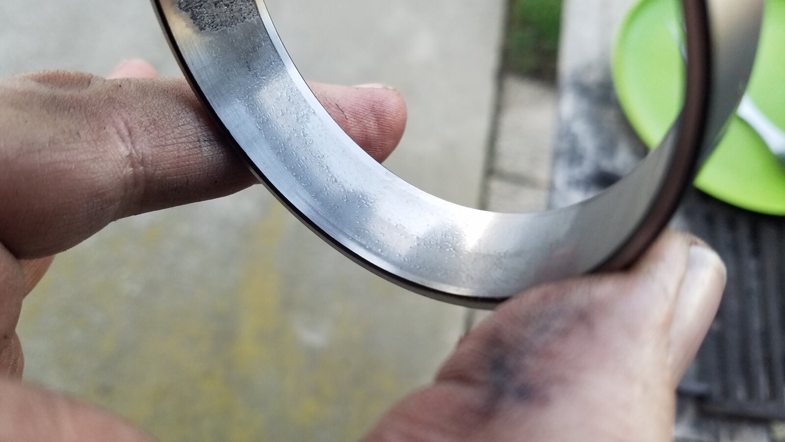

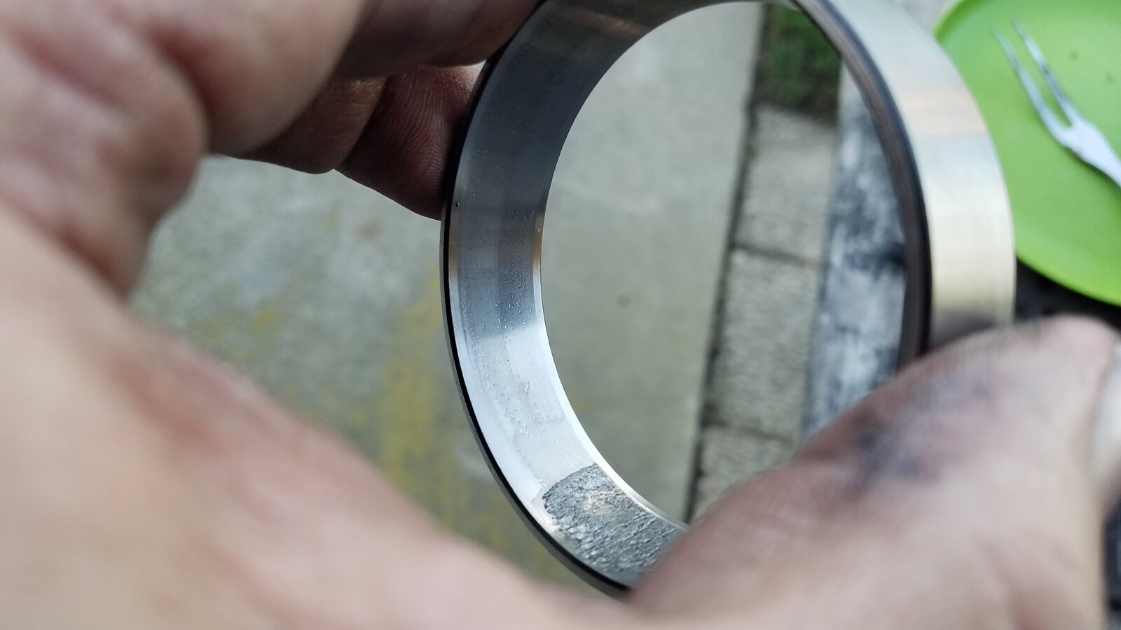

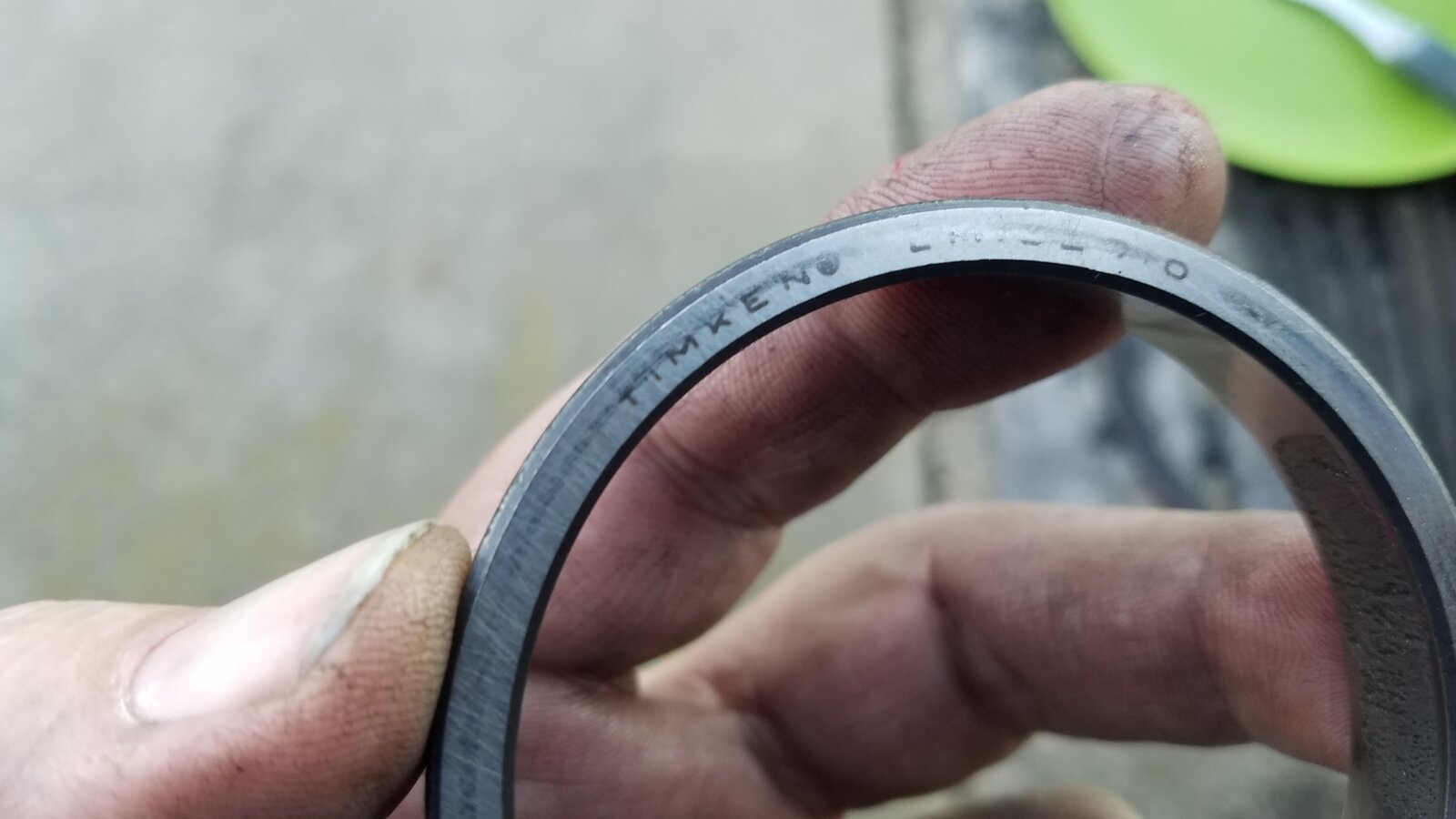

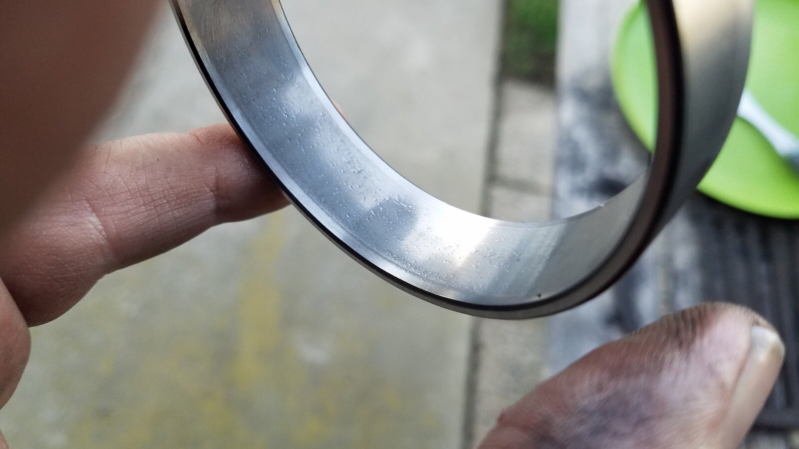

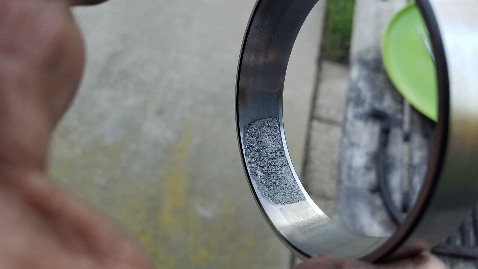

pulled the ARB from LP Dana 30 so I can take it to have it installed in the new housing. I was on the fence as to doing a gear swap from 4.56 to 4.88, well good thing I decided to do it. I found one of the bearing races in bad shape. It is a Timken at that. The surface just broke down. I only have about 10k miles on it. I say possible disaster averted.
.View attachment 197744View attachment 197745
.View attachment 197742View attachment 197743
I have seen similar issues on XJ Dana 30's when there was water present in the gear lube and it was run for awhile.
What did the drained gear lube look like ?

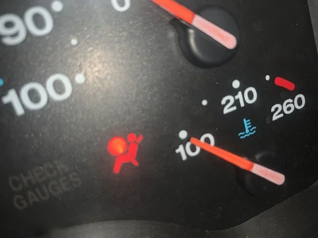

Several days ago the SRS Airbag light illuminated on the instrument cluster.

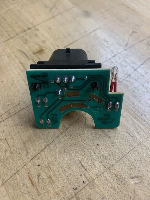

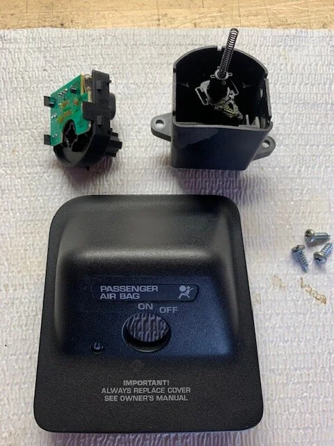

Tested the (3) fuses 5, 9 & 10 for the Air Bag Control Module and all were good, checked the steering column ribbon cable and the other functions controlled by the ribbon cable (Cruise Control) worked. I checked the key operated Passenger AIr Bag ON/OFF bypass switch and found the indicator bulb was OFF when it is usually ON. Tested the circuit board and found there was 12V to the bulb terminals, but no continuity for the bulb element.
Ordered a bag of 7219 (12V .07 W) wheat bulbs from Amazon which will arrive tomorrow.
Apparently the vehicle PCM is smart enough to determine there is a problem in the SRS Air Bag circuit which includes a burned out indicator bulb.
UPDATE: Soldered in new bulb onto the circuit board and the SRS Air Bag light on the instrument cluster is extinguished and the bulb in the Passenger side bypass is illuminated.
