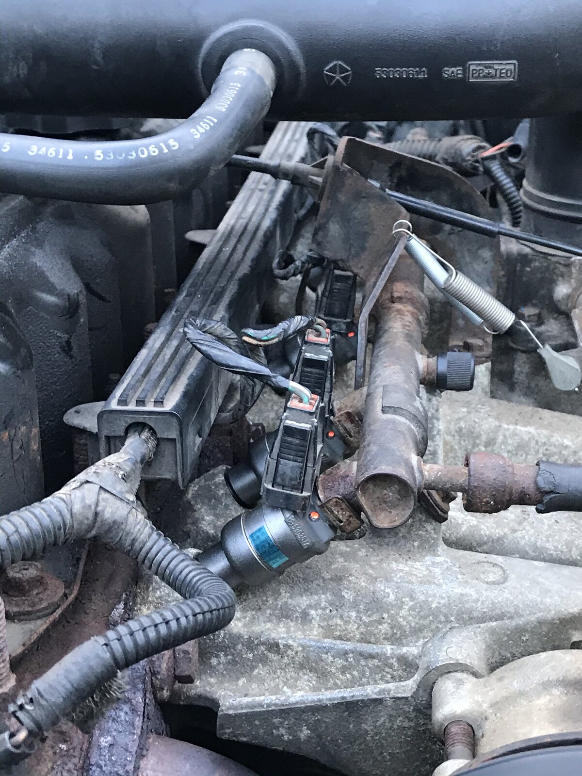

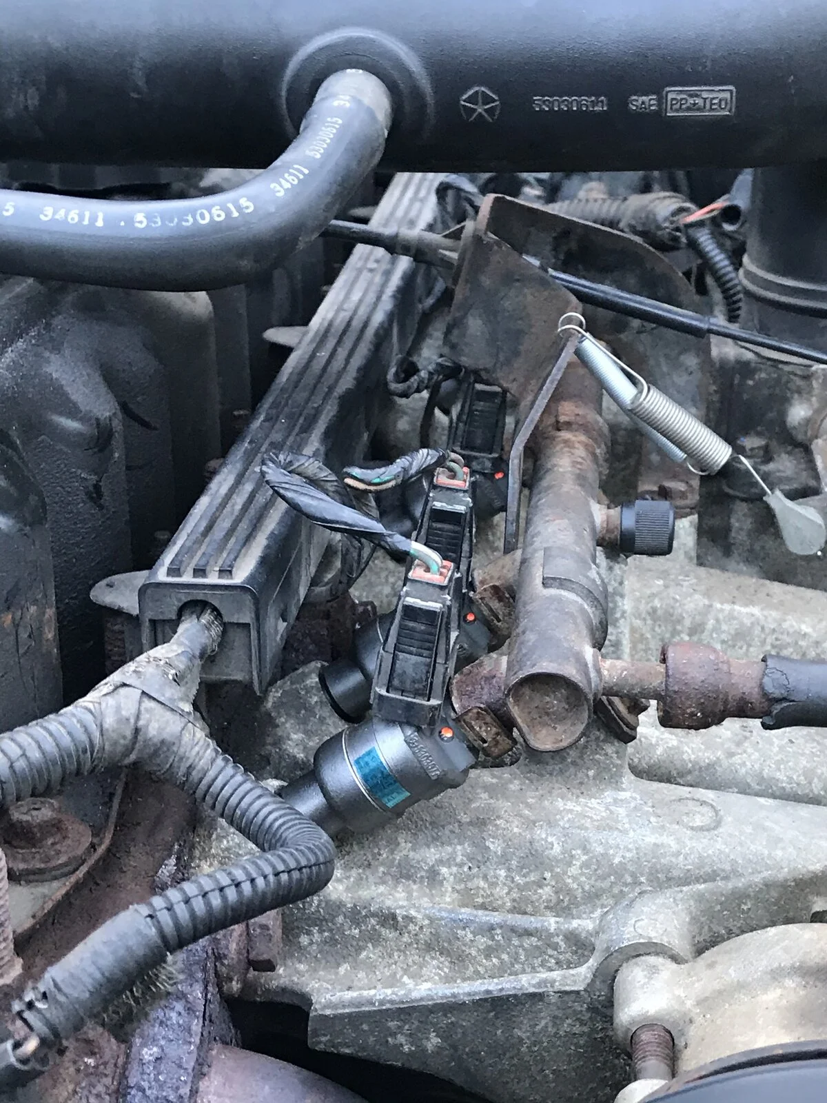

Finally got the rebuilt / “matched” stock injectors to replace the original ones. The hardest thing was cleaning the old 226k mile crud in the bores and pulling the injectors out. Went with stock Deka ones for simplicity.
It seems to sound better and pull better. We shall see.
Edit: Yes, that is the stock motor from the factory in the jeep. 226k miles(give or take a few from the PO not adding the right speedometer gear, mileage may be less)
I know I'm pretty late on replying to this post but... It looks like you are missing the heat shield and the heat suppression on injector #3. This can cause heat soak issues (do a search for "heat soak" for more info).
Here's the shield (check around for best price+shipping to your address).https://www.googleadservices.com/pa...sLjFwdvsAhVCi1kKHbzjCIsQ9aACegUIDBDGAQ&adurl=
There are also complete kits with the shield and heat wraps for the rail and all injectors like this.https://www.googleadservices.com/pa...jRsLjFwdvsAhVCi1kKHbzjCIsQ9aACegQIDBBI&adurl=
I'd go for the kit if you can. Also, I applied some high-temp RTV to the edges of the heat shield where the fiberglass core is exposed to seal it all in...a bit messy to do but I'm pretty sure my shield will hold up waaaay better than the one it replaced.

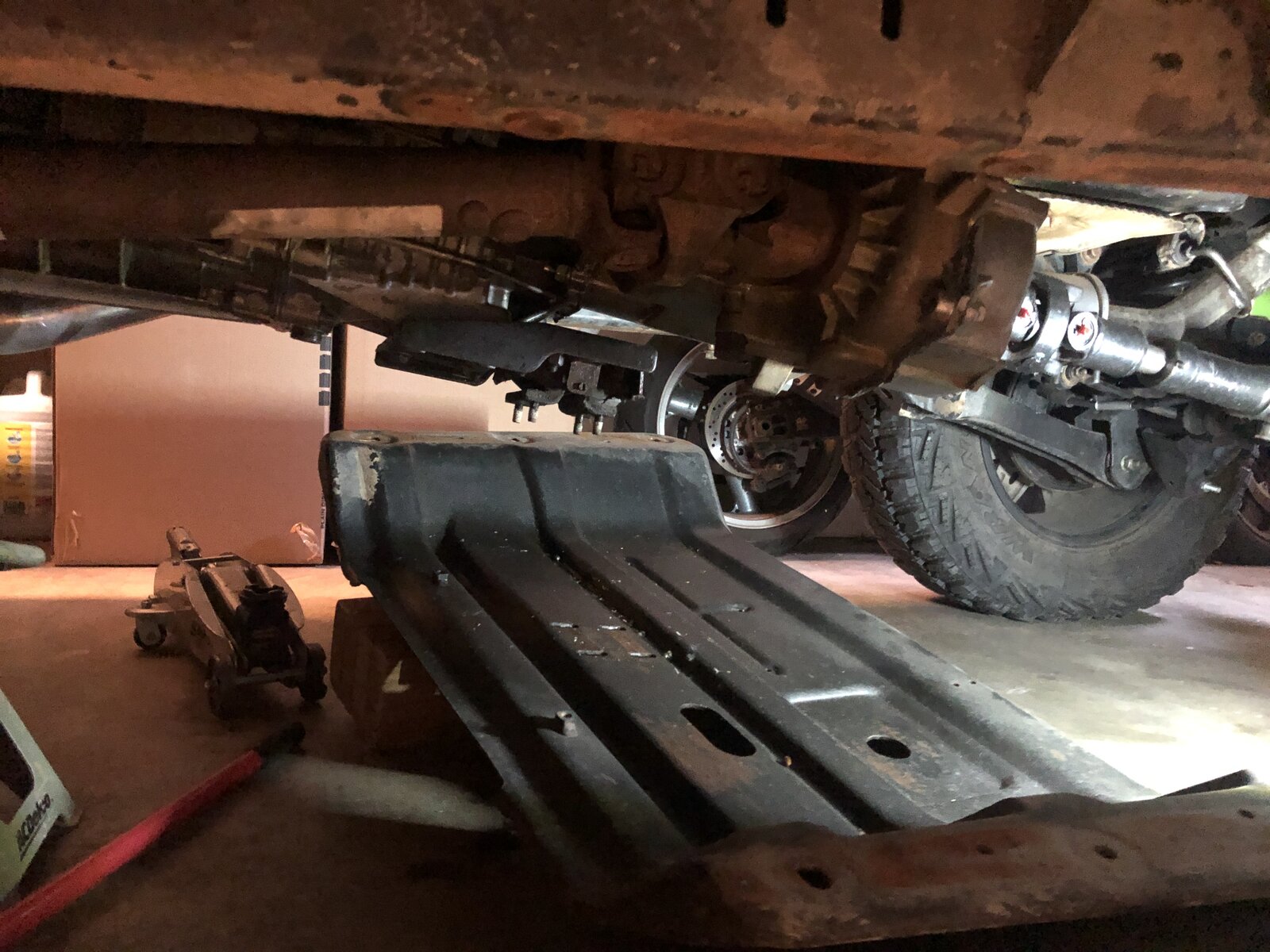

NDSpeed, my friend, you need to put a jack stand or something under your tranny or transfer case before dropping the tranny skid plate/mount. Letting it hang like that can damage/tear your motor mounts and cause other damage like the radiator fan pushing up and breaking the fan shroud or its mounts.
Do check your motor mounts for visible signs of cracking/tearing.
