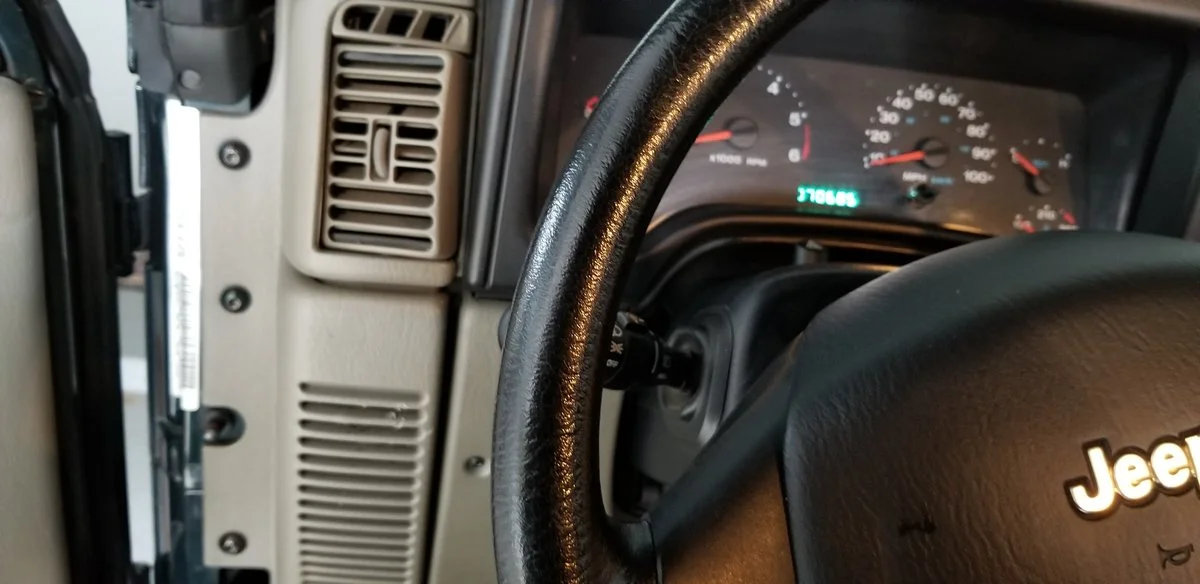

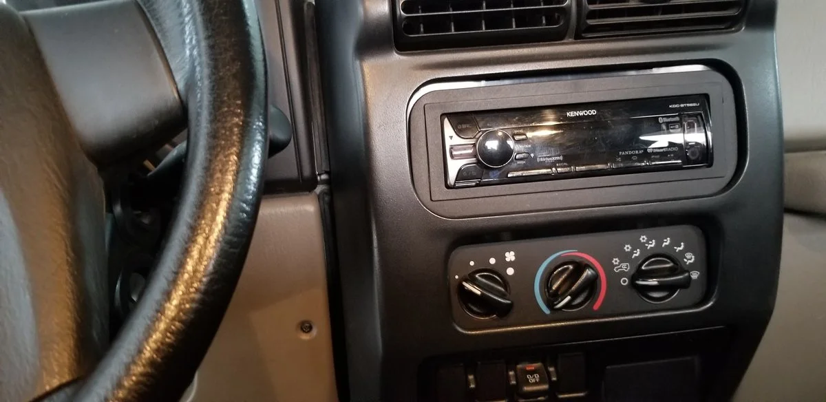

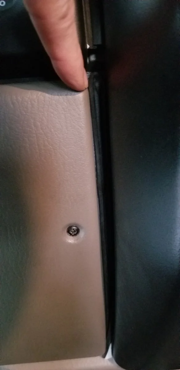

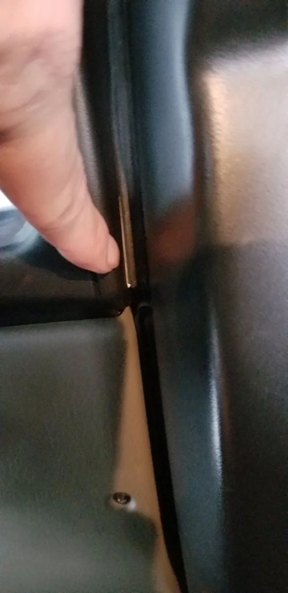

Got tired of putting up with the incessant squeaking dash. All the screws that attach the panels are present and they're nice and snug, but the dash squeaks constantly. I tried lubricating all points of contact, and that stopped the noise for a day or two, but it came right back.
It seems like the panels just need to be a bit tighter because if even a tiny bit of pressure is applied to the dash while driving, the squeaks disappear.
Last weekend I grabbed some auto and marine weatherstrip, cut a couple pieces to size, and wedged two widths of the stuff between the dash panels on either side of the instrument cluster.
One week and a couple hundred miles later and no squeaks yet. Best $3.88 I've spent in a long time!

Where the plastic part of the dash goes over the metal and it screwed down on either side of the VIN....the screws were tightigh
but the plastic flexes at a different rate than the metal... I really believe if you look there you'll see something.
remove the trim piece along the windshield carefully and grab the cluster module and just rock it front back a little bit and you'll hear it going crazy.
I took some soundproofing material and put it between the plastic and metal and screwed it back down and that fixed it... But today I'm getting some screws that are just a little bit bigger and I'm going to take it apart this evening and put those in and add some screws closer to the windshield on either side of the VIN tag.

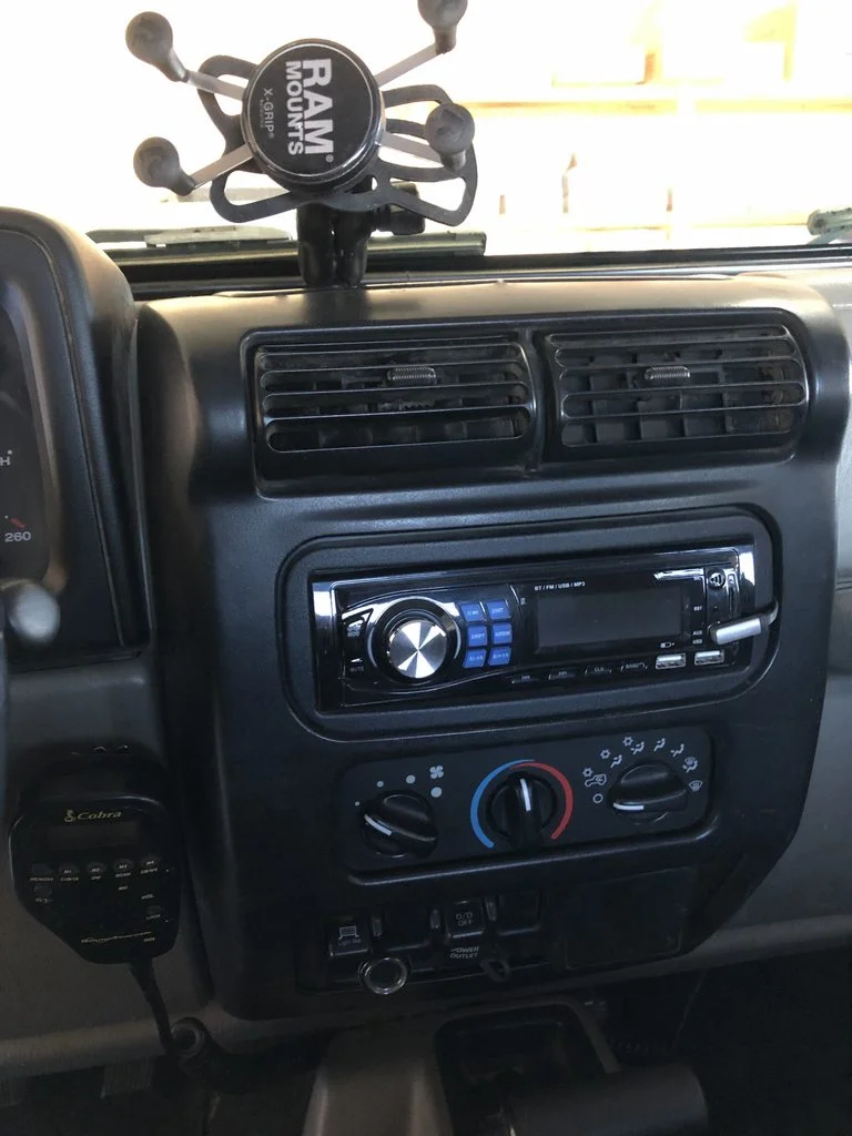

Earlier this past week I removed my dash mounted CB and swapped in a Cobra 75 that I had laying around. But it definitely needed a better speaker is I was going to hear it on the trail. I ordered a flat double male AUX cable with 90* ends. Connected one to the Cobra interface box under the dash and ran the other to the AUX input on my head unit. So now when I am using the CB (never at same time as radio) I simply switch to AUX on the head unit and the CB is now through all the Sound system. Plenty of volume. The change also freed up the space on the dash to install a Ram mount for my phone which runs Gaia on the trail. Seems to be the ideal setup for me.
