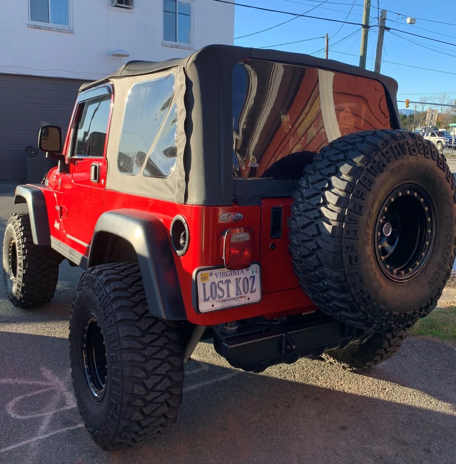

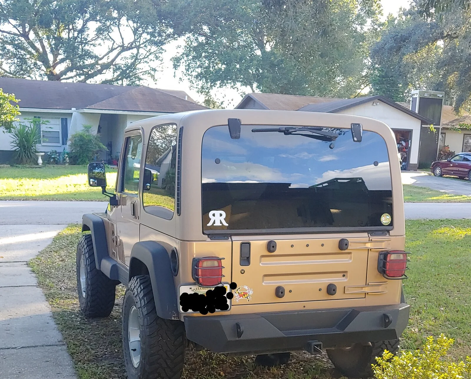

I was one of "those guys" that drove around with a 31" spare on the back riding on 33". (Purchased it that way) The spare hits the bumper when closing the gate and was flexing the gate. Need to replace the fairly new Barricade bumper, buy the right size spare, and mount spare to bumper, not gate. Don't have that much to spend right now so off with the spare. Kind of like the look but will have a spare on there soon.
It's hard to make a larger spare fit on the stock carrier with the backspacing on stock wheels. My 35" spare fits perfect with my aftermarket wheels. I had to have a BL to clear.

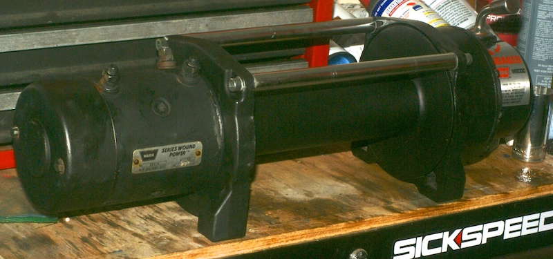

The winch is back together sans its control box, which I'm going to tear into a bit before remounting it.

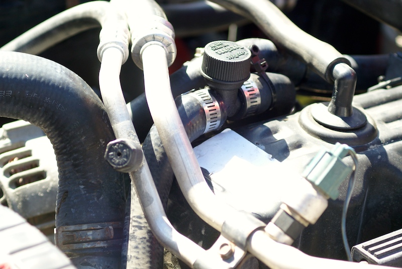

In other news, a couple of weeks ago I installed a heater core bypass hose - yesterday was the first time I drove it, and checking the coolant level today shows no loss whatsoever. I want to drive it a bit more before I declare victory (I'm not a Democrat), but I'm cautiously optimistic that the heater core is indeed the cause of my slow coolant loss.
I've been meaning to ask you, which bypass hose did you get? Did it fir the two different sized heater hoses well?
I might get one to throw in my tool box as a quick fix on the road if the core starts leaking.

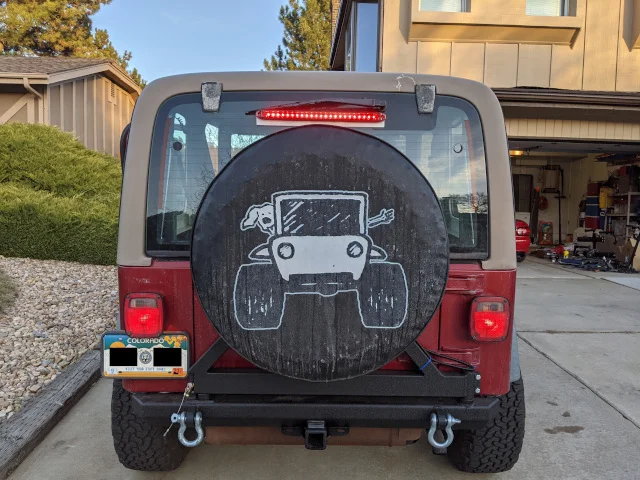

Also DIY'ed a replacement center brake light. Used a section of 1.5" wide, 1/8" thick angle aluminum and a cheap LED light bar I found on Amazon. I bought two, so I positioned the first one so I could install a second if I wanted to. I'll paint the aluminum black eventually. Blue zip-ties, didn't have black. I'll swap them out at some point.
Love the tire cover! :D
I am currently one of those guys. :( But, the spare holds air, so....🤪
