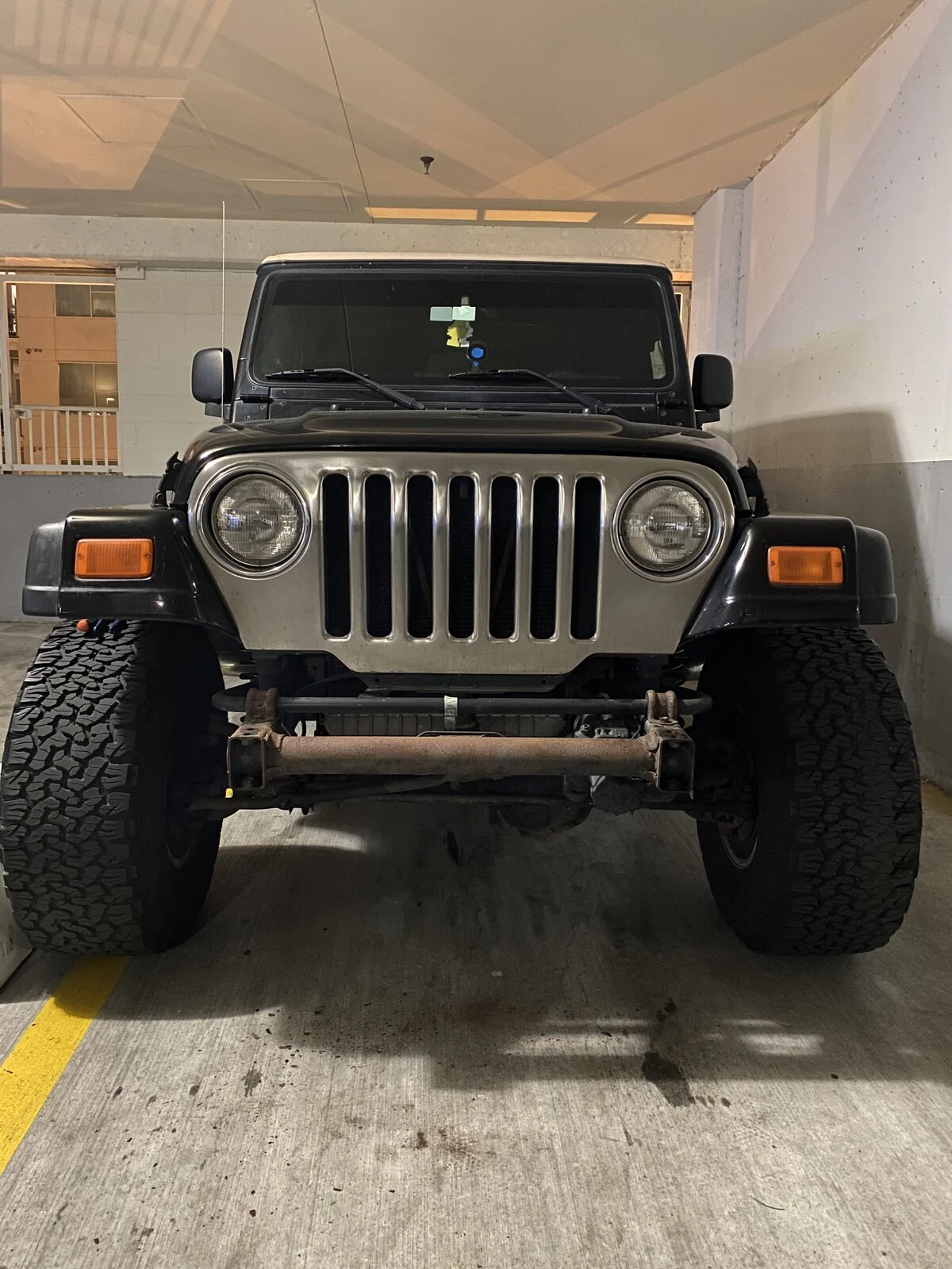

I was checking my tire pressure last night after my "oh sh**" moment and found they were all overinflated by 6 to 10psi, so that could have added to my loss of stability yesterday. But I also noticed my front is sitting much lower than my rear. Maybe that's not helping my traction and loose feeling steering as well🤷‍♂️
So I'm thinking I need new springs and or shocks now. The PO installed a Skyjacker lift and I think they are starting to show their age . Anyone have recommendations for a 2.5" lift kit or combination of parts?
Jeeps normally sit 1.5" higher in the rear with no added weight. I always lift the front of my Jeeps 3/4-1" higher because I never ride anyone in back...............or nobody wants to ride with me.:unsure: I ran 28 psi when I had 32s. I like BDS or Pro Comp springs and Rancho RS5000X shocks.
