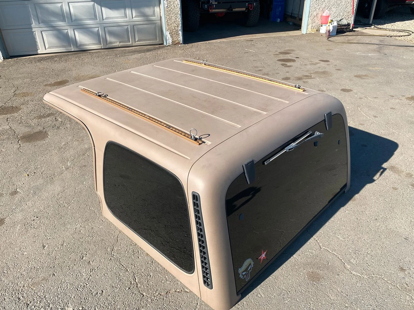

Im not to worried about my soft top. Its a nos oem sailcloth.

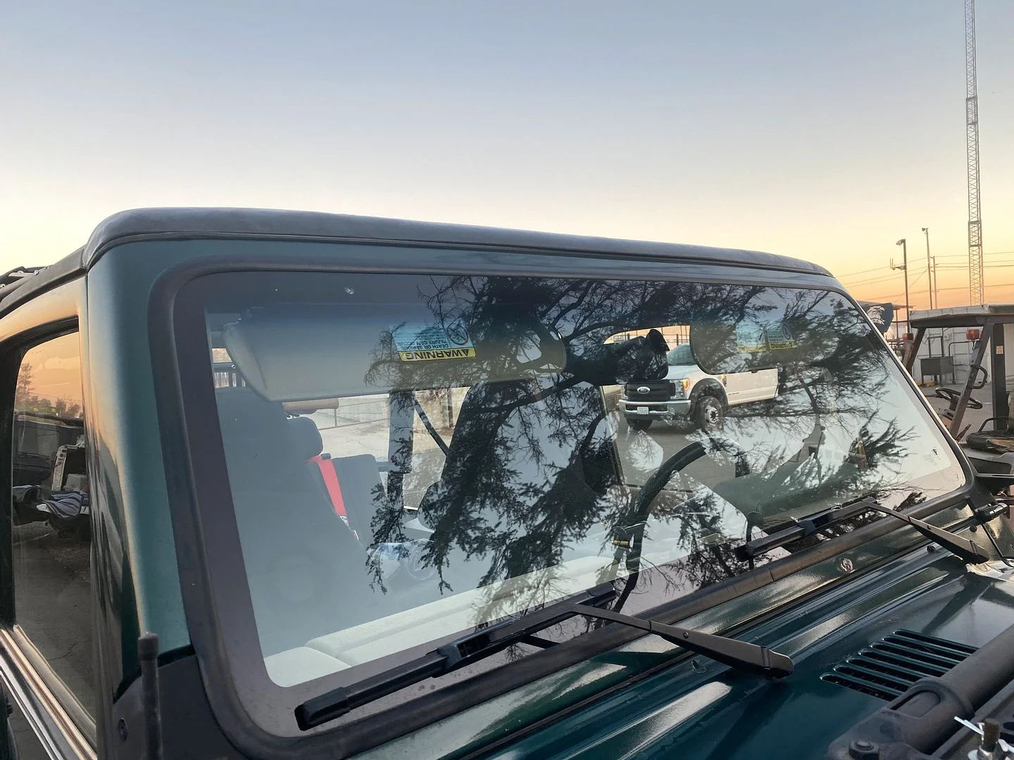

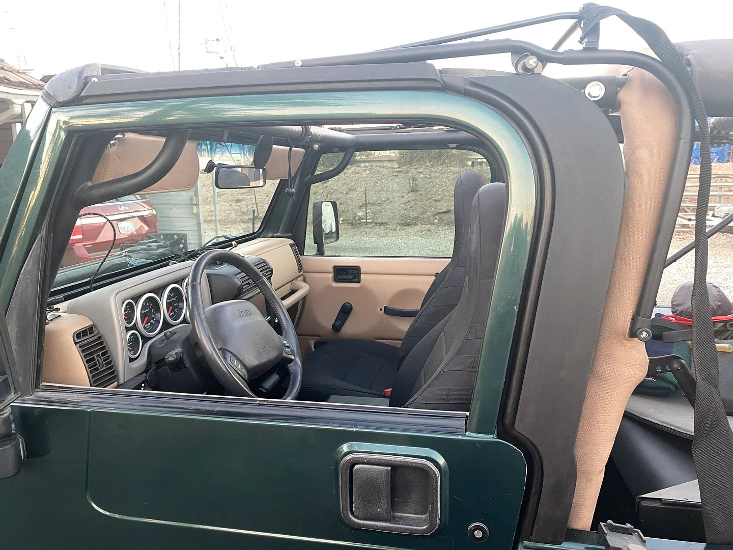

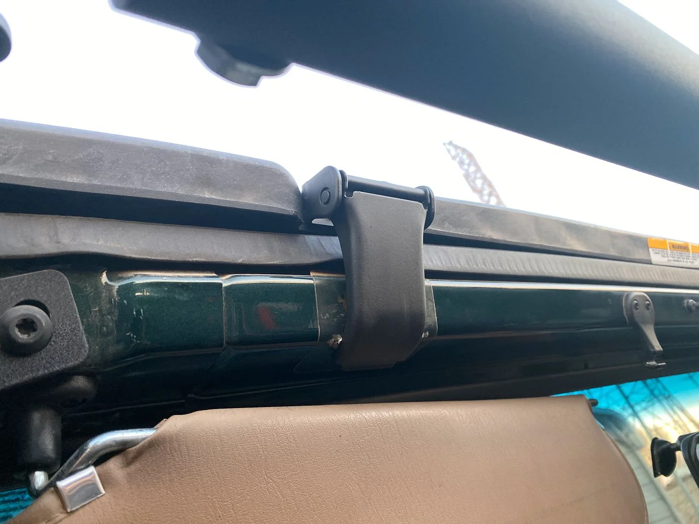

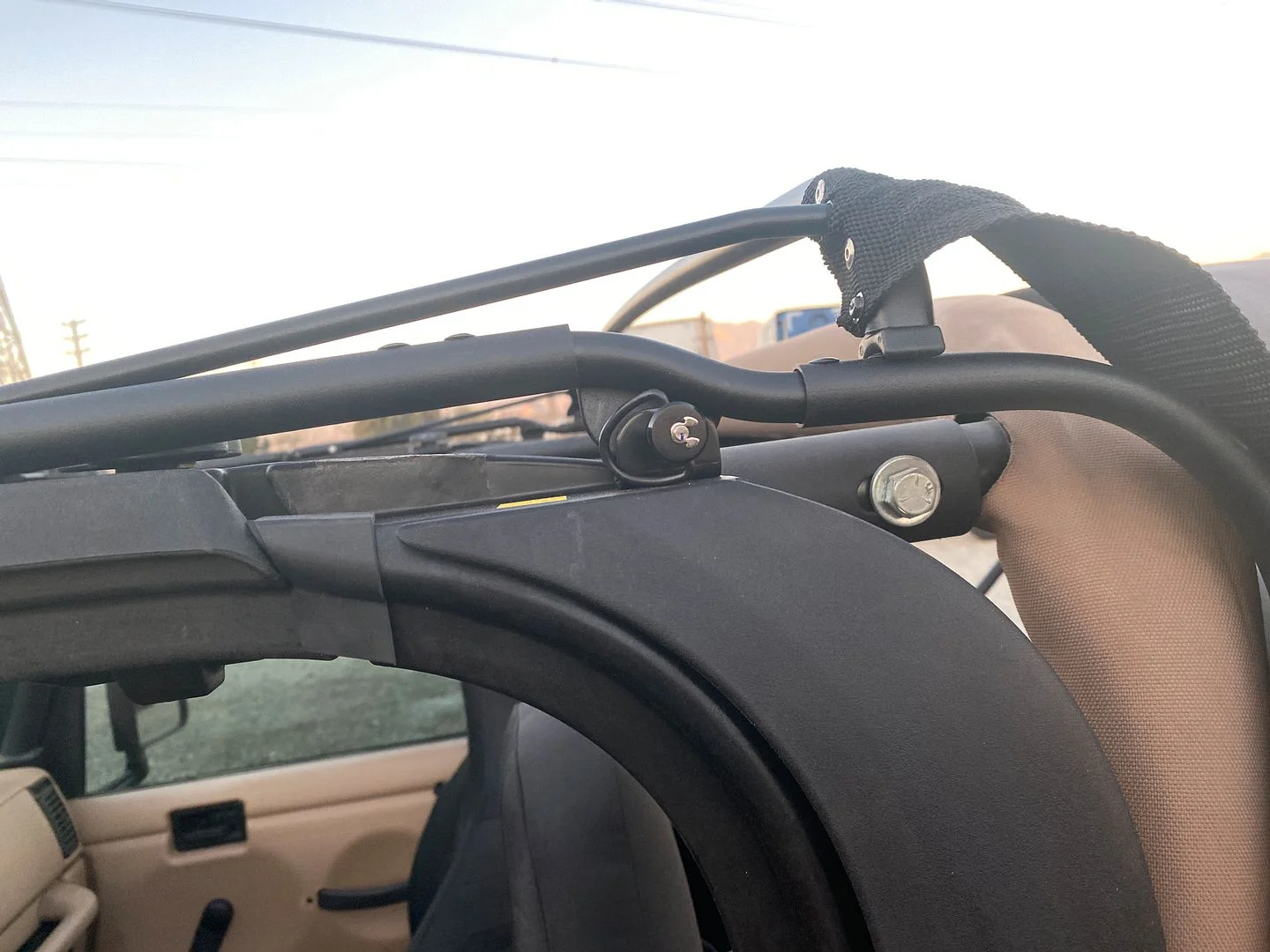

Also, fixed the passenger side door seal on my bulldawg upper tonight, I did the drivers side last week and it made a WORLD of difference. Now I just need the windshield header seal.

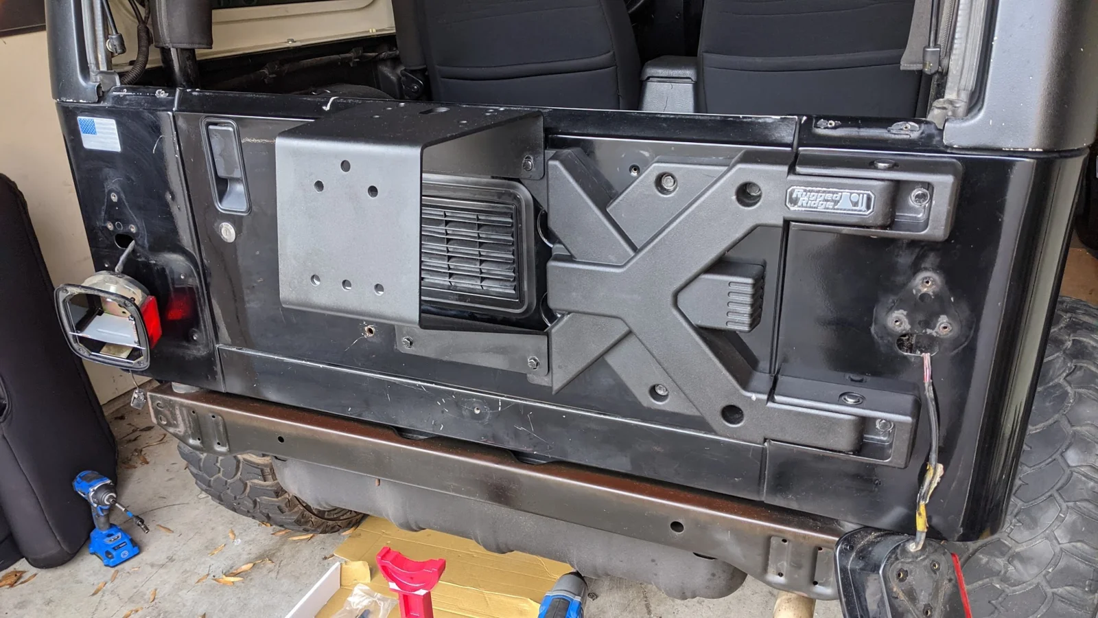

This was all from last weekend. Took off the Smittybuilt tire carrier because I was sick of how noisy it was, got this RR hinge set. I kept ping ponging back and forth on deciding between different rear tire carriers and I just couldn't pull the trigger on a $1k+ investment that may still be noisy. So I went with this... Hope I don't regret it.

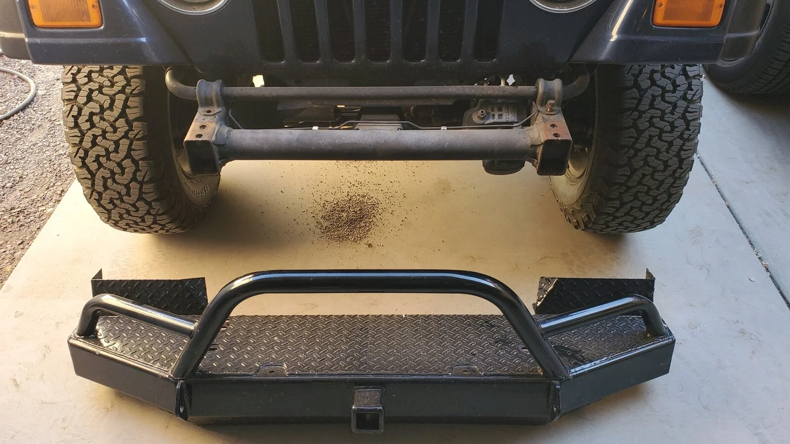

Now I need to figure out what bumper to run. Was eyeballing the Savvy.

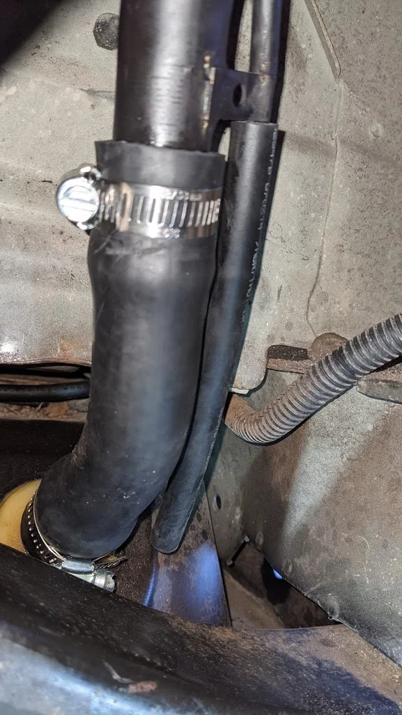

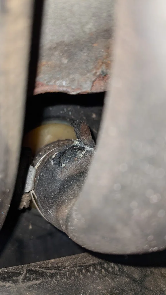

Had a gas leak problem when I fill the tank and the 'large leak, small leak' codes on the computer. Found the culprit (yikes). Replaced the hose.

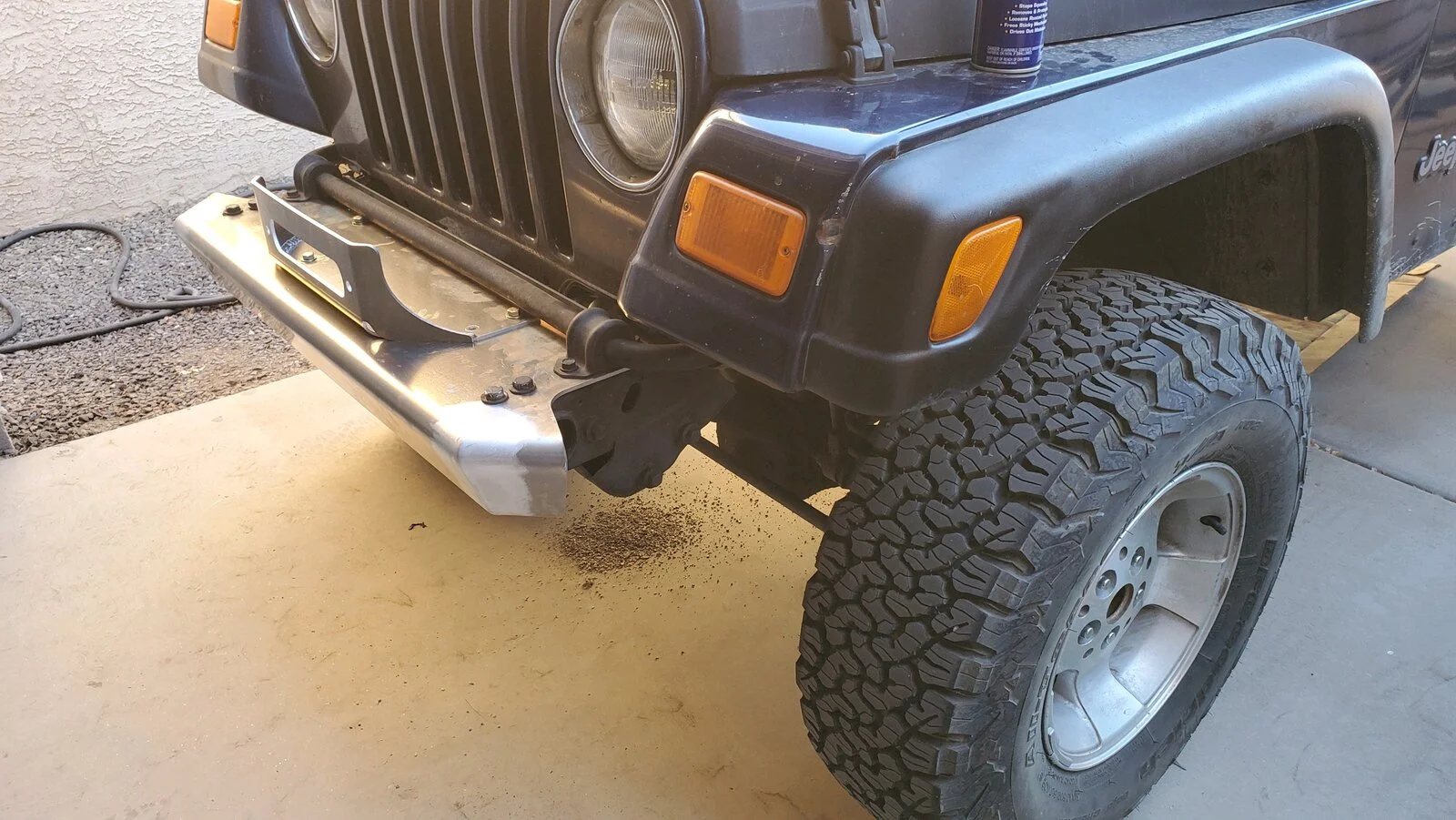

I'm at a crossroads... I really don't want to put my factory fender flares back on. Not only were they a pita to take off, but they're pretty beat and hideous. I really like the look of the Genright aluminum flares, but do you need the corner armor in order to install them? I don't think I've ever seen a Jeep with those flares without the corner armor as well. I wasn't really expecting to spend money on flares at this point but I think I'd rather run no flares than reinstall those factory ones.
Yes, you can run the Genright rear flares without body armor. They bolt on and require drilling holes in the body. The downside is that if you take a good hit on the flare, the flare does not give but the body will.
