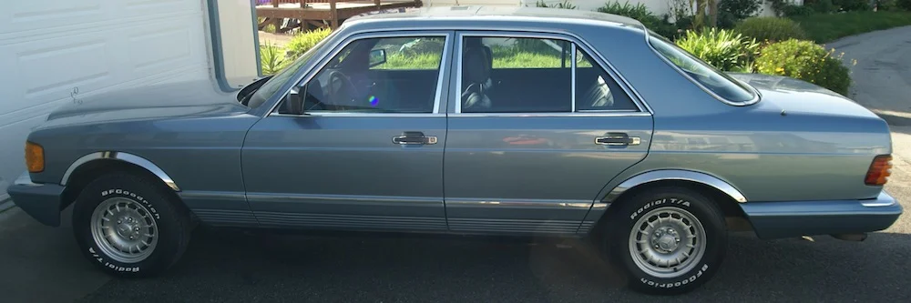

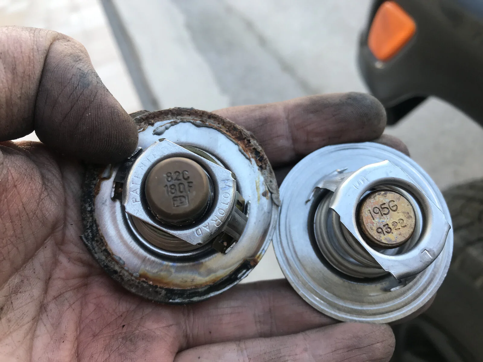

4 years ago, I had a rebuilt engine put in the old Mercedes. Unfortunately, the otherwise reputable engine rebuilder did an "old trick" and drilled the thermostat. Doesn't make any difference in the summertime, but in the winter the engine never gets up to full temp. Gonna replace the t-stat at next coolant change.
Reactions: H_Nunez
I really like the Mercedes vehicles. Would get one I I could afford it. Which one you got?
Fixed the drivers seat back release cable. Did the passenger a few weeks ago and the metal part had snapped. I was hoping for same issue today, but of course not. The plastic piece that holds each cable in place had bent, allowing the entire cable to shift up and the seat won’t release. A few zip ties later the seat works, start placing bets on how long that holds!
That is a beauty! I have had three Mercedes and loved them all. Latest is a 2013 C250 with the Sport Package. Fun to drive but I feel like I am sitting in a sardine can. It is the wife's car. Previous ones were E320s.
This is the third one I've been involved with, and the 2nd that I personally have owned. I learned to drive on my parent's '71 220D, then owned a '74 240D that had bad cancer. Then I got this one - and you know me - it has ENTIRELY too much luxury crap on it. I liked MBZ when they were a basic, but very well engineered car. My dream would be a W108 (such as the 280 SEL) with the 300SD engine in it - I *loved* the W108 body style, last of the high grille cars.

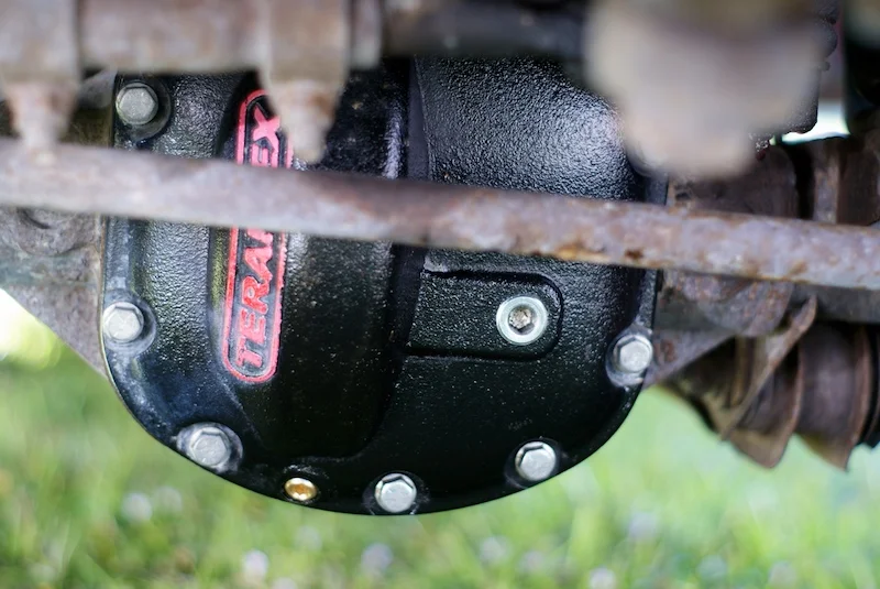

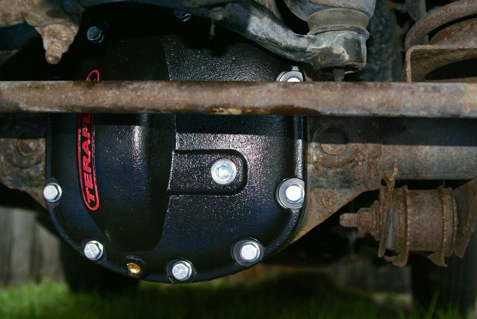

Went from:
... when I first put it on, to:

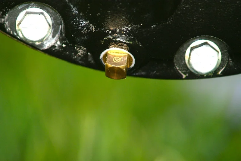

When I couldn't get the original to stop seeping, to:
This one just today. Seems to be slightly larger diameter as it fits tighter than the identical looking original and won't get knocked off!
I'm not too thrilled with Teraflex's paint job in this thing either, I should have sprayed another couple of coats on it before installation.
