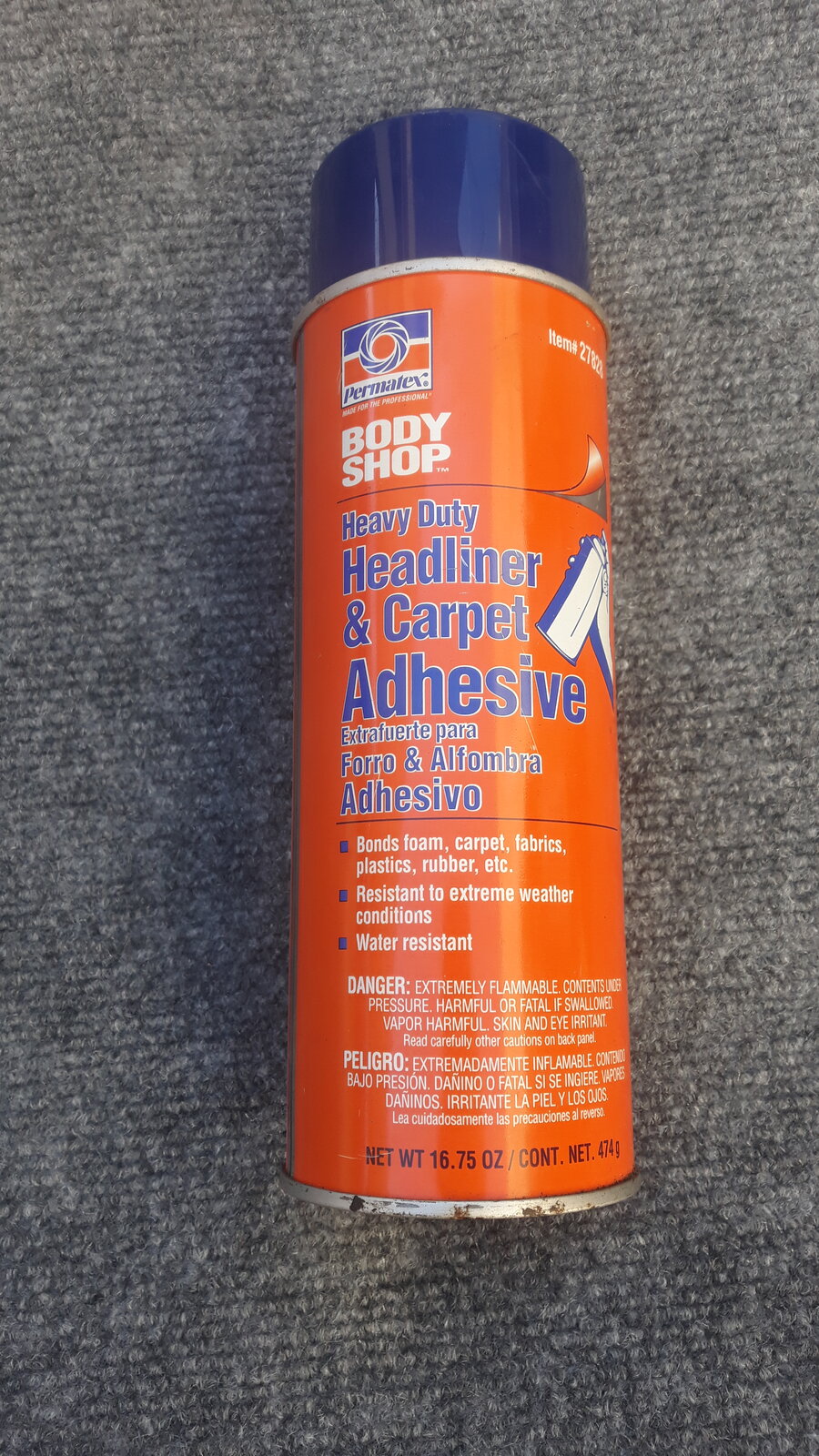

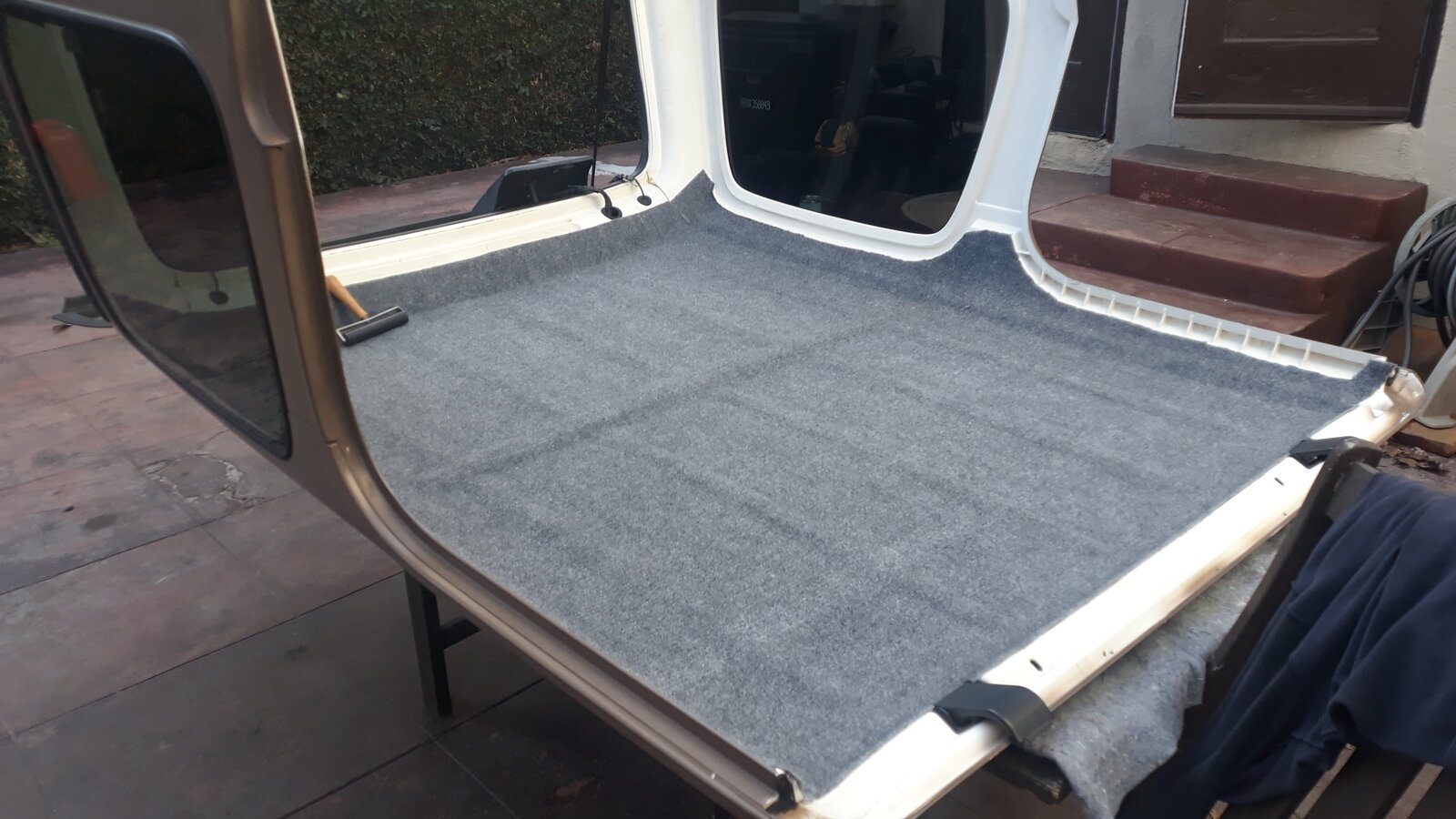

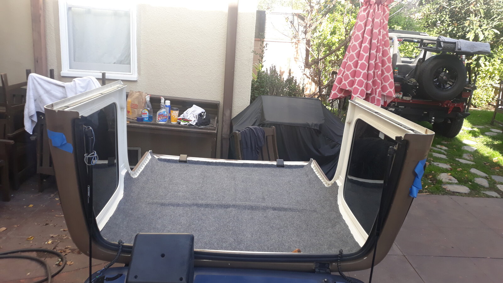

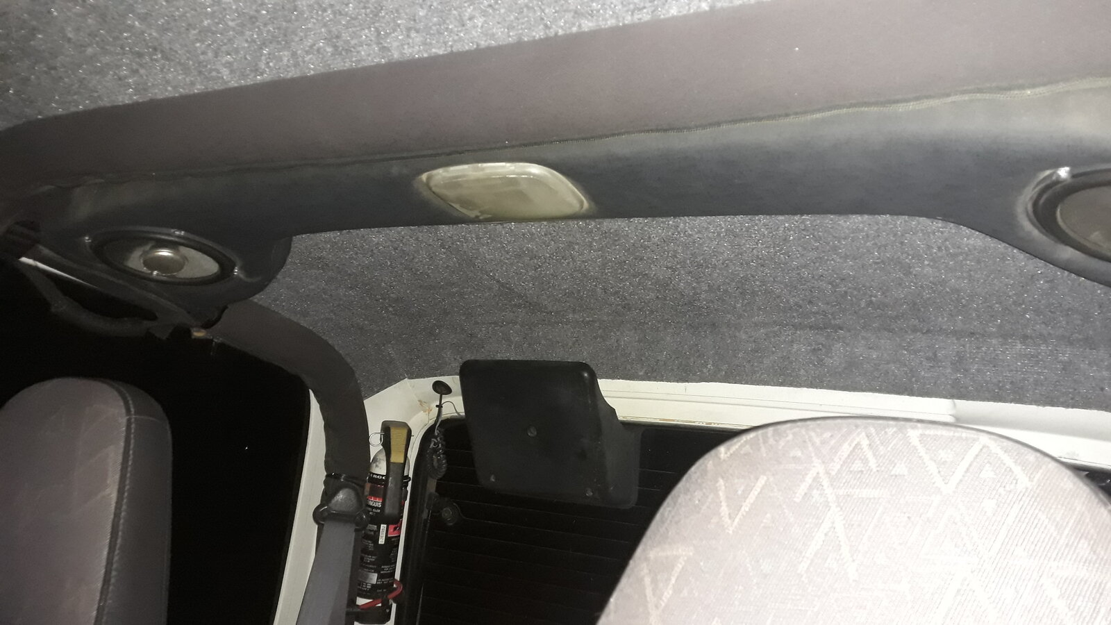

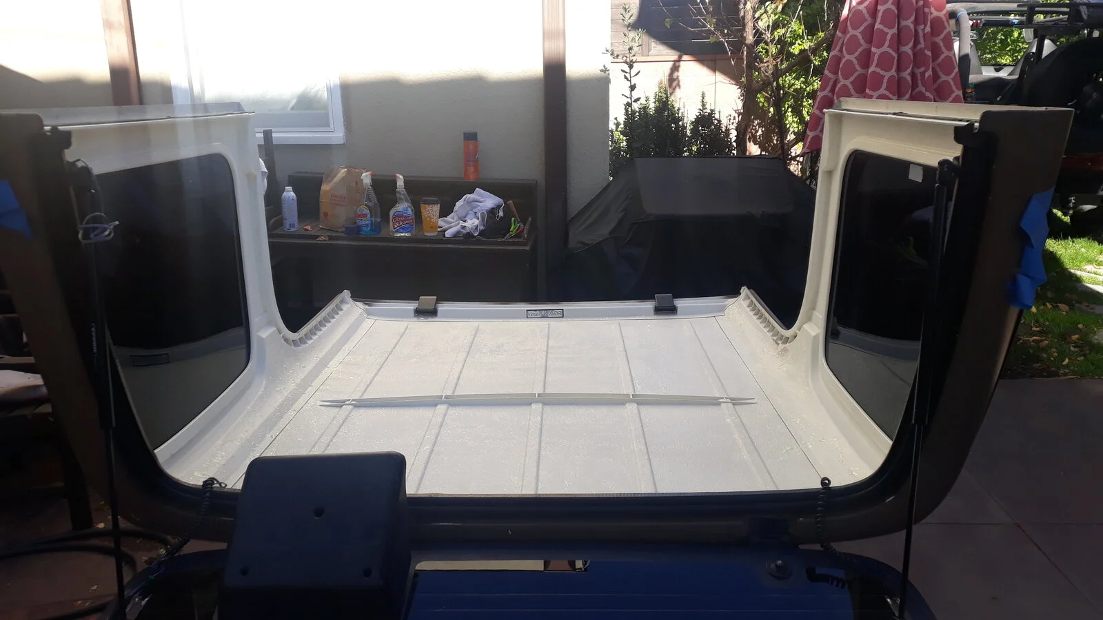

Anyone hate how loud either softtop or hardtop sounds on your Jeep? I ran a fabric liner on my hardtop and its sounds a lot quieter. This mod took 2x can of headliner glue and 1x 6x8 floor mat. Total cost of $50.
Well worth the time and money mod.

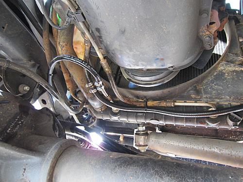

I mounted mine inline on my 2005. I tied into the OEM transmission line on the drivers side. I carefully cut the metal crimped ferrules off of the drivers side line, and removed the OEM rubber hose. I reused the metal line that goes into the transmission connector and ran new hose from the inlet and outlet of the second cooler.
Here's a picture somebody posted earlier, and how I ran my lines. The only difference is both of my rubber hoses are run out on the drivers side.
Does your hot ouput line from the trans go to the Oe/radiator or the external cooler first?

Inline, you need the radiator to warm up the trans fluid when it's cold also.
She is a trailer queen/non daily driver and resides in Kali. Would it be best to run output to radiator cooler then external cooler and back to trans? Long Island is a few degrees colder.

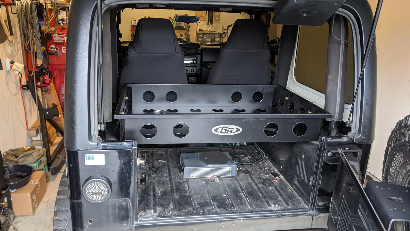

Finished installing the genright cargo tub. Install took a bit to figure out, no directions. It rattled/resonated a bit at first going down the road but that stopped after 5 or 10 miles. Still might get some rubber washers for the brackets jic.

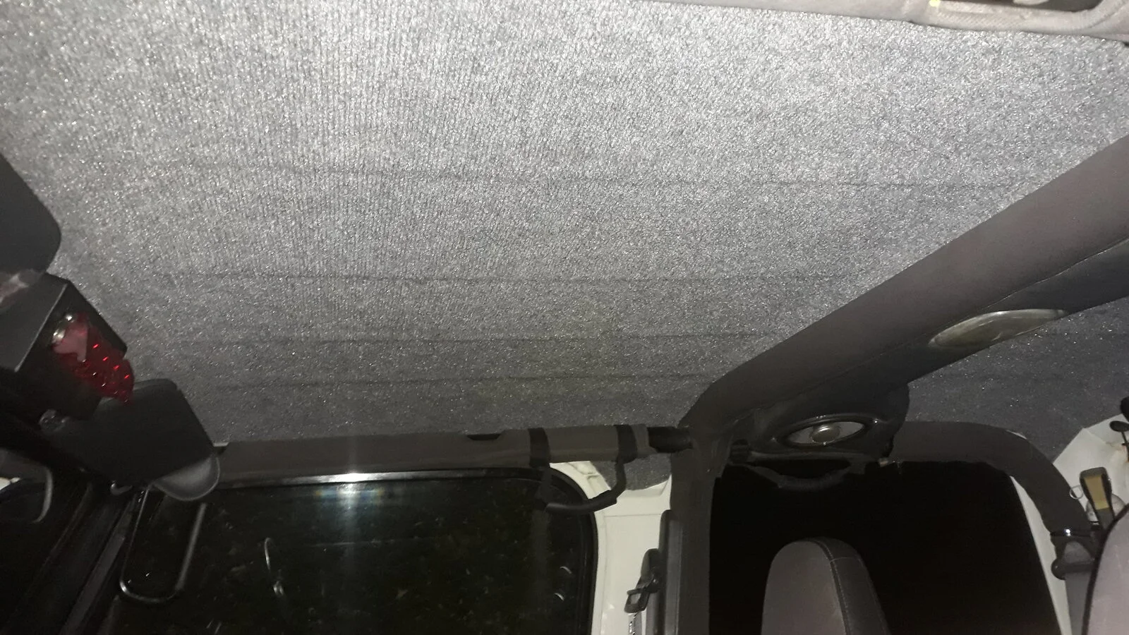

I run mine through the OE radiator cooler, then to my aftermarket cooler then back to transmission.
