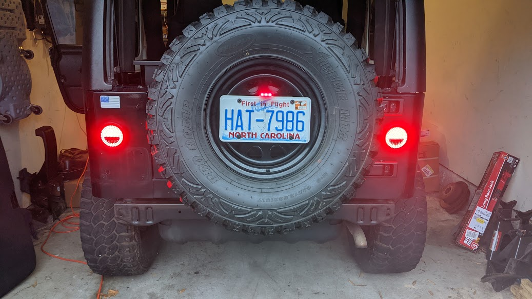

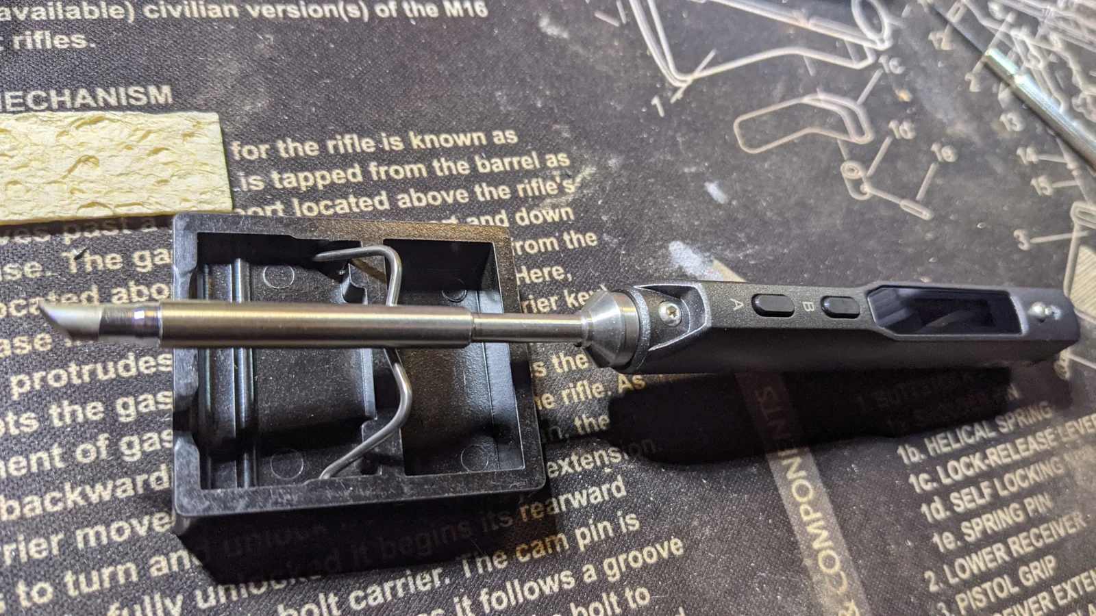

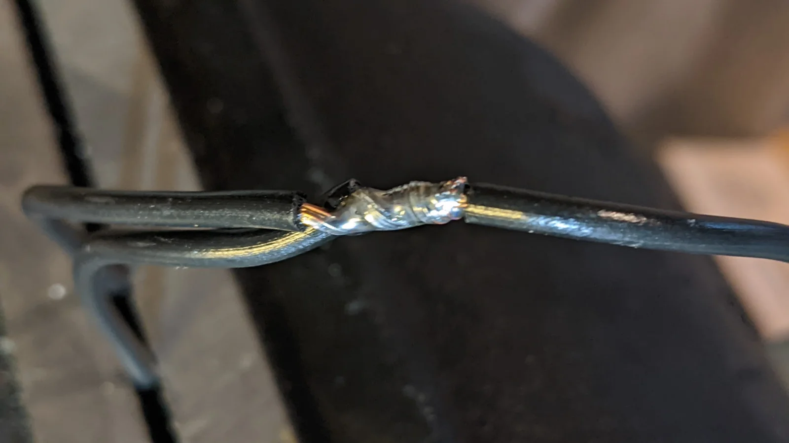

Did a sick job running the wiring for my third brake light through the tailgate. Also, learned how to solder and tried making a bunch of different joints and connections. I need to make a three-way joint to wire my license plate light into the running lights. Pretty proud of the results, I think I got the hang of it right away. Ran out to Autozone before they closed and grabbed some bullet connectors, gonna finish wiring up the brake light and license plate light tomorrow.
I used this soldering iron Santa bought me for Christmas. It's a TS-100 and it only costs about $70. It's the size of a pen and it goes from 0° to 400° in about 5 seconds.
In hindsight, I wish I had drilled a hole through the centerplate of the tire carrier so I could have ran the wiring hidden through the inside of the plate mount shaft and into the center of the carrier. In fact, I think I'll do that tomorrow. It bugs me that I sheathed the line in some black mesh sheathing but the 12" from the connector to the brake light itself is just gray tubing. Will give me a good excuse to use my new soldering iron.

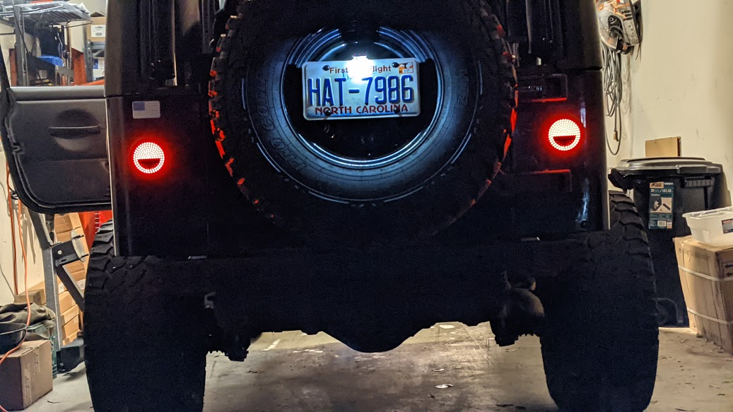

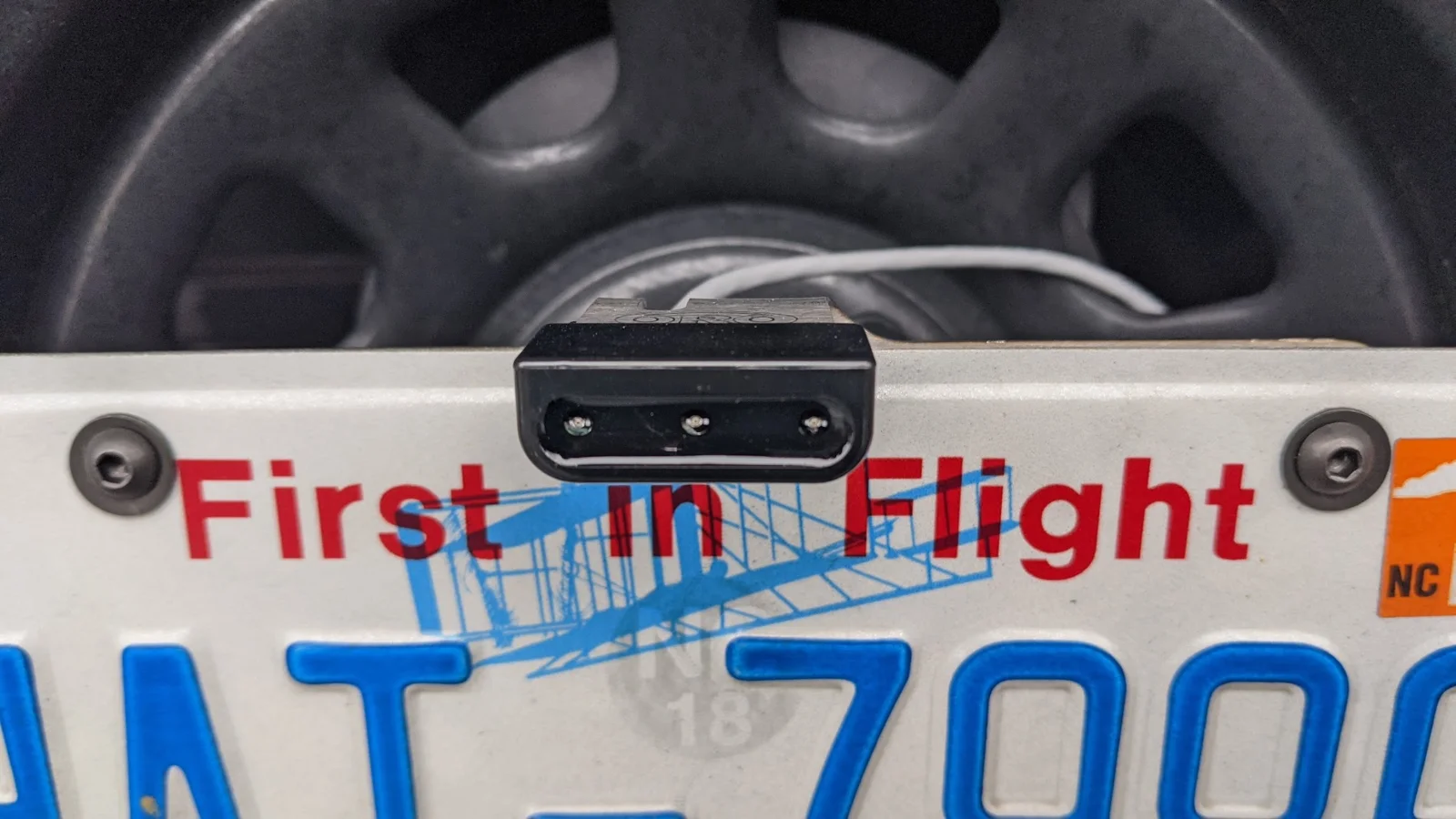

Finally finished wiring up the license plate light/3rd brake light. Wired the brake lights into the taillight harness I made so I didn't have to touch the factory wiring. Used a Deutsch connector so I can disconnect the plate light from the taillight in case I need to remove either.
brakes on, 3rd brake light working (this was before I wired up the license plate light)
Running lights on, License plate light working. It's not as bright as it looks in this photo.
One step closer to being legal, lol.
