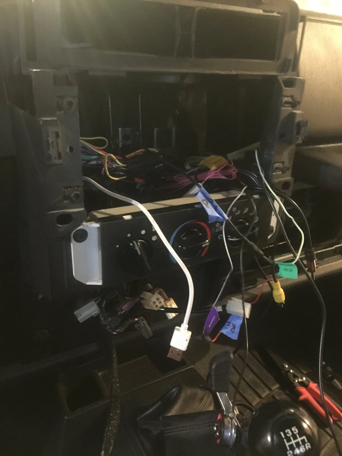

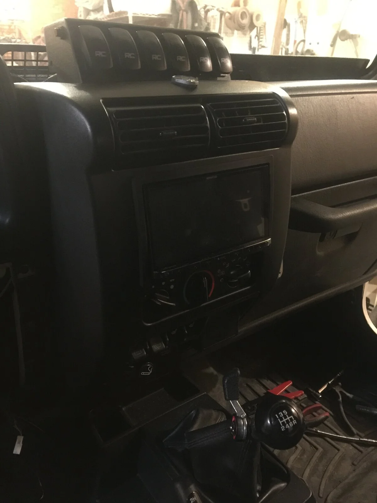

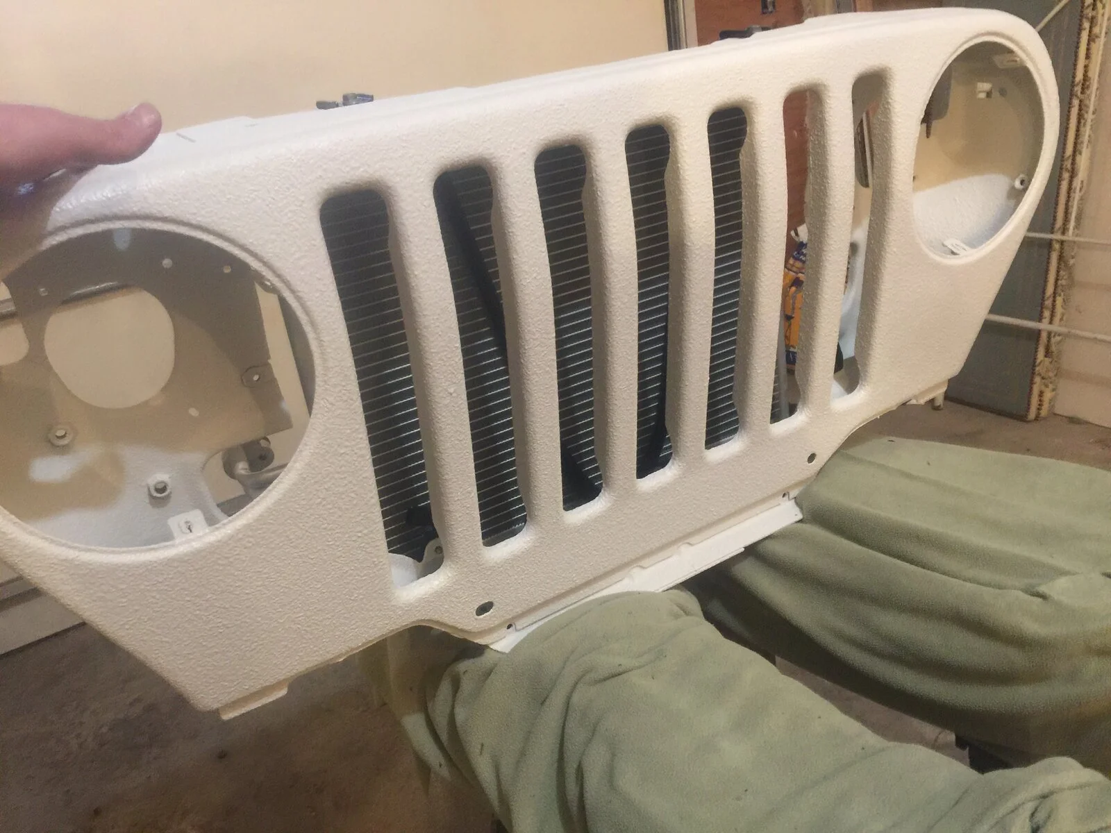

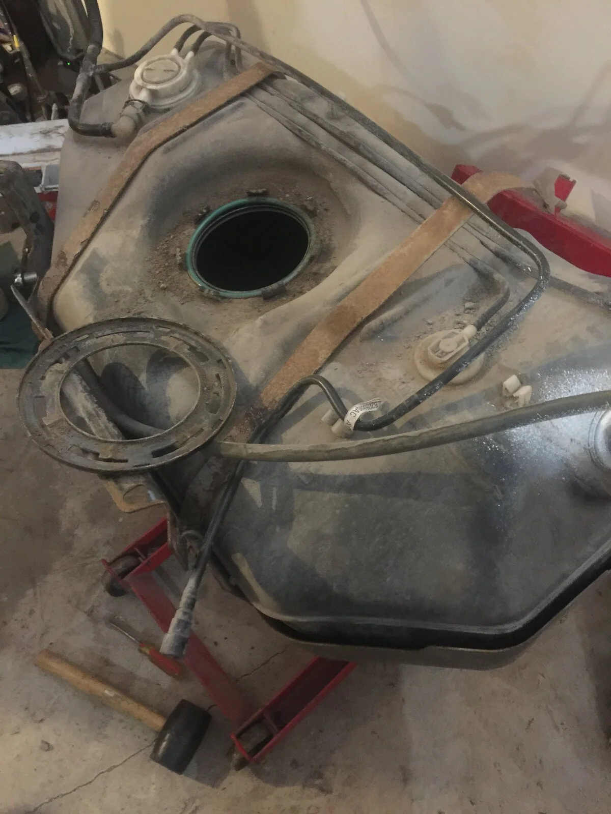

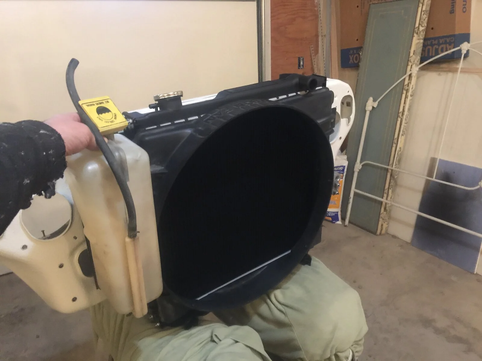

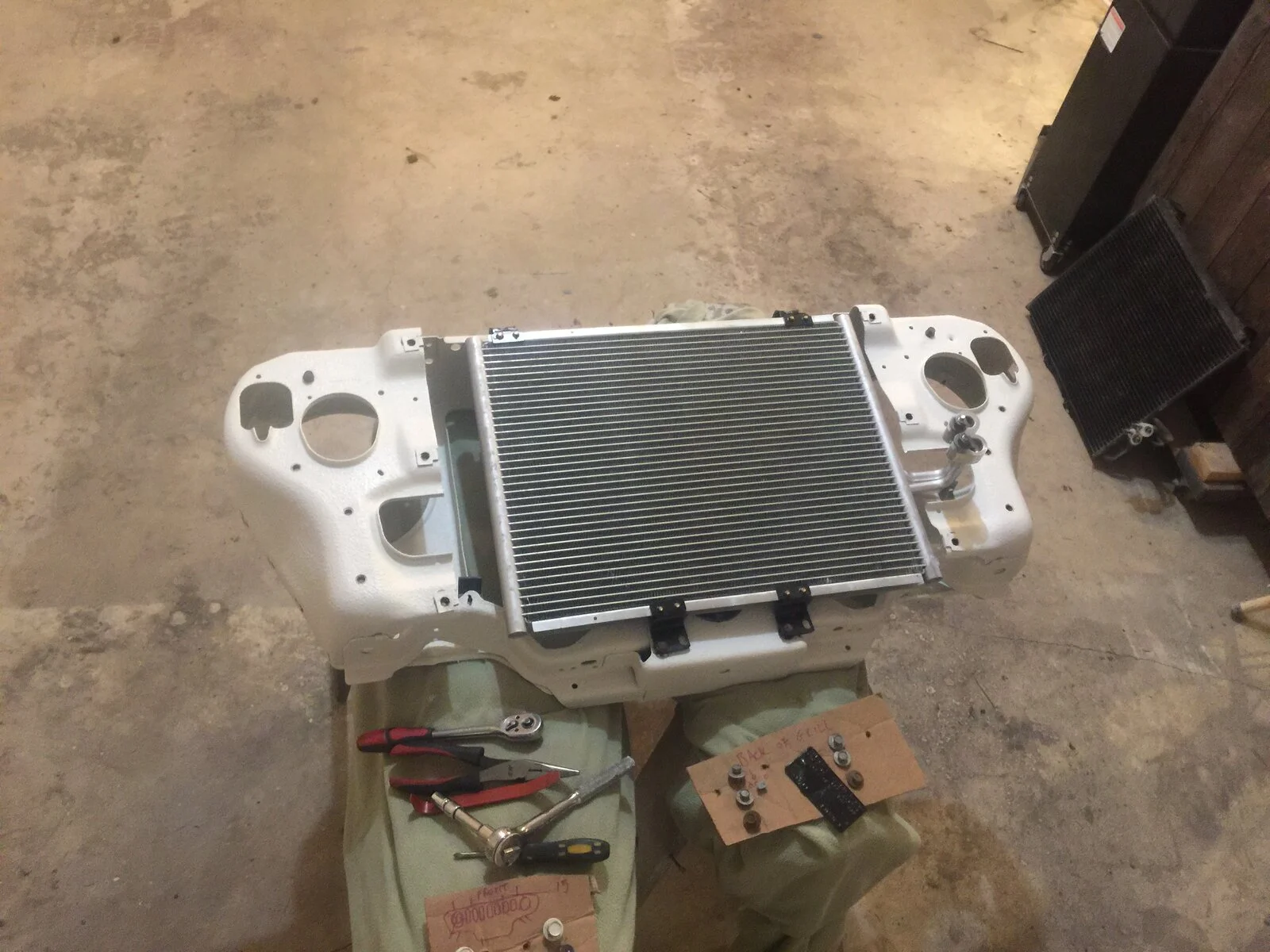

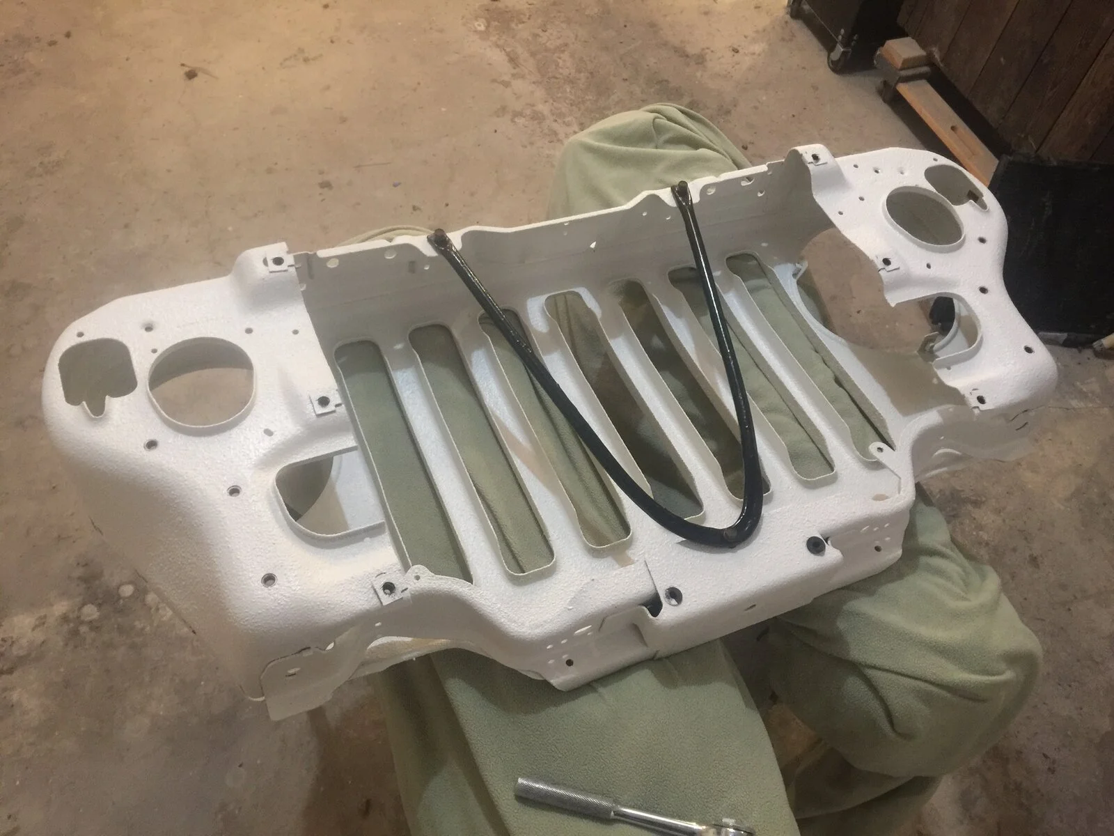

I didn't have time to post last weekend as we had friends over for the holidays. I have been a busy beaver though. I pulled my gas tank and fixed the overflow issue some of the 05's had. I will be sealing and painting the underbody while its out, probably in 2 weekends. I jumped back to the interior to get that all buttoned up. All the wires are run proper like for the S sens for the GPS to function correctly. I added a front cam and a rear view cam. I'm running a kenwood ddx8906s. I will also be doing the Idata pass through as I got a skim module to make hooking up the remote start a bit easier. I also tapped the ebrake line so that ground circuit will work. I ran the spare USB to the glove box as thats clean and will be just running a charger for my phone and for the apple car play functions, out from the dash. I also had to run the mic and heat shape the outer bezel to make it curve to the TJ dash. Looks pretty sharp now. Also now the hard top rewire and heated seats are completely hooked up and ready to roll. I am almost done hooking up the interior part of my ML6 controller. I also have my grille reassembled. New rad, Ac condensor and paint. Oh yeah and new headlight baseplates as a deer took mine out awhile back. Old AC condensor and Rad were fine just wanted to be safe while I was in this deep.

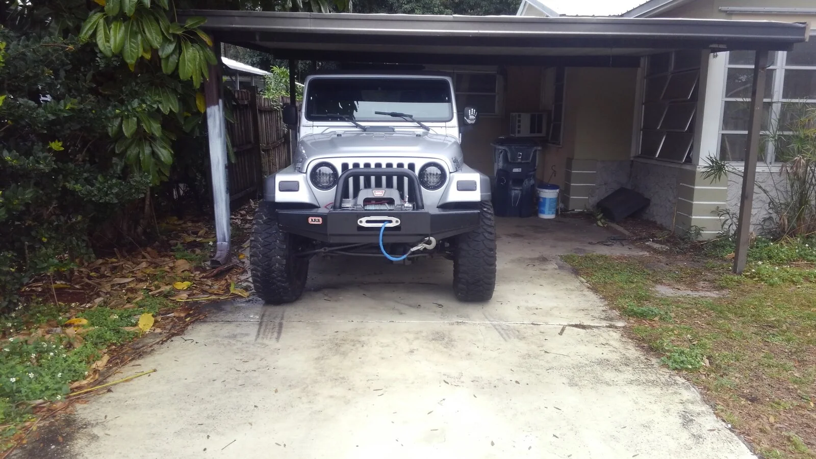

Just installed the winch and bumper I got yesterday. Not a fan of big bumpers, but couldn't resist the price for it all. Got a Warn 9.5ti in perfect condition and the bumper for 750$ I'll end up giving the bumper away when I get everything else done, and ready for a different one.
Just installed the winch and bumper I got yesterday. Not a fan of big bumpers, but couldn't resist the price for it all. Got a Warn 9.5ti in perfect condition and the bumper for 750$ I'll end up giving the bumper away when I get everything else done, and ready for a different one.View attachment 215292
That’s a good looking bumper, but man, I’ll bet those are heavy.

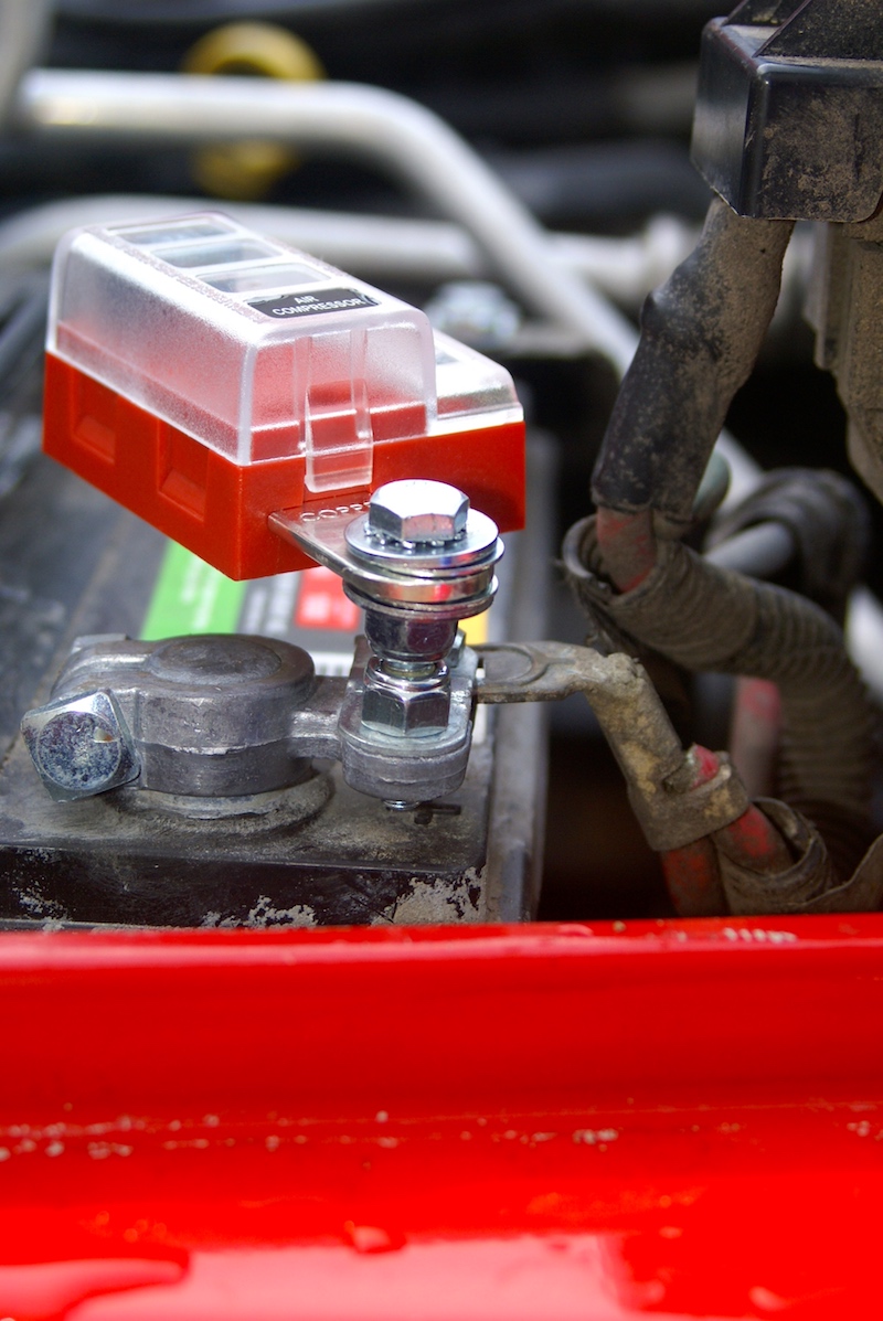

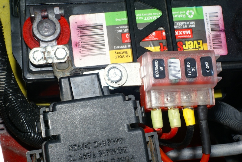

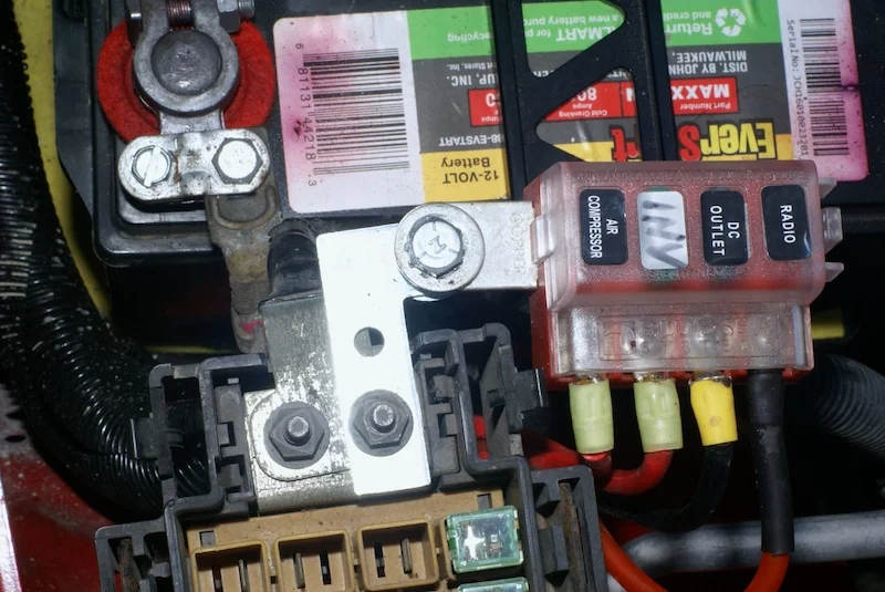

Micro project:
This had the advantage that it worked. I was never too thrilled with it, and its kinda in the way of my upcoming winch connection. So I...
Modded the fuse box slightly so I could move the BlueSea unit up here.
I think this is mo' bettah - and even leaves room for additional units like this should I ever need them.
Had to gnaw on the lid's splash guard a bit though.
