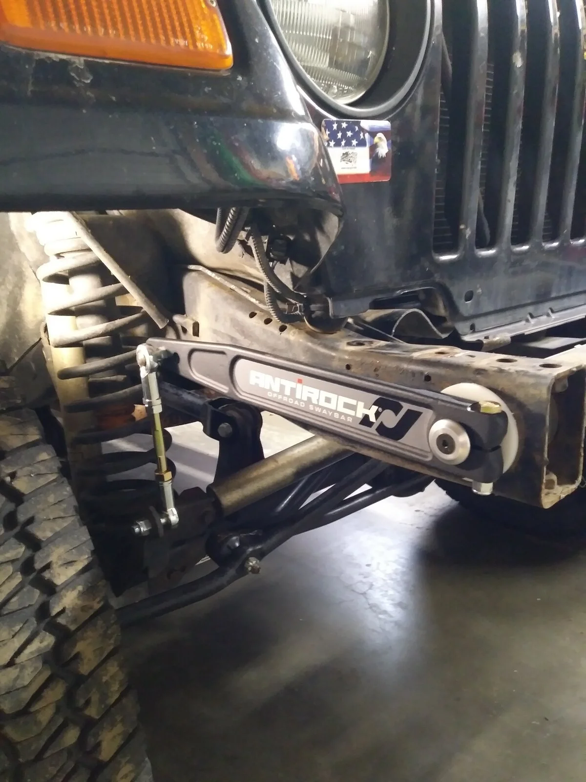

How do you like the way it works,drives, etc.Antirock installed. Hardest part was getting the plastic bushings Installed. It took a little massaging and a lot of whacking with a 2.5lb sledge.View attachment 216677

I haven't taken it for a drive yet. When I do I'll post my thoughts.How do you like the way it works,drives, etc.
