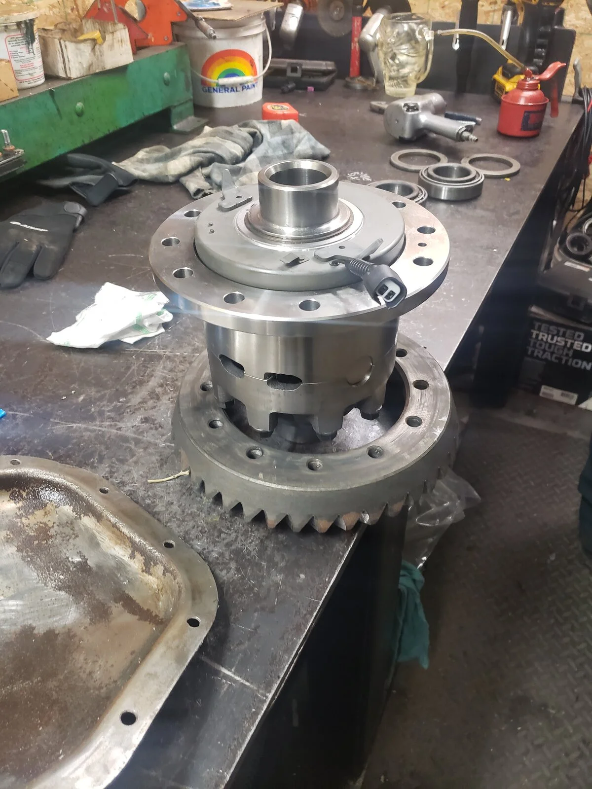

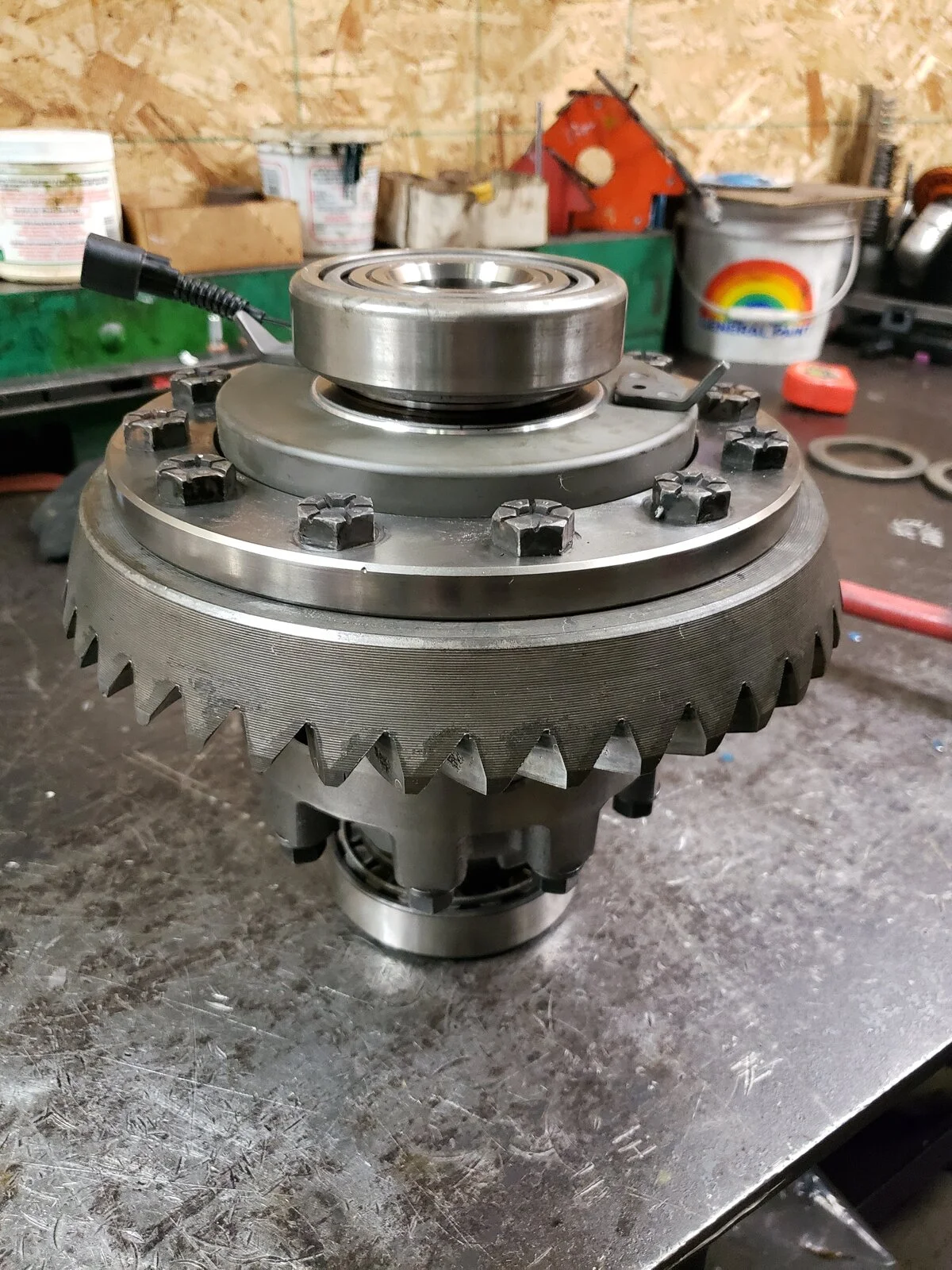

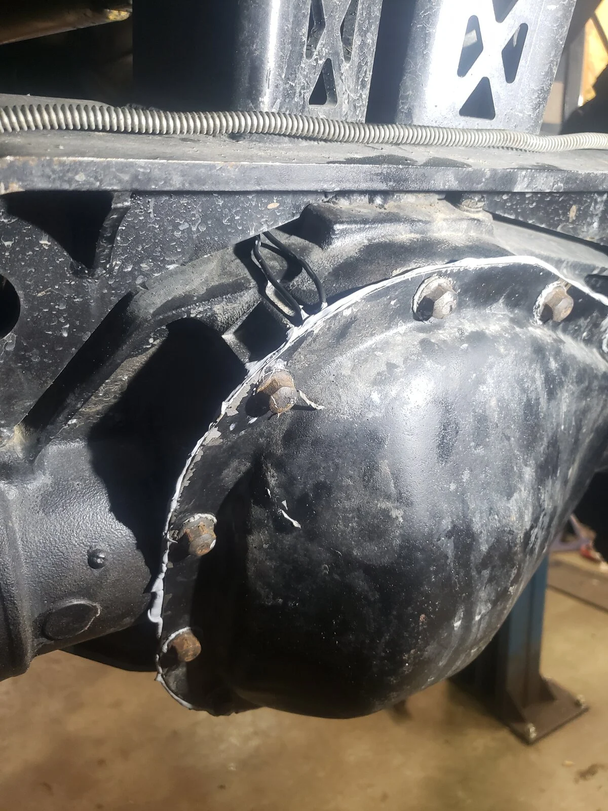

Stuffed a 2011+ Ford SD - Elocker into my 91' Sterling 10.25 diff :)
Was skeptical of this working as I heard someone using this locker in an older diff. Well it fits 👌 Decided against drilling into my housing and just notched the housing for the wiring.. the best thing about this locker is the price...$700 cad !
Still need to wire up to an extra Eaton switch a buddy gave me but the swap is almost complete. Just waiting on my Eaton Elocker for the front...
