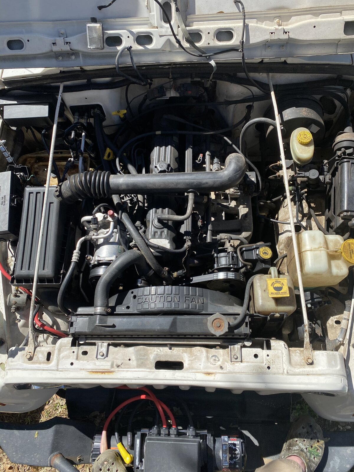

Cleaned the engine bay
Replaced the clutch master and slave cylinder (a casualty of swapping the clutch) put on a new inner shift boot(another casualty of the clutch swap) also installed a 4" shift extender and a new shift knob.

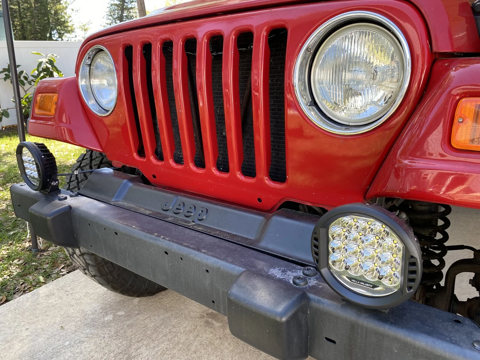

New in the last week: clutch master, pedal pads, coolant container, led fogs/tail/back up lights, s-pod switch panel, replaced blown dash speakers, fix telescoping steering wheel, Morryde tailgate reinforcement mounted & painted/reinstalled door panels... then cruise to the beach 😎

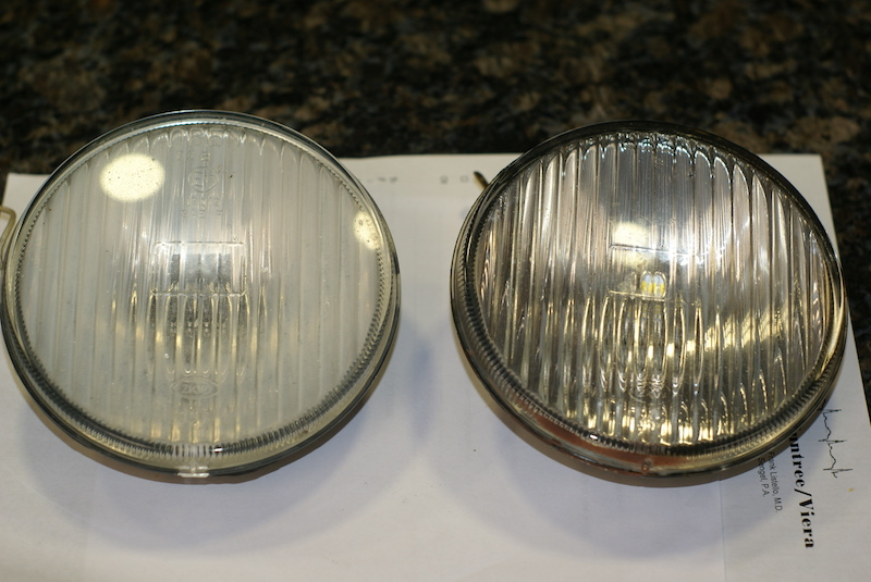

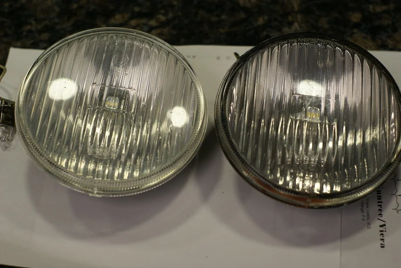

Disassembled and cleaned both fog lite lenses, and installed new LED bulbs. This pair of fog lites obviously were not an original pair, their conditions were different from each other. The lens on the right cleaned up with simple glass cleaner, the one of the left was a battle that involved citrus strip, phosphoric acid, and vinegar to get the white deposits off the inside...
Left is "before", Right is "after"
Same lenses as above, but this time both are "after".
Will re-install and test tomorrow.
