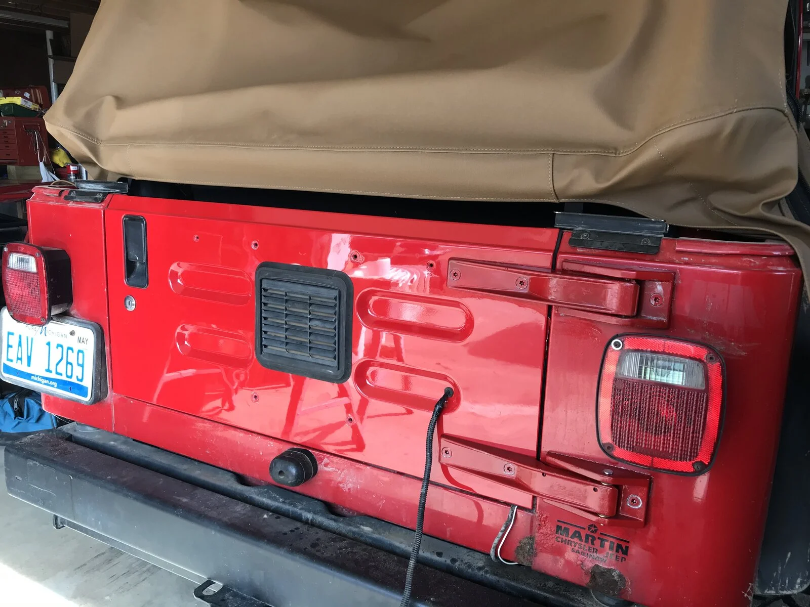

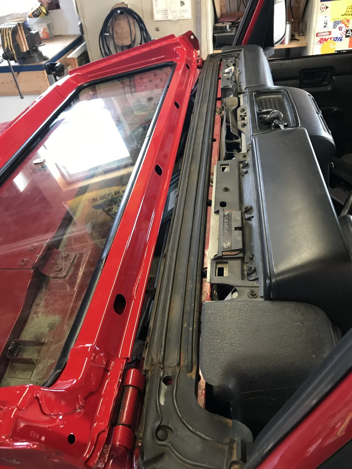

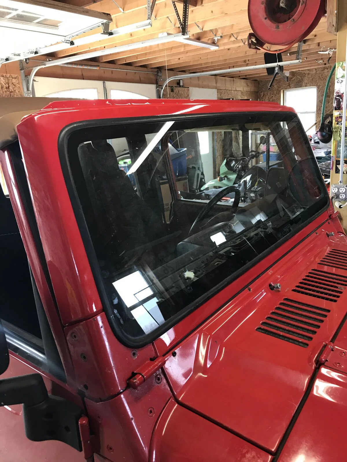

Installed my newly painted windshield frame and tailgate. When reassembling the tailgate I inadvertently locked it 🤦‍♂️now to find a locksmith.
Regarding windshield frames, it’s a total PITA to swap later with earlier and probably visa versa as well.

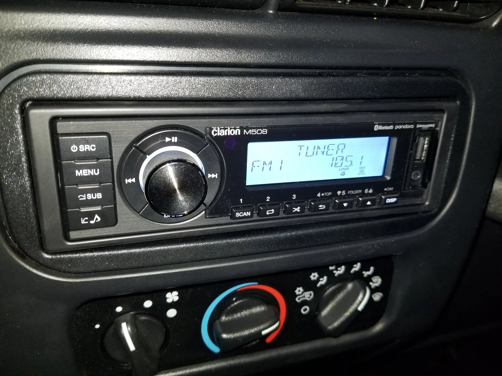

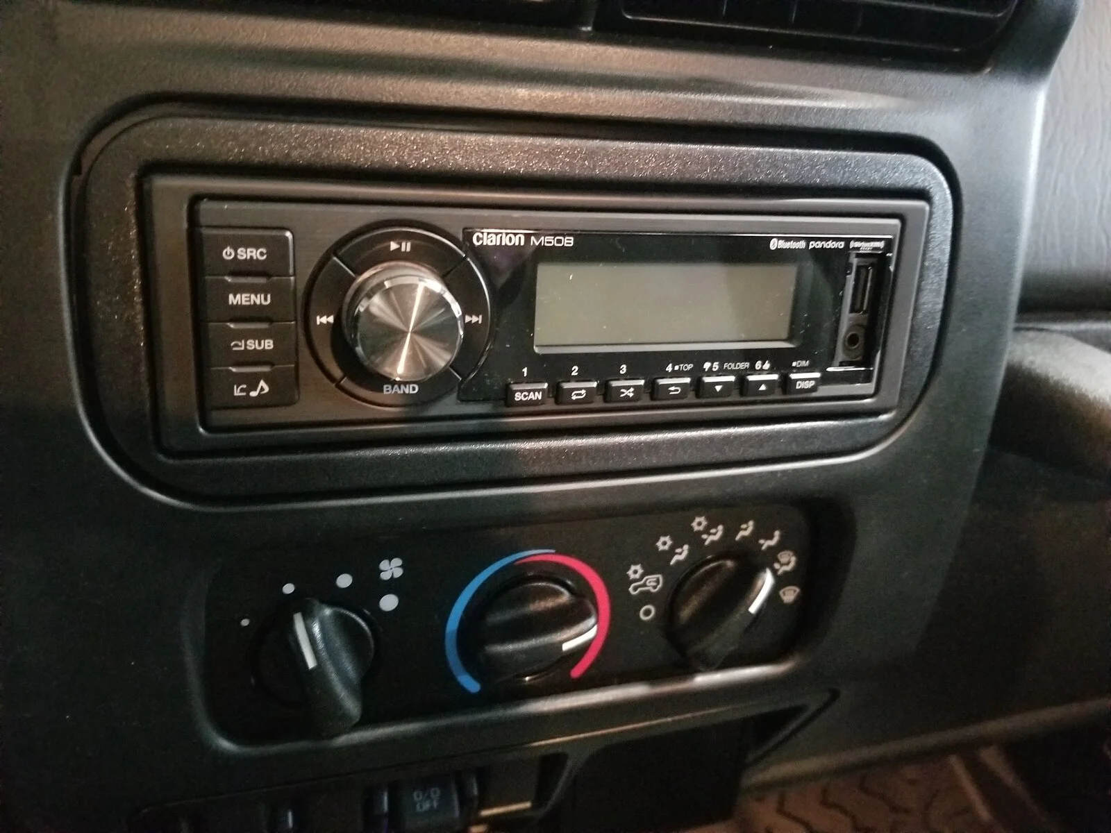

Finally installed my stereo upgrade. I went with the Clarion M508 head unit. My rationale, much like someone else mentioned, is that I am trying to keep a more stock appearance and the typical Kenwood, Alpine, Pioneer stereos have a little too much bling. I also added a Sony in-line amp 45Wx4, four Polk 5.25 speakers and a new "stock" sub from Quadratec. The in-line amp was easy to install, since it did not need separate power from the battery. I'm going to use XM probably 99% of the time, so I didn't need anything with a CD player. It also has Bluetooth, Pandora and inputs for a USB and 3.5mm jack on the front in case I can't get a signal for some reason. Sounds pretty darn good and can hear the stereo well, even on the highway.

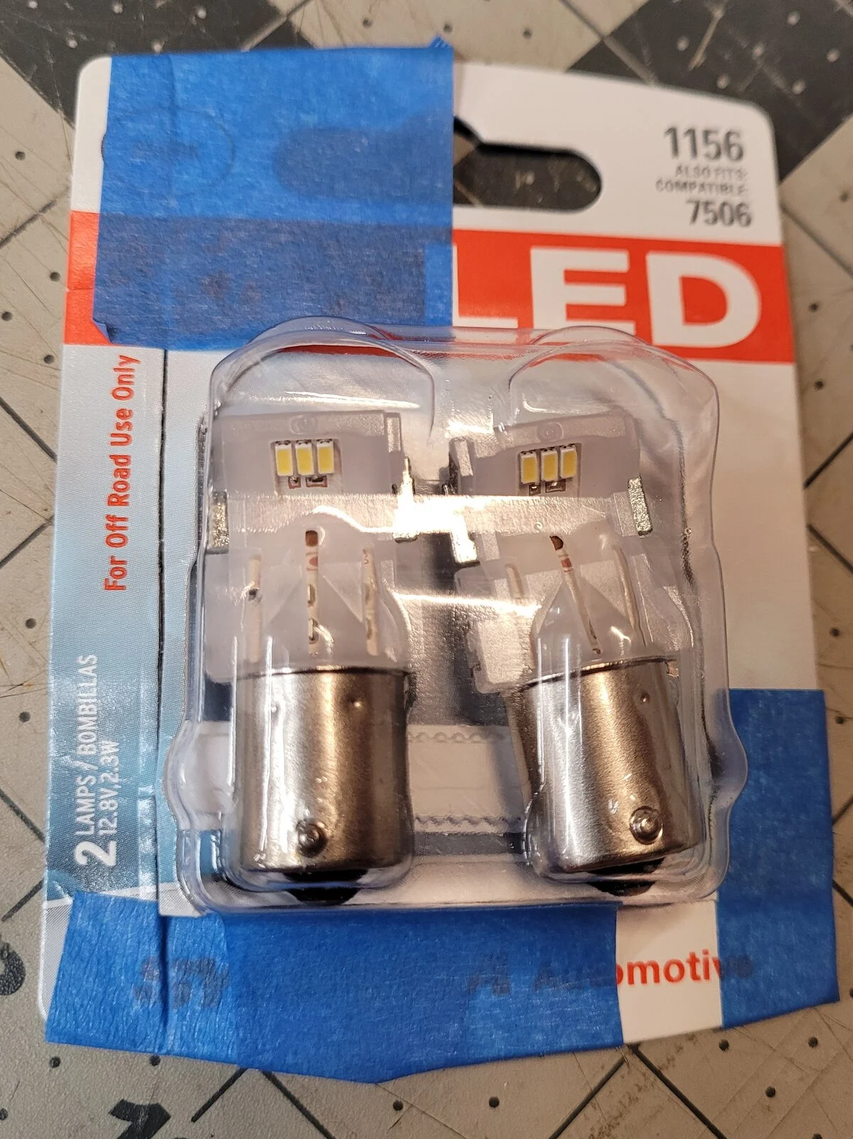

Between coats I added some Sylvania LEDs to my footwell lights. Those were ok. However, I tried adding the same brand of LEDs to my backup lights, and no, they were not good. I didn't even put the lens cover on because compared to the regular bulb on the opposite side, they were just weak.
So if you're at the big box store getting spray paint and think you want to get these for your backups, don't.
Made that same mistake with the sylvania LED's. They point backwards-ish to light up a reflector, which we don't have in our reverse lights. I ended up getting some LED's off amazon that have a little projector on the end to throw light straight out and they're fantastic!

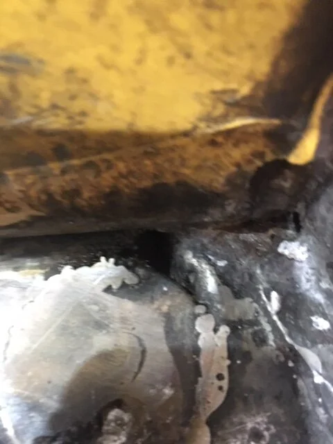

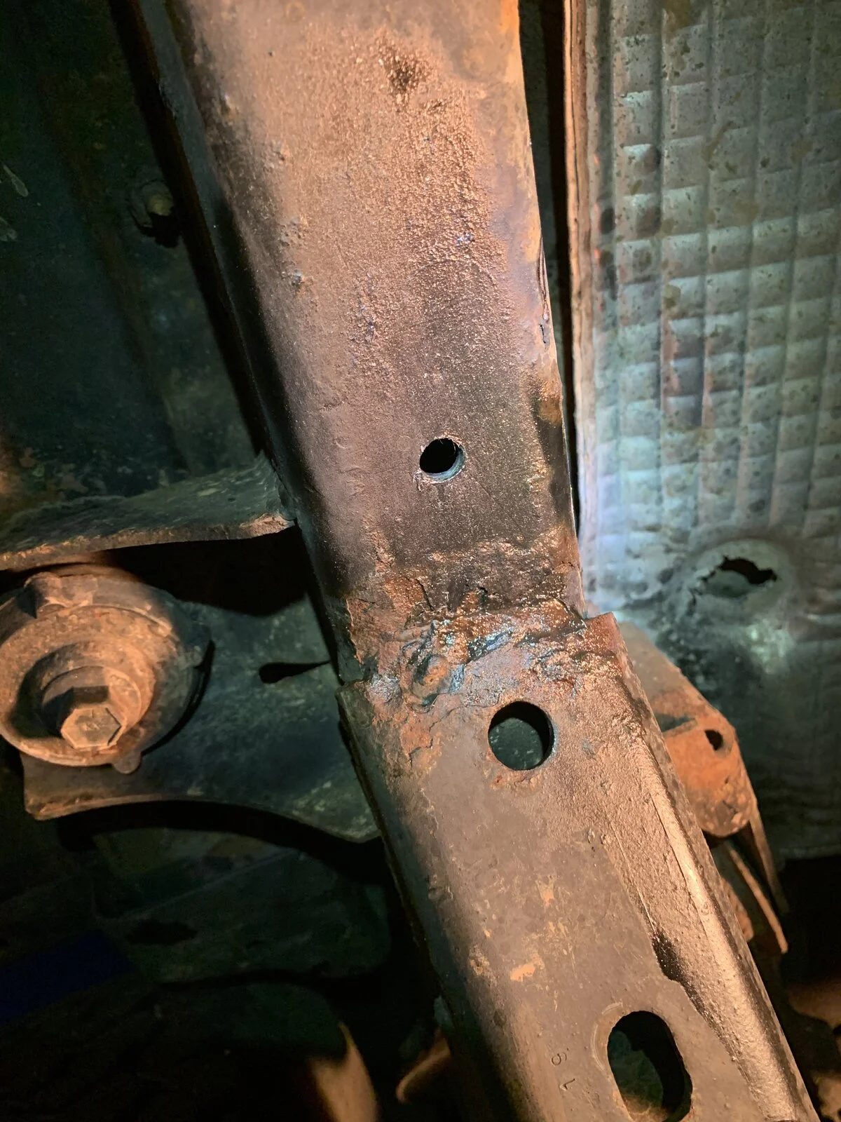

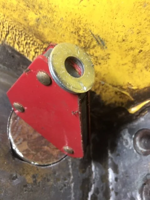

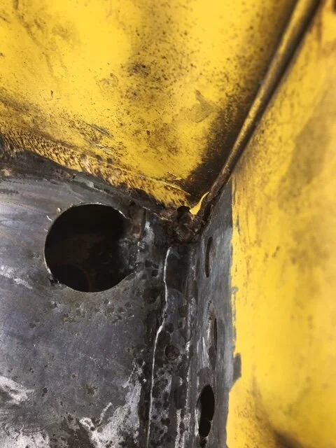

Finally got around to installing drain holes in my frame, largest bit I had was 3/8 so hoping that's large enough.

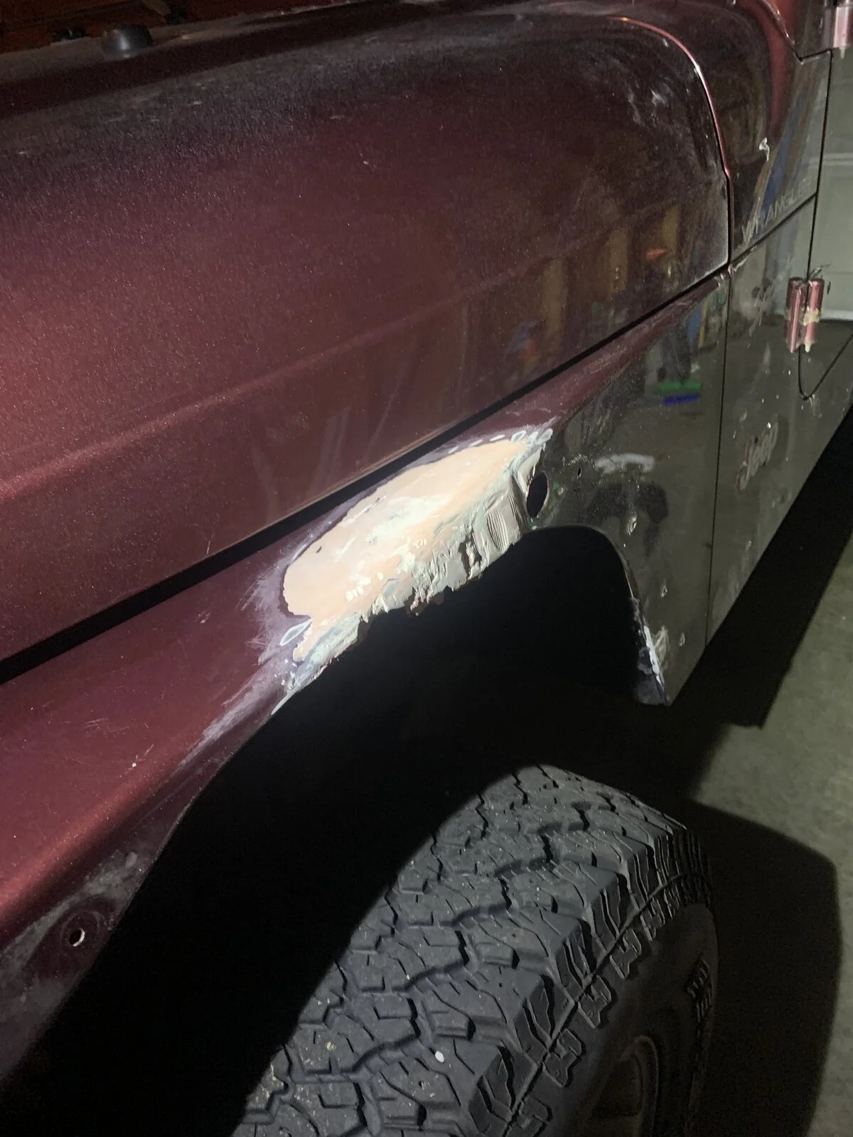

Also started the process of fixing my fender rust and painting the fenders, today I got my flares off, stripped all the rust of the fenders and the inside, undercoated it, and put bondo on. Hoping it comes out better than on my last car, if its terrible I can always get new fenders easily enough.

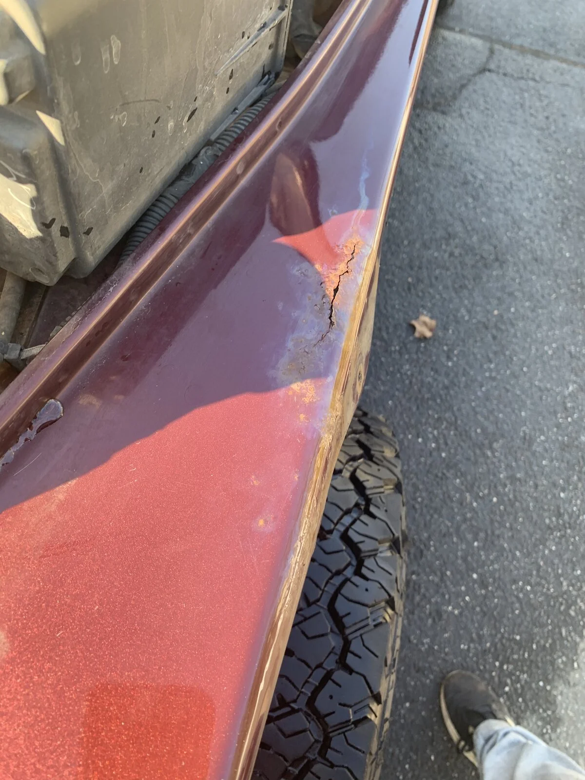

Started on the rust under my doors too, and found out the previous owner had already put bondo there and must have not gotten rid of all the rust 🙁. So turns out that be a bigger issue than I though, guess I'll "have to" buy some sliders to cover it up after I get rid of the rust ;)
