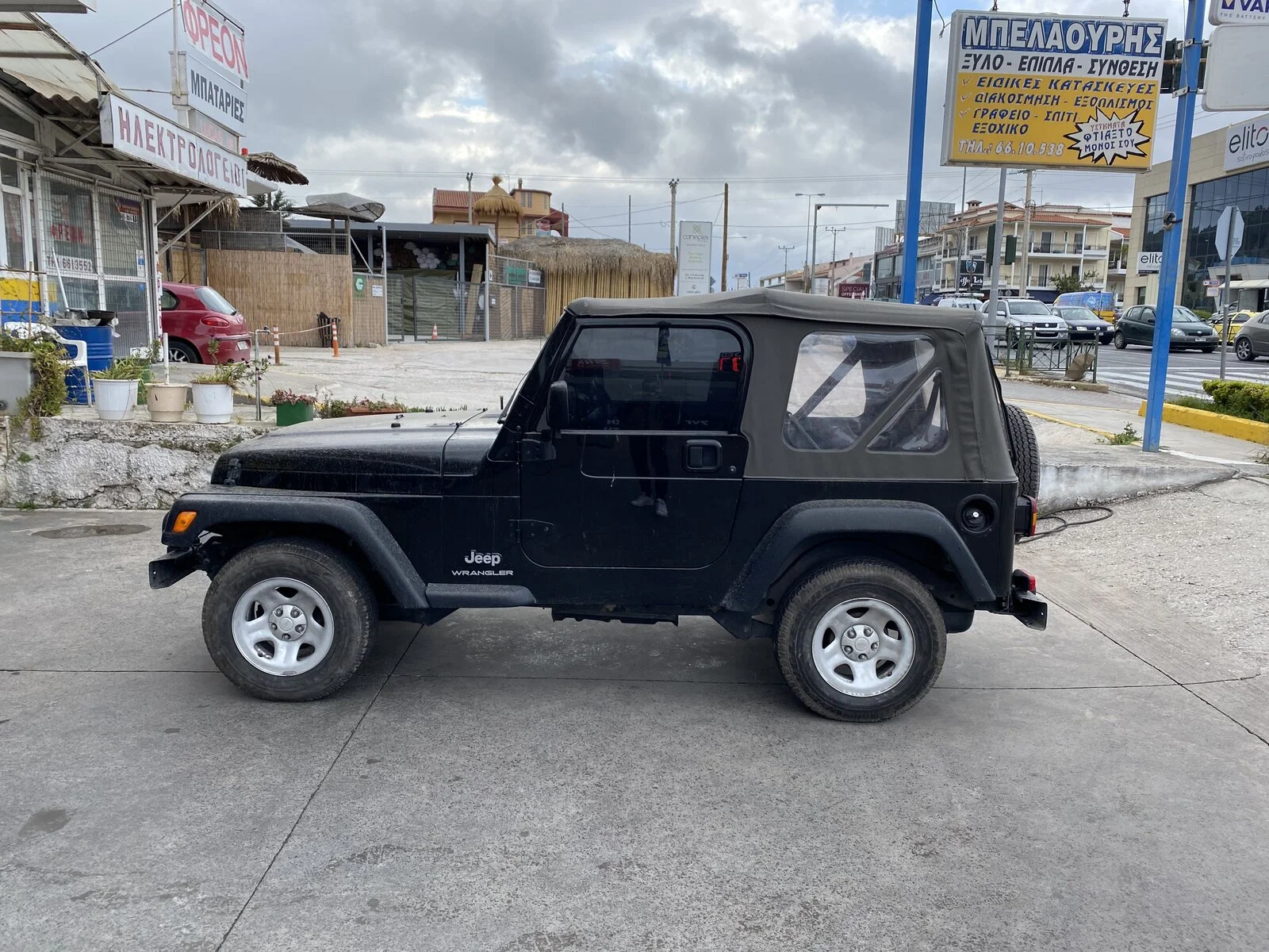

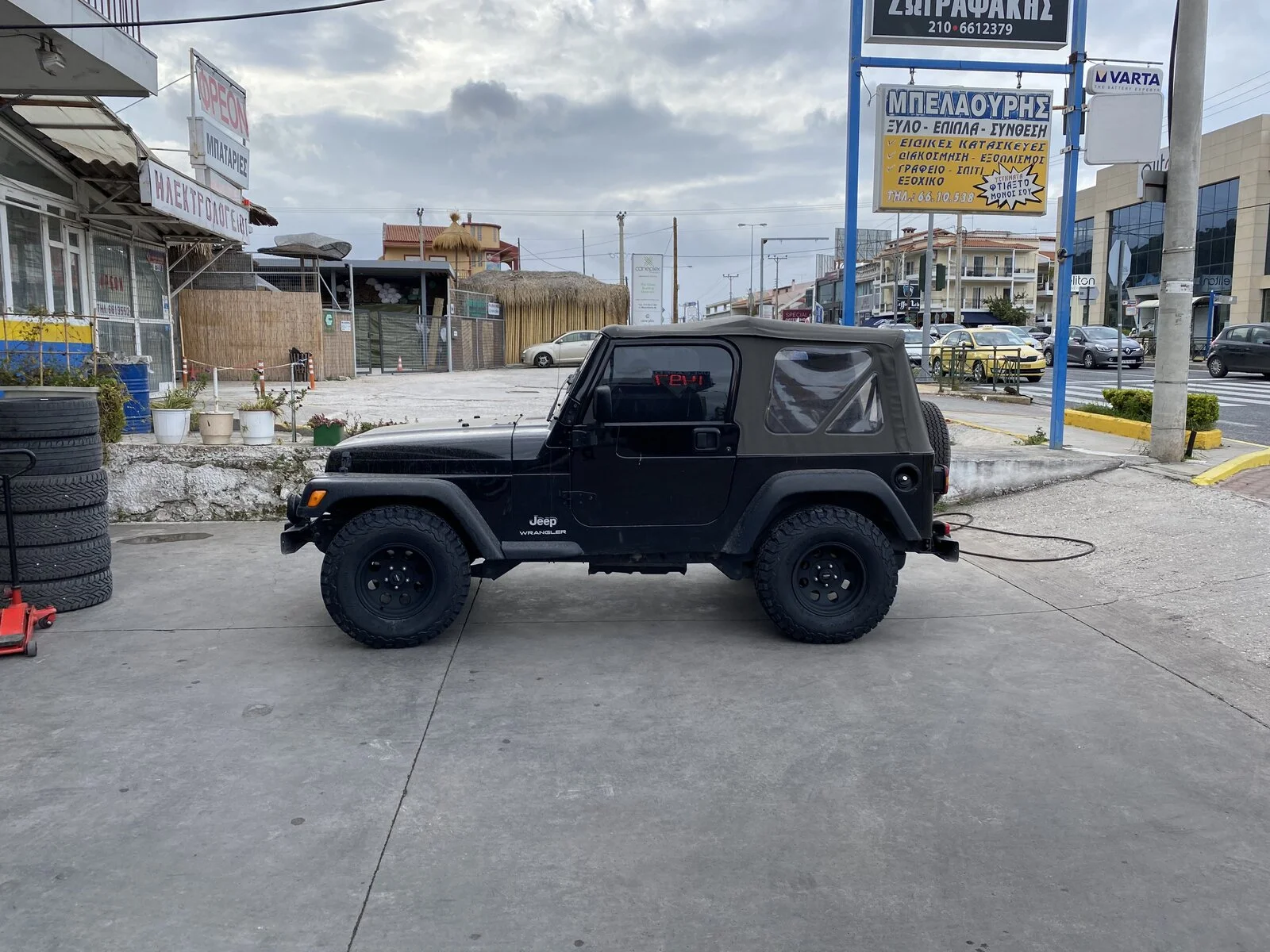

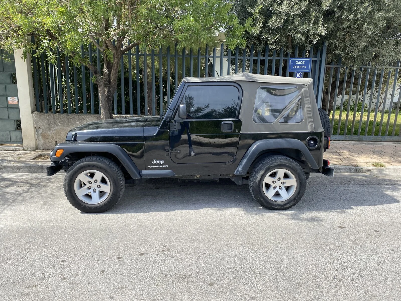

Photo #1: Rubicon rims with Goodyear Wrangler All Terrain with Kevlar 235/70r16 (29") that I was running for the past 2 years.
Photo#2: Stock TJ rims with stock TJ Goodyear Wrangler Tires 215/75r15 that I ran for the past 10 days, because I sold my Rubicon rims to buy the new ones! This is a good comparison though because is the tire size that my TJ came stock with.
Photo #3: My new Procomp 7069 15"x8" rims with 3.75 BS and 31"x10.5" BF KO2s. (White letters inside!)

Is there any lift? do they bottom out or rub. What about your spare?
Asking because I am buying new tires today.
It is stock suspension right now! I am going to install a 2" lift in a few weeks.
I have not tried if they rub yet. But they will rub 100% off road. Thats why I'm installing the lift.
The spare is stock right now. But the 5th tire&rim are going to be installed in a month.
Thanks I just read your build link.
I dont think I would chance it on mine without a lift as I have the painted Sahara flares and think I would have trouble replacing them.
