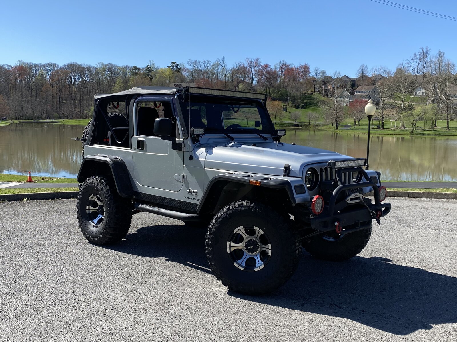

After 3 long weeks at the shop (most of which I was on vacation) I got mine back. WOW! What a difference in the ride, I didn’t know it rode so horribly until this morning! I think my favorite part is shifting without a tcase drop, I know see how that knucklebusting can be an issue! #frankenlift
congrats!
my driveshaft comes in on Wednesday. I practiced shifting with the transmission in the correct place and it’s a totally different feel. I bet 2nd and 4th are gonna be like “so this is what engagement feels like “
congrats!
Oh it’s frigging unbelievable, don’t even get me started on reverse!!! It’s probably what I appreciate most about it all! Can’t wait to hear how Wednesday goes, I feel your pain on having to wait!

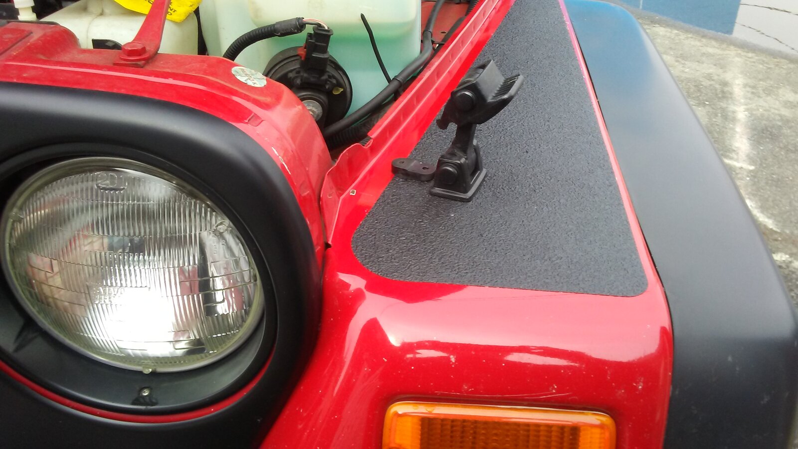

Were id you get those fender protectors? Thats what I need, I cant find them in Oz only ones for Landrovers. I was going to attempt to cut my own out of Gorilla Grip.
Cheers
Your favorite online Jeep store Quadratec. The site says they're "IN Stock." :unsure:
p.s. Tough Stuff makes them and Q-Tec stopped selling them.

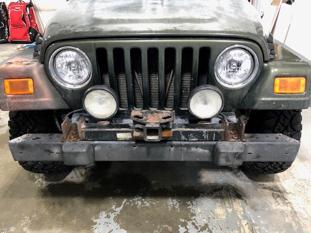

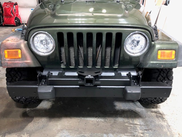

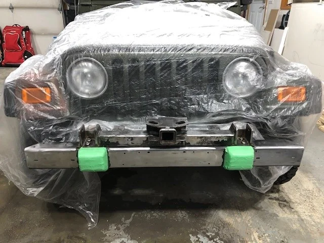

My '06 TJ has a front bumper mounted hitch, presumably for a snowplow, but could be handy for all kinds of things, so I spent some time grinding down the old paint and rust, then wiped it down with grease and wax remover, and then primed it and coated in rubberized rocker guard. I've got KC Lites coming to replace the original cracked fogs.
On another note, the fenders both have rust in them and the passengers side has really great Patina. What have you guys done when there are rust holes in the front fenders and nowhere else? Replacement fenders?

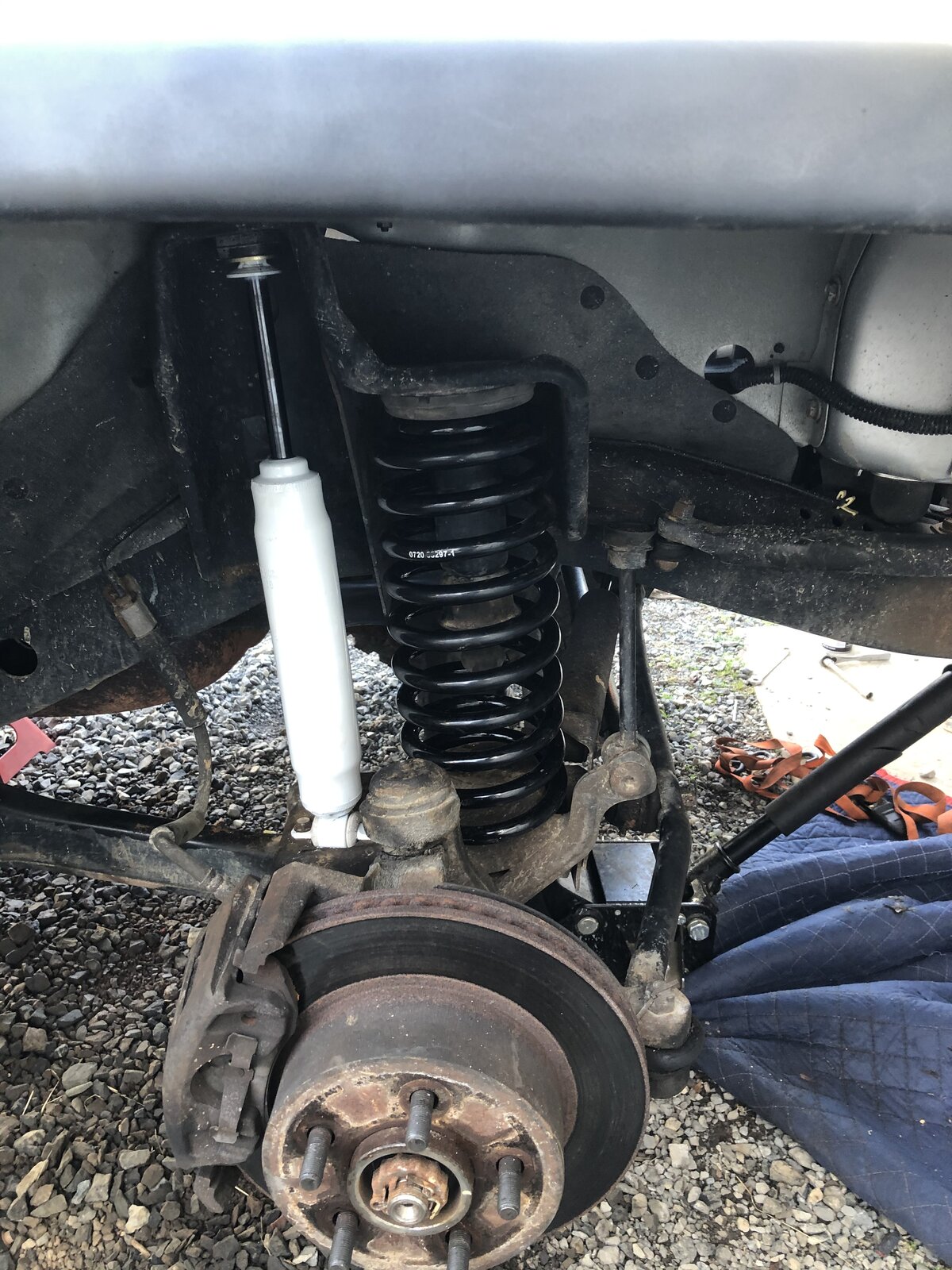

Buttoned up everything underneath the Jeep and took it out for a test drive. Pulled back into the garage and hear a squalling bearing sound. Now the dang A/C compressor is making a racket.
Clutch was fine. Shifted and drove just fine. I filled the trans (AX-15) with some cheap 10w30 synthetic that I'm going to drain after a few days (after I get my A/C delete pulley assembly). I have some Redline MT-90 ordered and will refill with that for the future. I'm still not happy with the noise I'm hearing from the trans as it sits at idle. But, I see some say these transmissions have some noise at idle. I just don't ever recall hearing it until recently.
