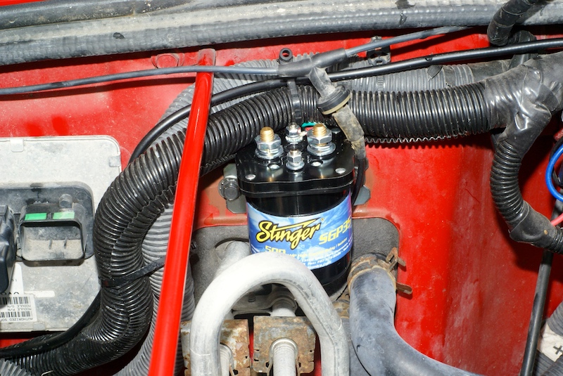

What cable set up did you use for thew winch?
I was going to build a bracket to mount the blue sea disconnect but it might be easier to run disconnect wires like you did.
Not sure what exactly you are asking, the battery cables are #2 I believe, I made them up myself and put the anderson connection on. The winch rope is MasterPull Super line II I believe......
Got the winch power solenoid mounted - but not at all happy with the vacuum line. Need to fix that...

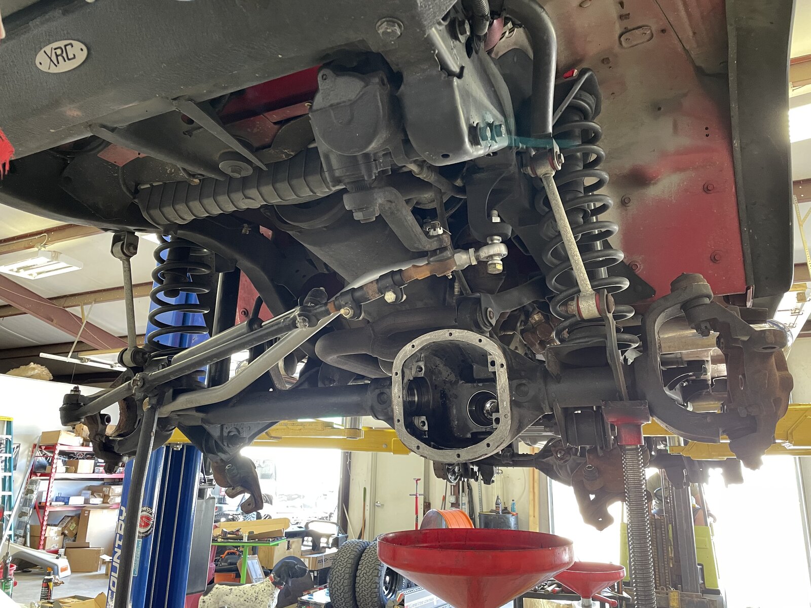

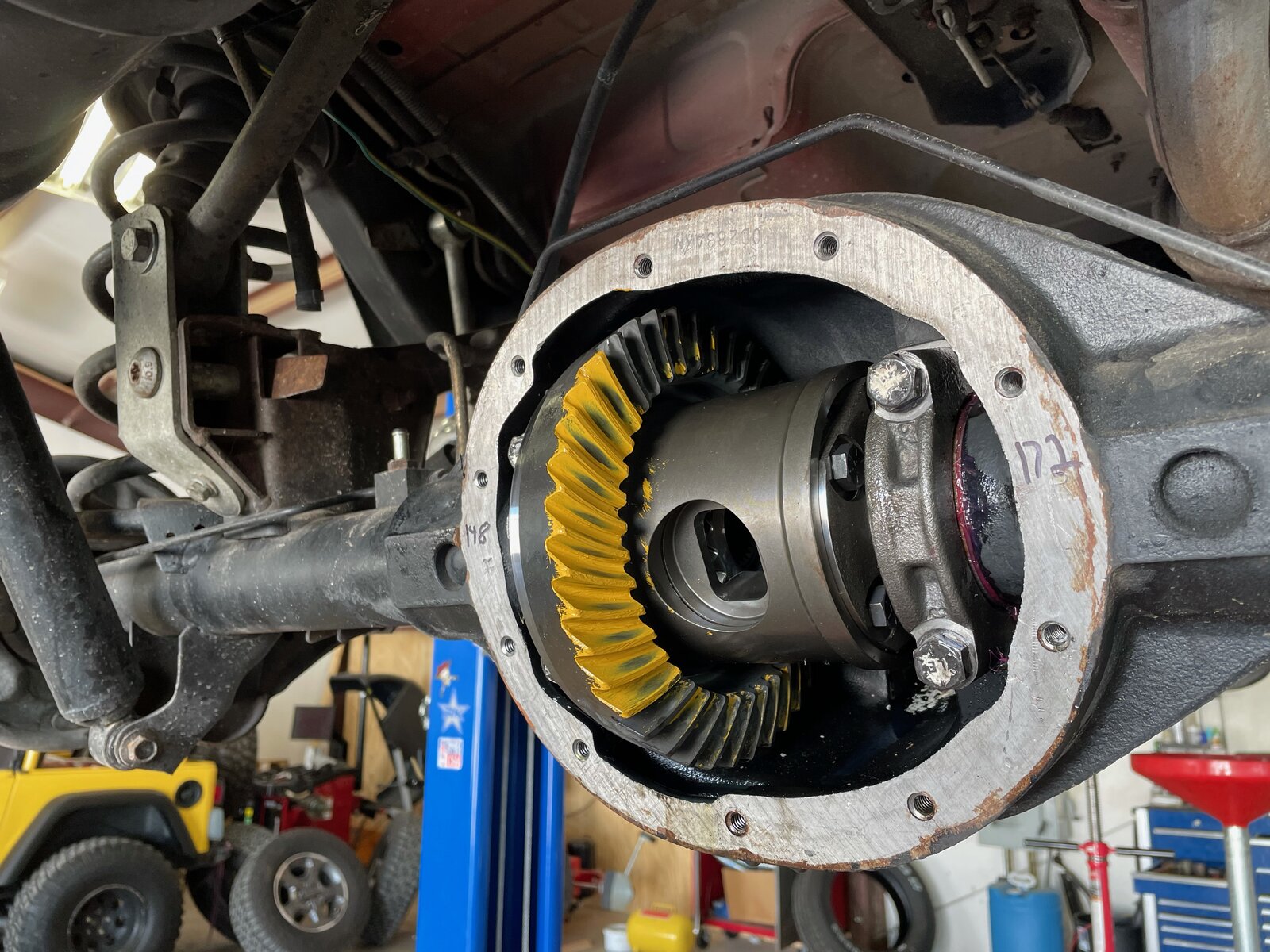

I picked up my TJ at the shop after getting 4.56 gears, True Tracks, chromoly axles & front wheel hubs. While it was there, I had them change the oil in the 6 speed manual transmission & transfer case as well as flush & replace the coolant & brake fluid. It seemed like a good idea for a 15 year old vehicle.
WOW! What a difference the 4.56 gears make! ‘So much better than the stock 3.07s with my 33/12.50 KO2s!
I still don’t have the 39 tooth speedometer gear, but that will be installed after the 500 mile break-in when it goes back to the shop to get the differential gear oil changed.
