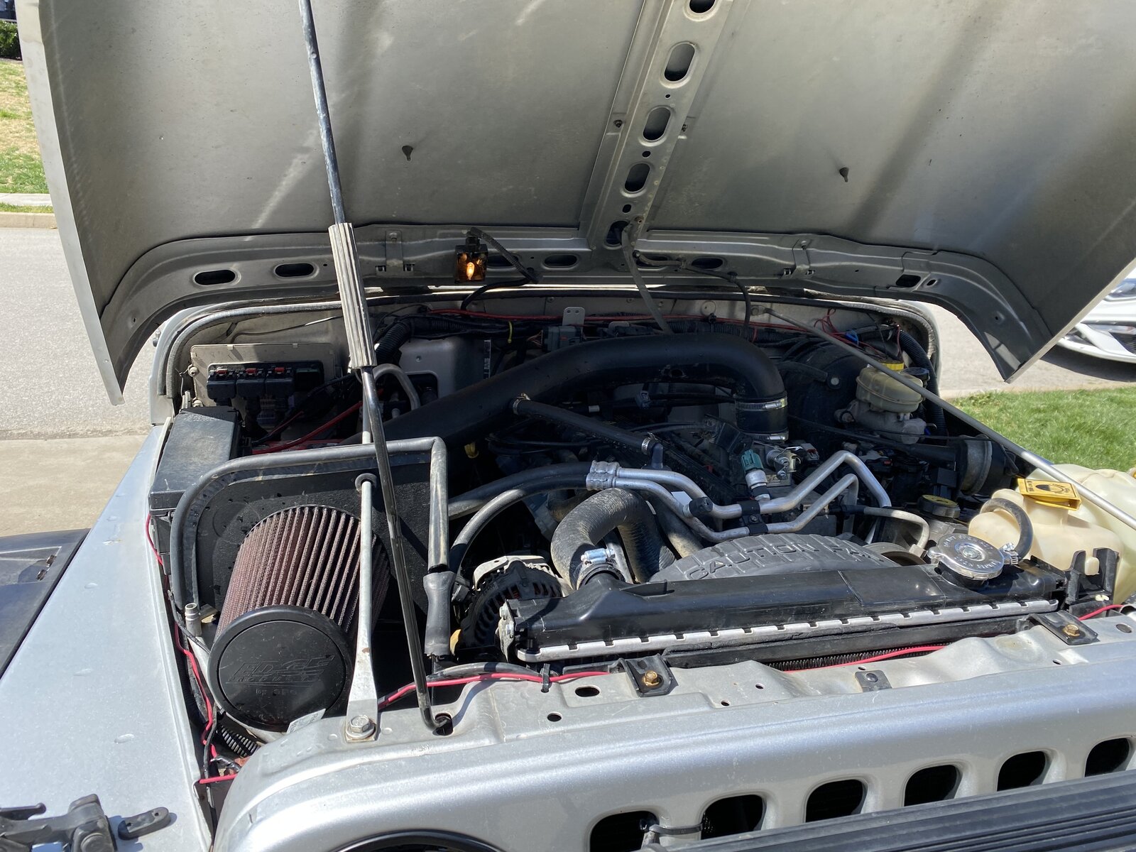

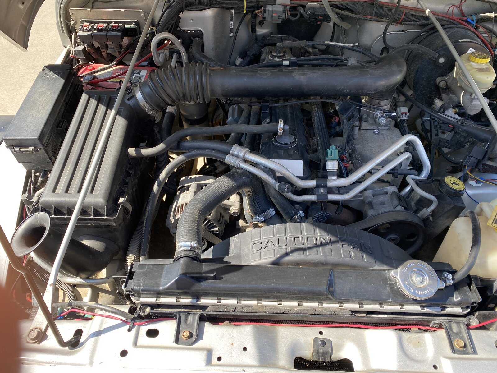

Washed the mud off after wheeling on Friday. Man that stuff just glues to the frame, I was lying underneath scrubbing. I’m about ready to give that up 😂
Also, to my delight I restored the airbox back to stock form. Had to get creative to close up some cracks, but it’ll work!
What is the benefit of going back to a stock intake? I know people always preach that an aftermarket intake won't give you any performance gains on things, but I thought it was just a waste of money not worse

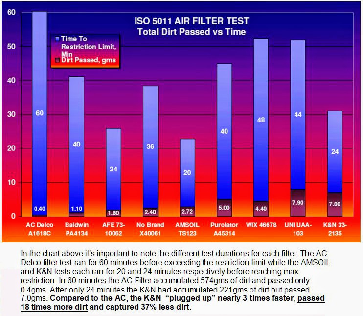

For me the aftermarket did nothing but create a slight whistle as I shifted gears. As much as I enjoyed that, I just feel like the stock airbox was designed for that engine, therefore it is best for it. I believe someone posted a link recently about how much more debris gets in the engine with the aftermarket intakes. Maybe it was @Jerry Bransford ?
