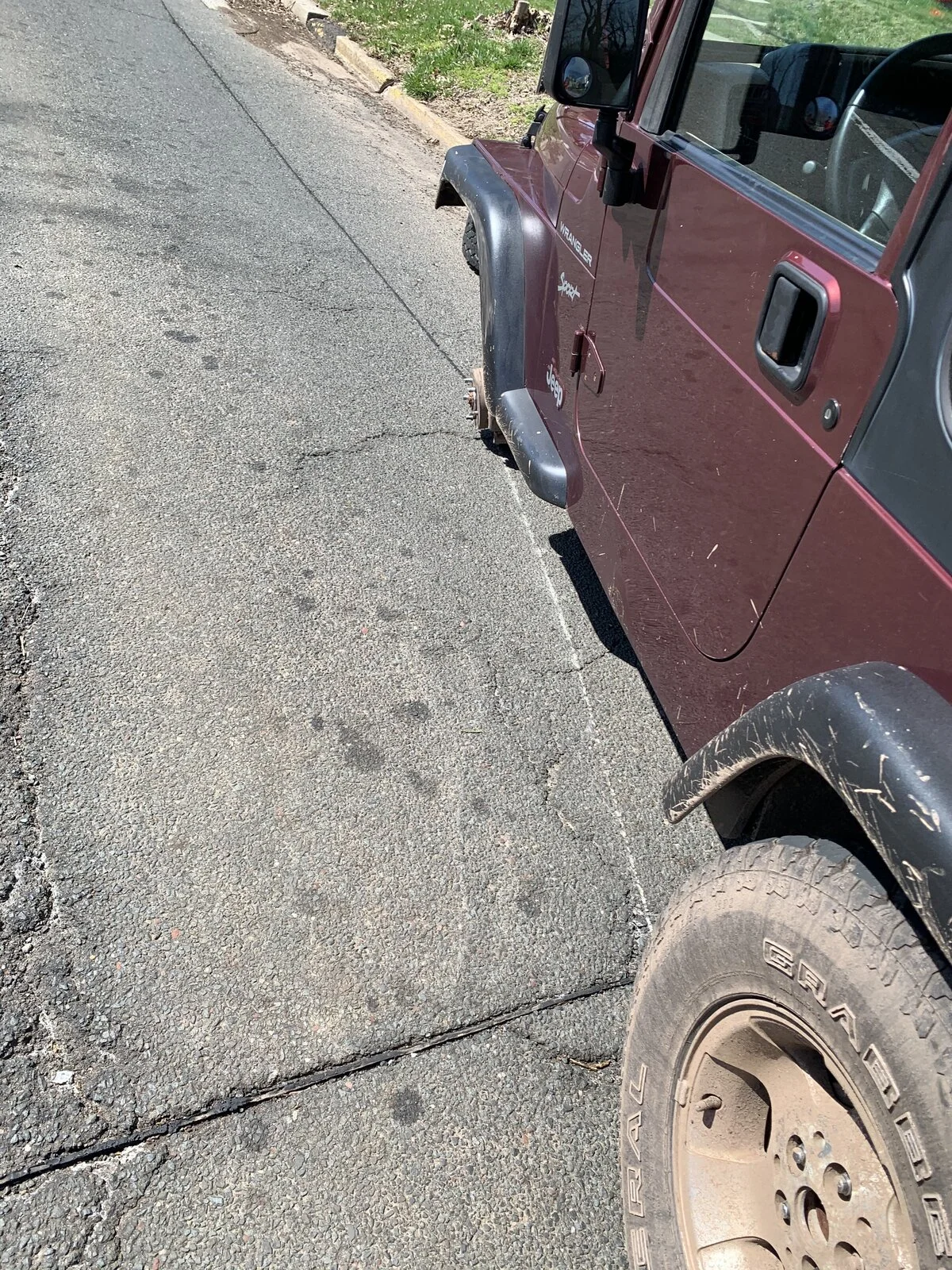

Well I planned on just driving it to work, but the jeep had other plans.

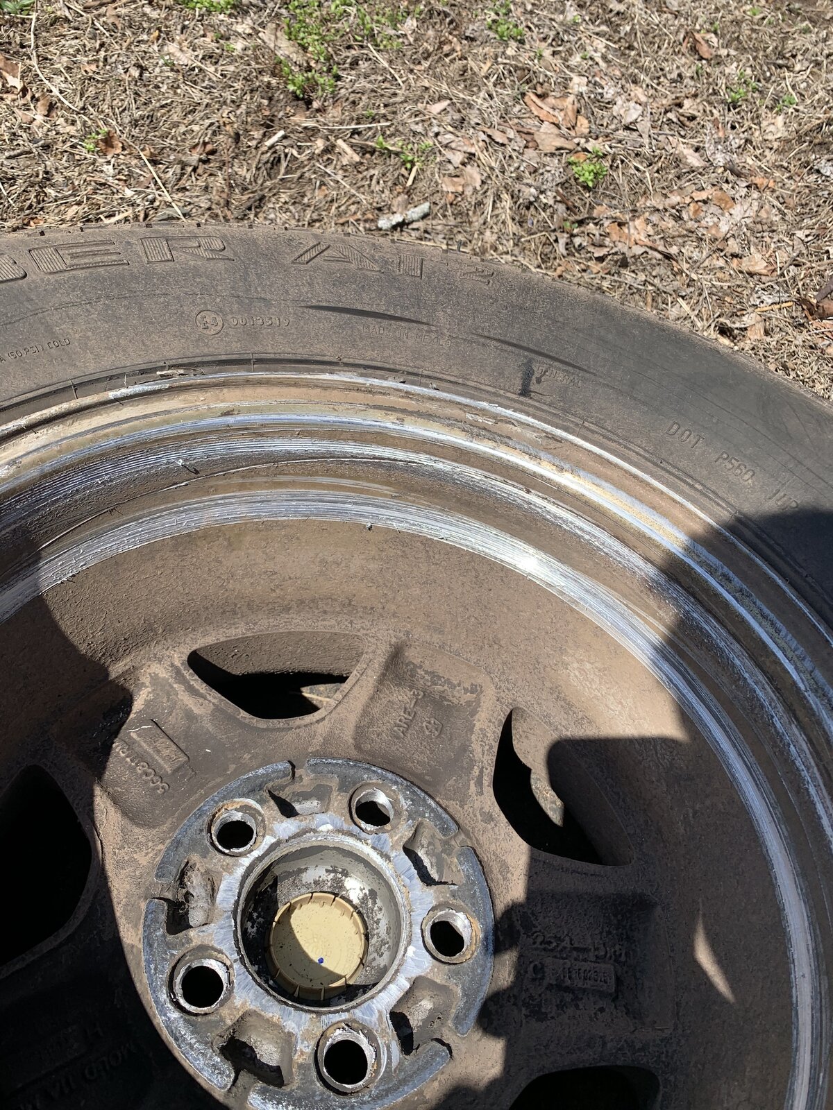

Started feeling a weird vibration when driving, then saw my wheel roll past me. It rolled for a bit and then went across a very busy street, bounced the curb and hit some guys house. By some miracle it didn't roll into another car. Luckily I had a box of new lugnuts sitting at home that my dad was able to bring to me, the studs were a little messed up but I was able to get the nuts on easily enough. I was able to get the wheel back on and drive it to work after.
Got some damage on the inside of my wheel but it just seems cosmetic, good thing I'm getting new wheels in a few weeks anyway. It also looks like it messed my rotor up a little because the rotor became the wheel for about 20 feet. I think the rotor isn't damaged enough to be a problem, but it has a sharp edge and might mess up the pad. I guess this would probably be a good time for some new black magic pads and rotors to be safe, mine were squeaking anyway.

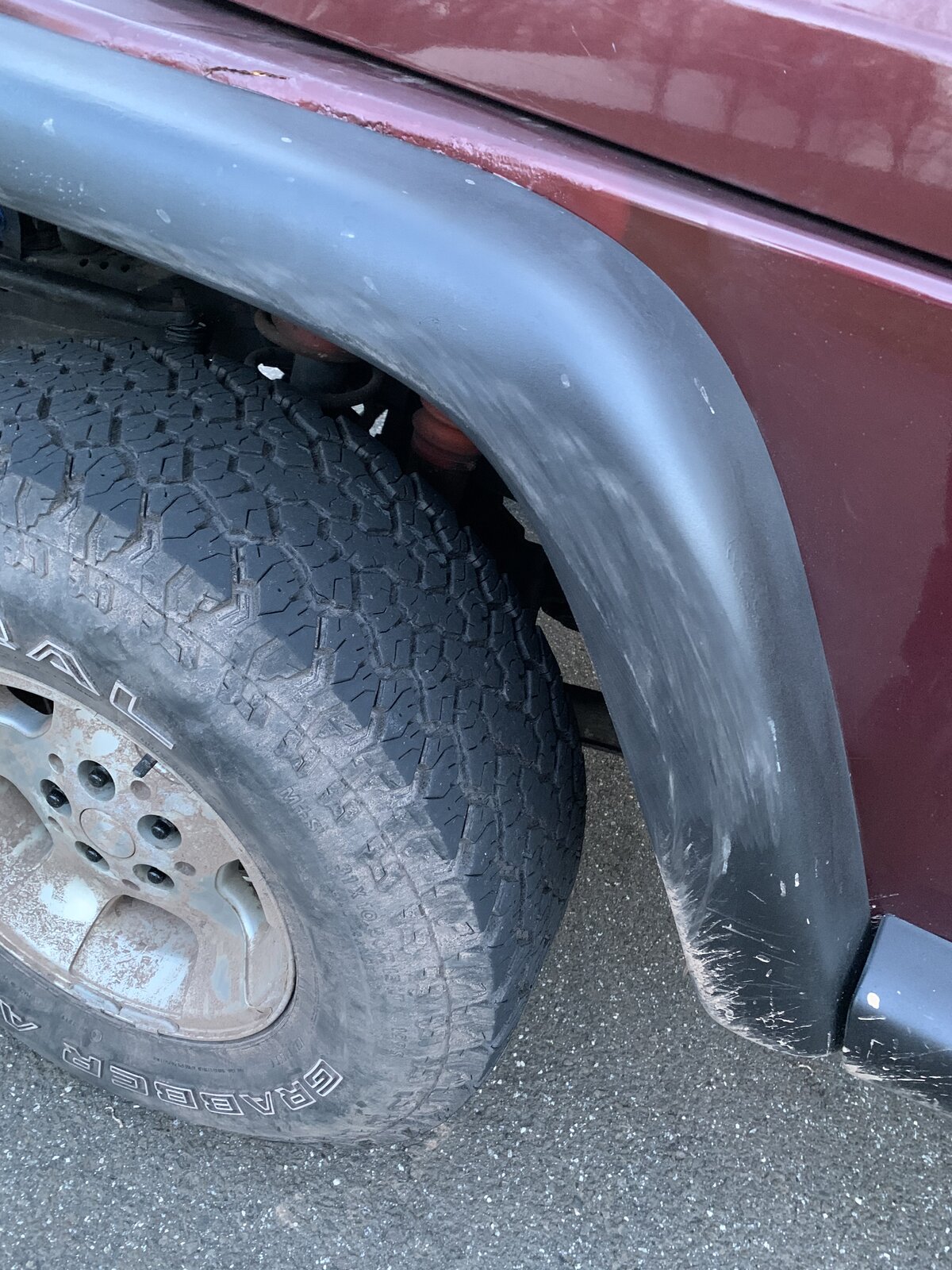

Sadly I also scuffed my fender flare that I had just painted
Now I am (almost) positive I torqued these down to 100 ft/lbs when I put them on last, probably about a few weeks ago. I know my u joints were bad, and I had been hearing a squeaking noise from that wheel for a few days which I thought was the u joint. I also did some mild offroading the last 2 days, and have a loose trackbar bushing. Is it possible a combination of off roading, bad joints, and loose trackbar could be enough to vibrate the lugnuts loose?
Or is it more likely that I'm just an idiot and did not torque them down as much as I thought
Or is it more likely that I'm just a complete idiot and did not torque them down as much as I thought
Alloy wheels need retorquing after 50 mi. Had that happen to me with 1/2 ton pickup w/camper and car trailer hauling my cj5 at 70mph. Drivers rear came off and passed my ass. Tire didn't hit anyone, brake drum went across median and didn't hit anyone. Every time I hit the brakes it would hook left so I was like on the brakes, hook, off the brakes about 10 times before I got stopped. Went from right hand lane to left shoulder without hitting anyone. That was my intro to the need to retorque alloys. Boy did Les Shwab get an earful from me. They did all repairs at their expense.
After this I'm going to want to retorque my lug nuts daily 🤣

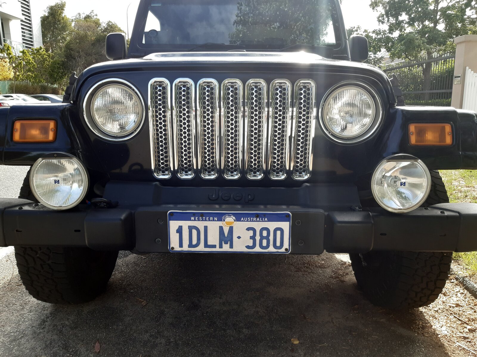

Put some cheap fogs on to see what they look like, only cost me $10au $7.60 us, bit big but they will do while I put my feelers out there in oz for some Mopar fogs. Shouldn't take long I hope as everyone is taking their lights off for LED,s and I know the early TJ Renegades (Sahara) had them on.
Now have to have them wired to my hi beam another one of our laws lol

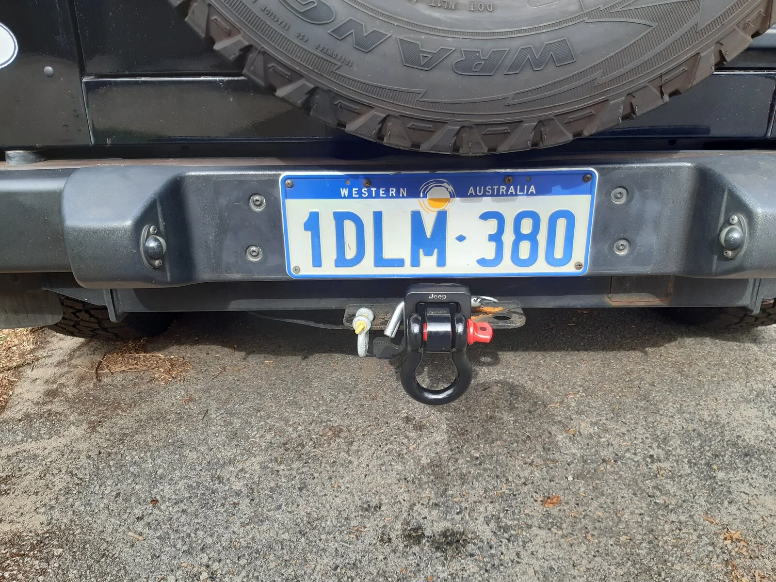

And just as i was posting my hitch receiver shackle showed up.
Wait your fog lights have to be wired to your high beams by law? Doesn't that defeat the point of the fog lights, because the high beams would be reflecting off the fog and blinding you?
I would like to get some fog lights but the light mounts on my bumper are probably too high for fog lights to be effective since I know they have to be mounted low
