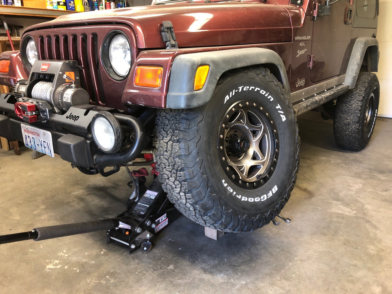

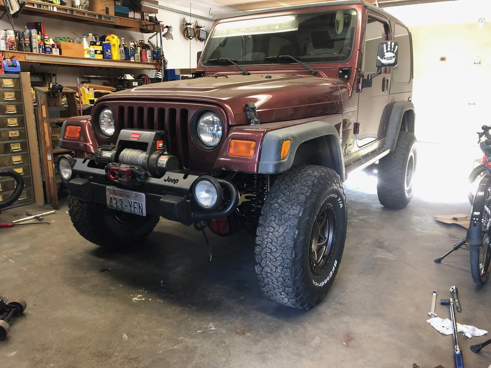

cycled the suspension today, my new springs allowed me to removed my 3" of bump stop. Looks like I'll still need to add a 3/8" puck at the bottom to keep the diff out of the track bar. And she's under her own weight again at the end of the day, first time in weeks!

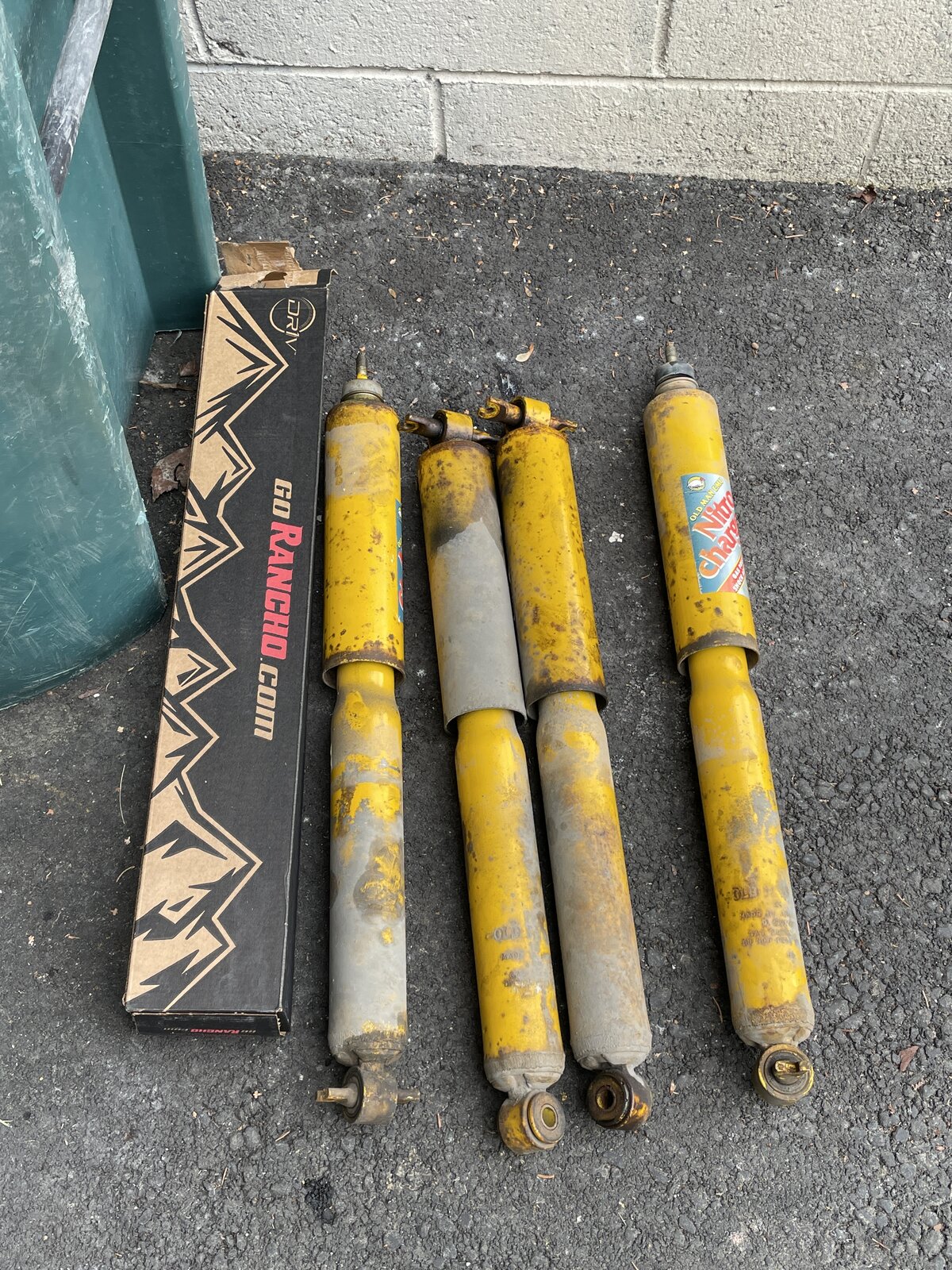

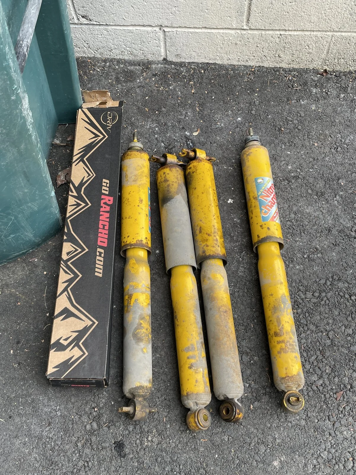

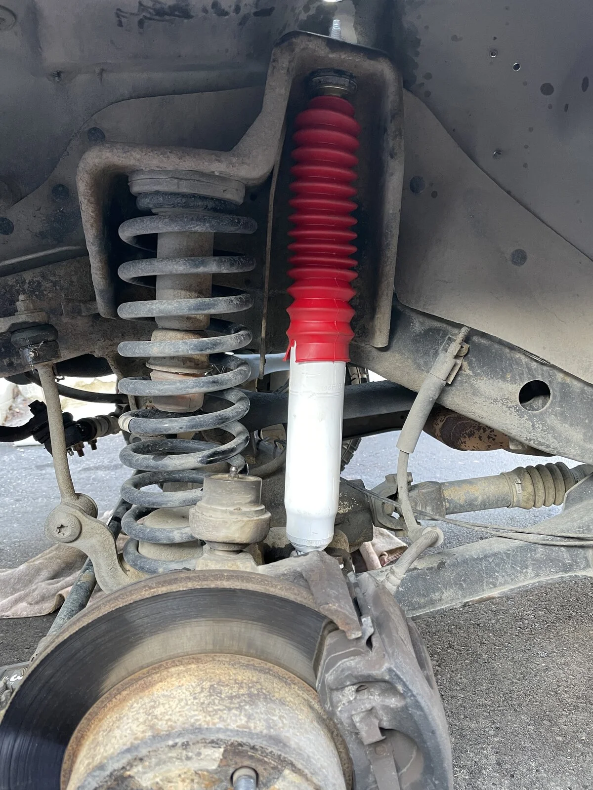

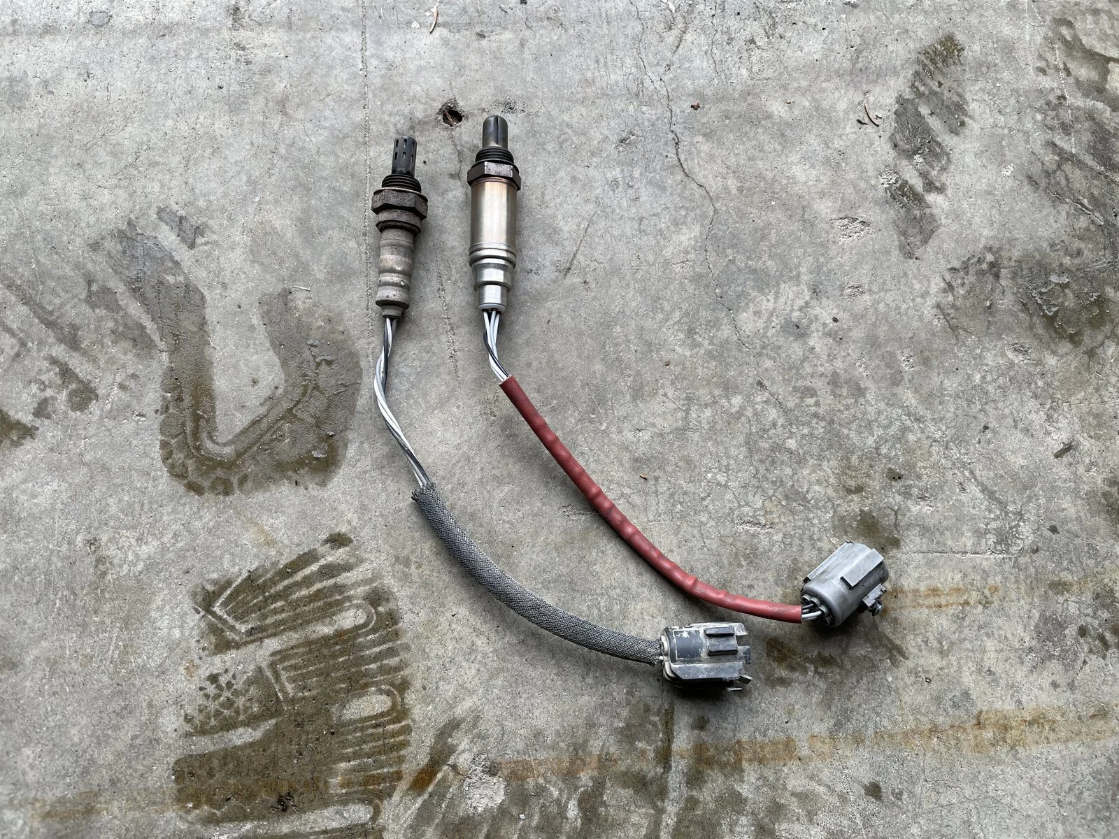

Finished the shocks. Ranchos all around. Also finally got the downstream O2 sensor swapped. Now both are the the correct ones.

In my humble opinion, I would get rid of the shock boots. They do more harm than good. Happy jeeping.
