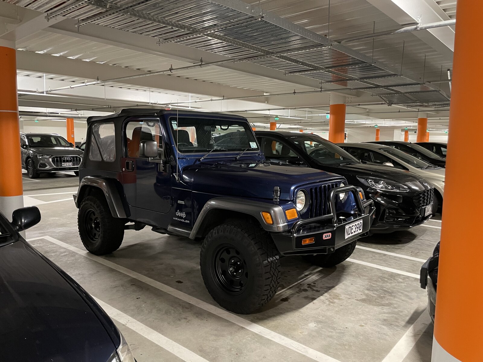

Oh absolutely, I got the half doors for a summer option! Also, because how many vehicles have half doors!?
I have the half doors. This is my second Jeep (YJ/TJ) and both have had the half doors. Maybe a more common option for Arizona Jeep’s at that time or I just lucked out. The difference I have this time is that my upper are the glass sliding windows compared to my old YJ that has the isinglass zipper style. I was alway worried about scratching those and not so much with my current setup.

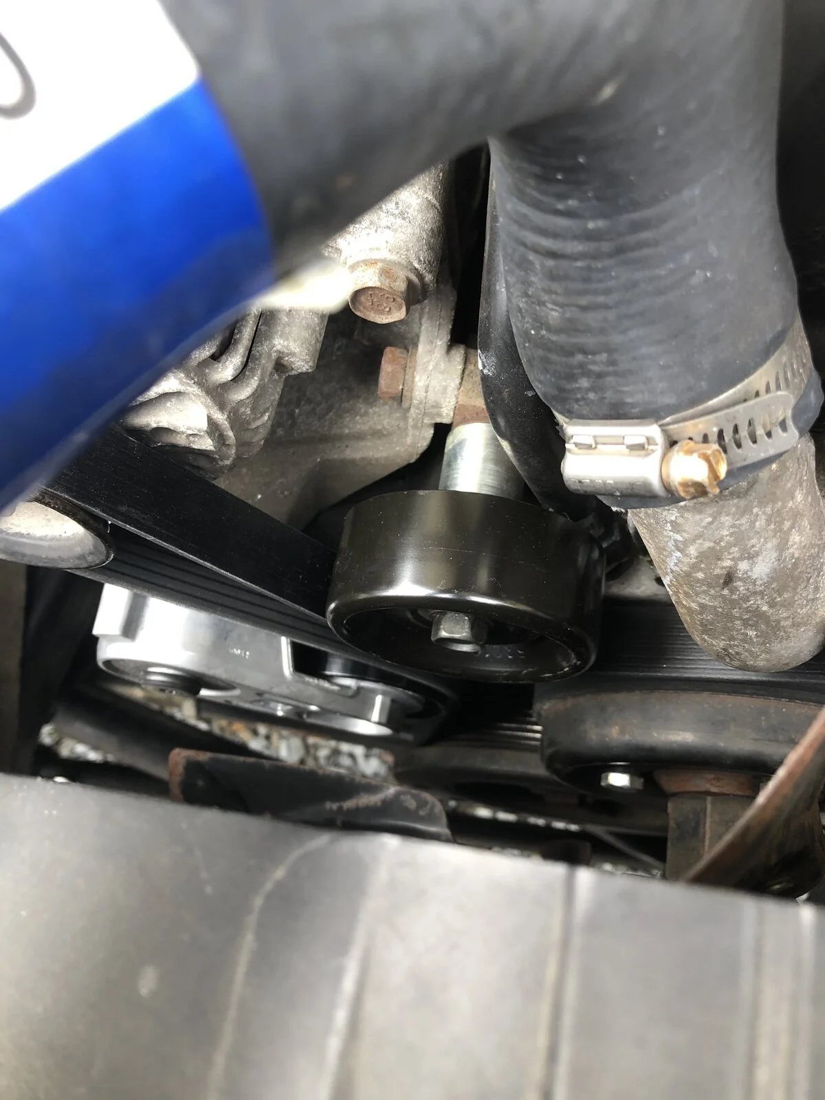

New tensioner, idler and belt. Nice and easy.

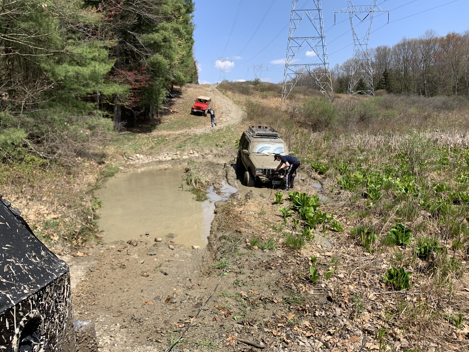

Ben and I took Lucis Yj and LJ off the pavement today. Mike came with his Xj. Good times for all. This sailor son of mine is really enjoying his leave.

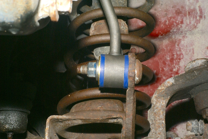

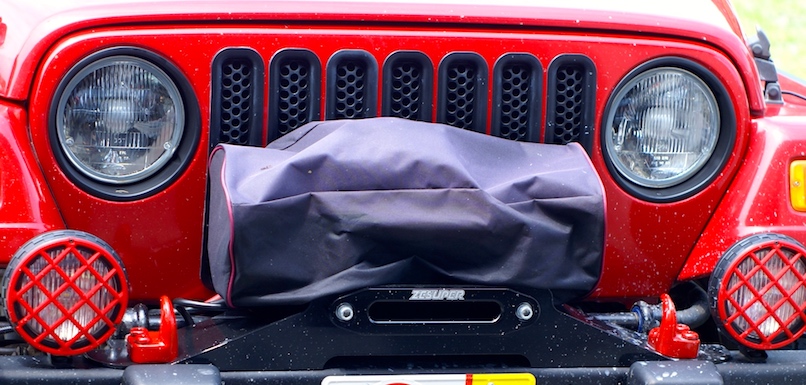

Replaced the front swaybar links and added "eye liner":
The passenger's side swaybar link had been changed out once before, and wasn't any more than "the usual problem" to get changed once I procured an 18mm (!!) combination wrench. Who uses 18mm hardware? Nobody but Jeep I guess!
However, the driver's side link was apparently OEM, and I didn't think I was going to be able to get it off. Long story short: I ended up Sawz-all-ing it short, then MANY attempts with a puller that failed miserably, beating on it with a BFH, heating it with a propane torch, cussing at it roundly, and it was STILL stuck. I was beginning to think that I was going to have to pull the winch back off, remove the swaybar from the Jeep and take it to a shop with a hydraulic press to get the remnant of the old swaybar link pressed out of it. It FINALLY popped free, but soundly kicked my ass!
But even then, the battle wasn't over. When installing the new one - with new nut but re-used OEM bolt - the nut and bolt wouldn't tighten up all the way, it felt like it was starting to gall. So I had to disassemble it again, treat with "Never-Seez", then the re-assy went well enough. On to the lower control arm replacements after I get some 21mm wrenches!
