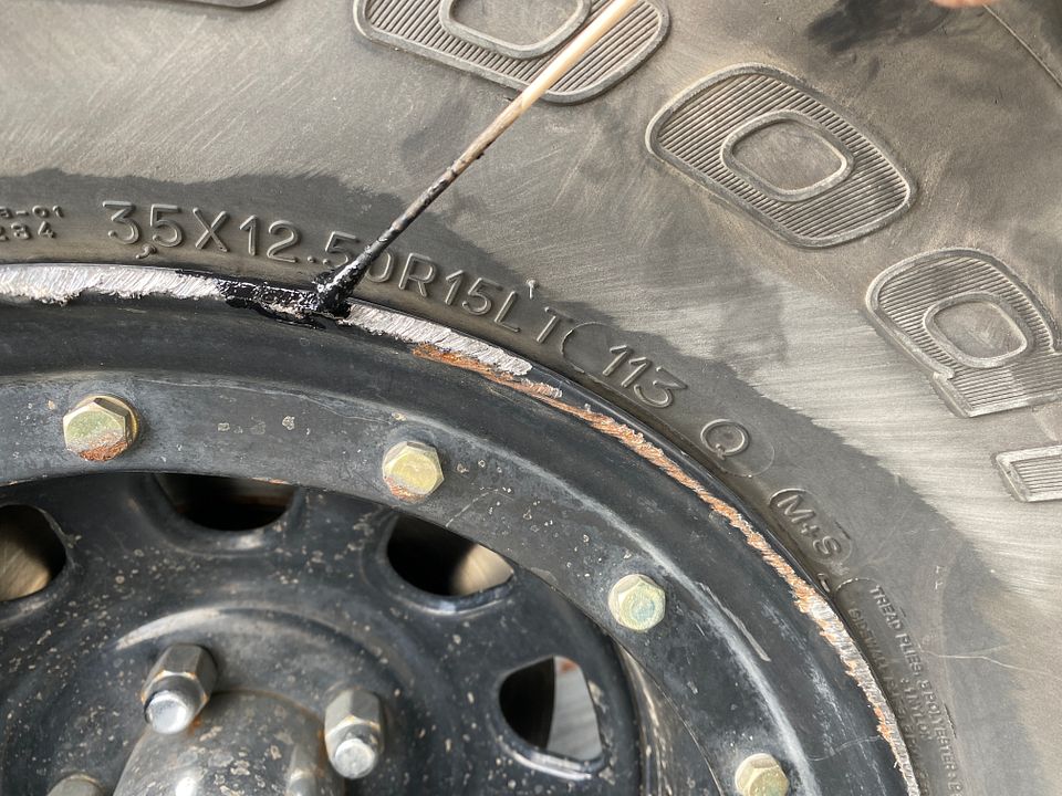

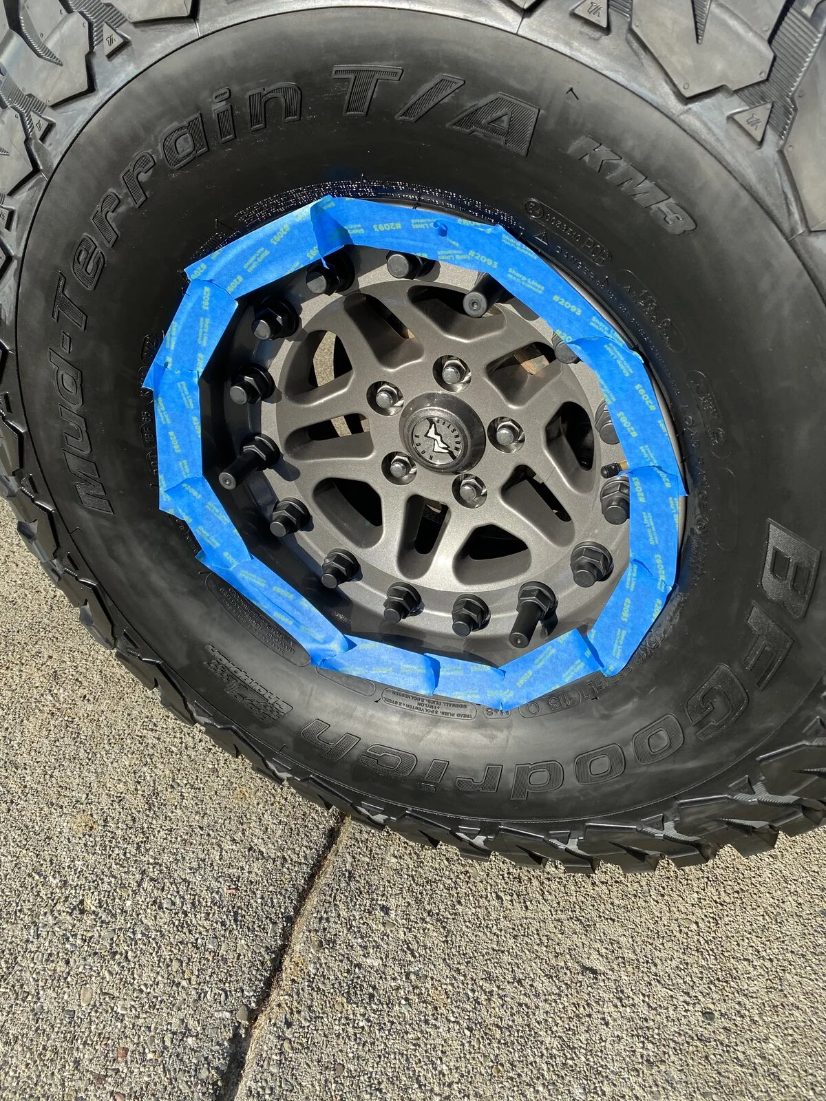

This is my plan to protect my new wheels, just some blue painters tapeTouched up some rock rash. If I am ever going to trade boogieman for his rig, I need to keep mine in good shape.....

Did you use the generic or name brand? I could if used some this weekend.
3MDid you use the generic or name brand? I could if used some this weekend.

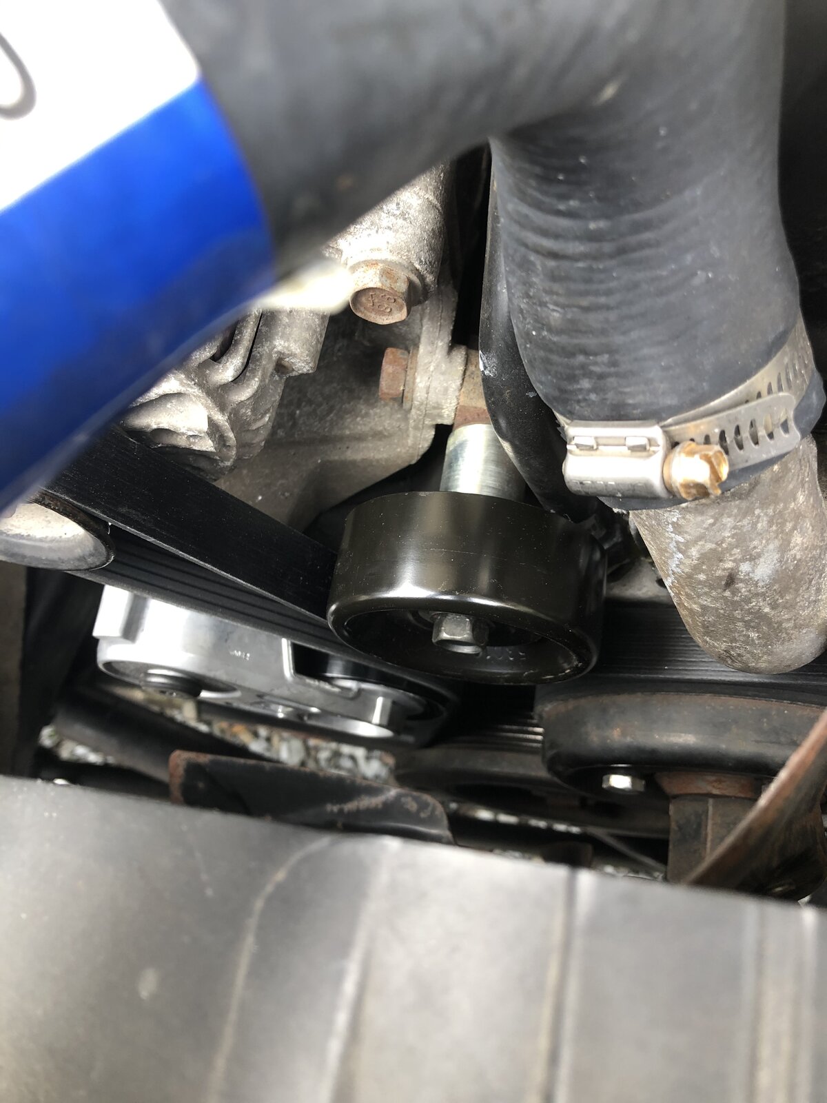

What brand, where did you get the parts? I want to do the same and hear " this won't fit", don't buy this". Thanks!
Rockauto. Mopar tensioner and idler and a Gates belt. I think they were the cheapest even with shipping.What brand, where did you get the parts? I want to do the same and hear " this won't fit", don't buy this". Thanks!

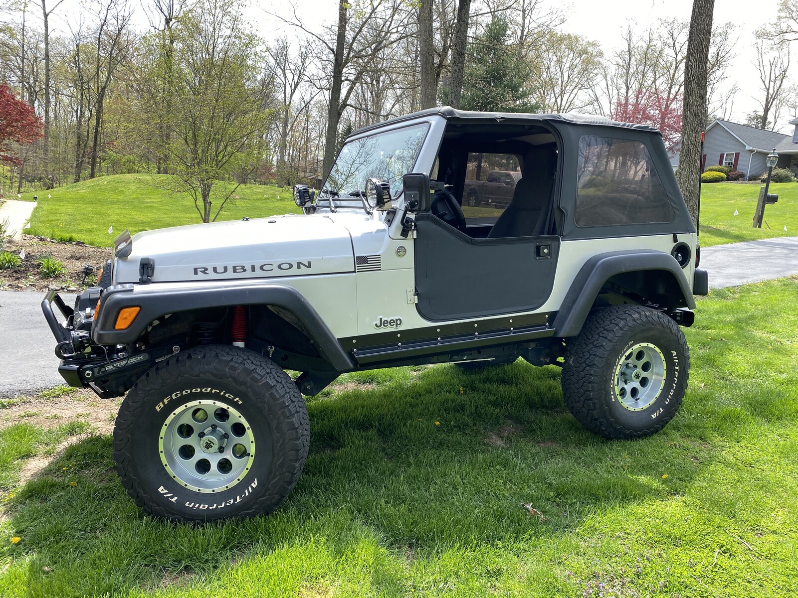

Too coward to do this. 45 minute commute, departing at 450am.Pulled the doors off and drove to work, it's was a little chilly , but well worth it!!
I have 3.25 plus 1.25 b/l on 35 mtzRockjock 4", 1.25" BL, 33" tires

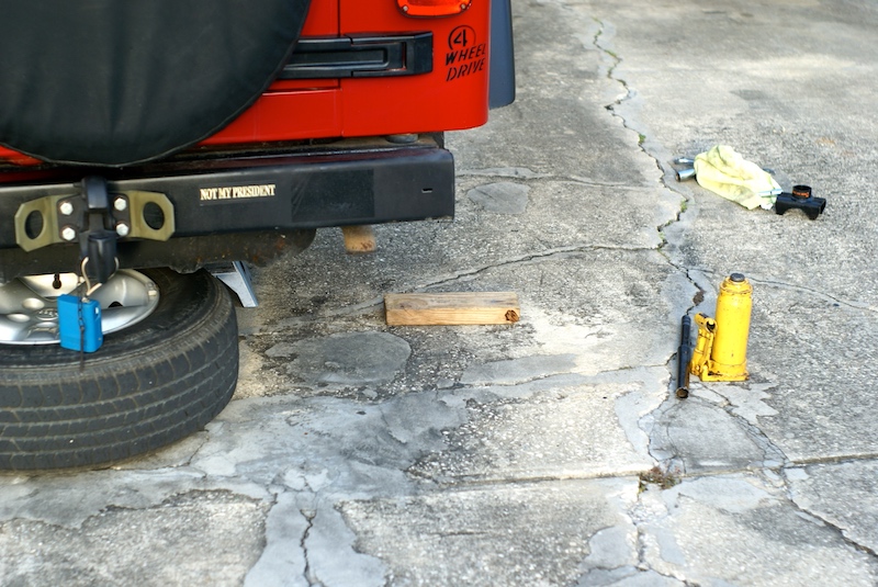

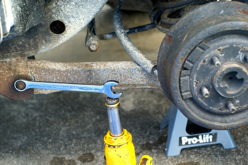

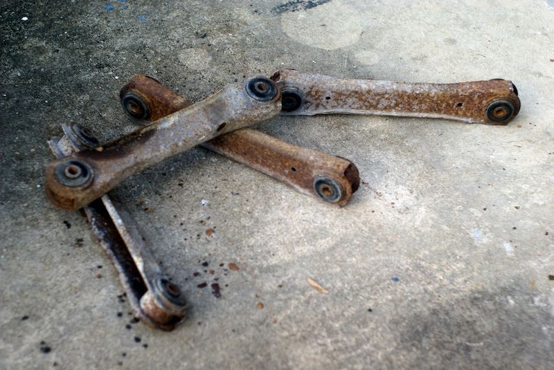

Would never have thunk it. genius on the Jack as a tool to loosen bolts.Replaced all 4 lower control arms. Didn't even remove the wheels on the front, but had to on the rear:
One of my favorite tricks for loosening very tight bolts:

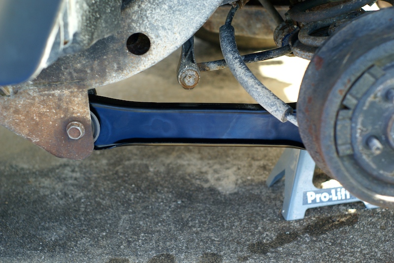

New arm:
Pile of old ones, off to the recycle bin they go:
Its amazing what you can do with a hydraulic jack!Would never have thunk it. genius on the Jack as a tool to loosen bolts.
