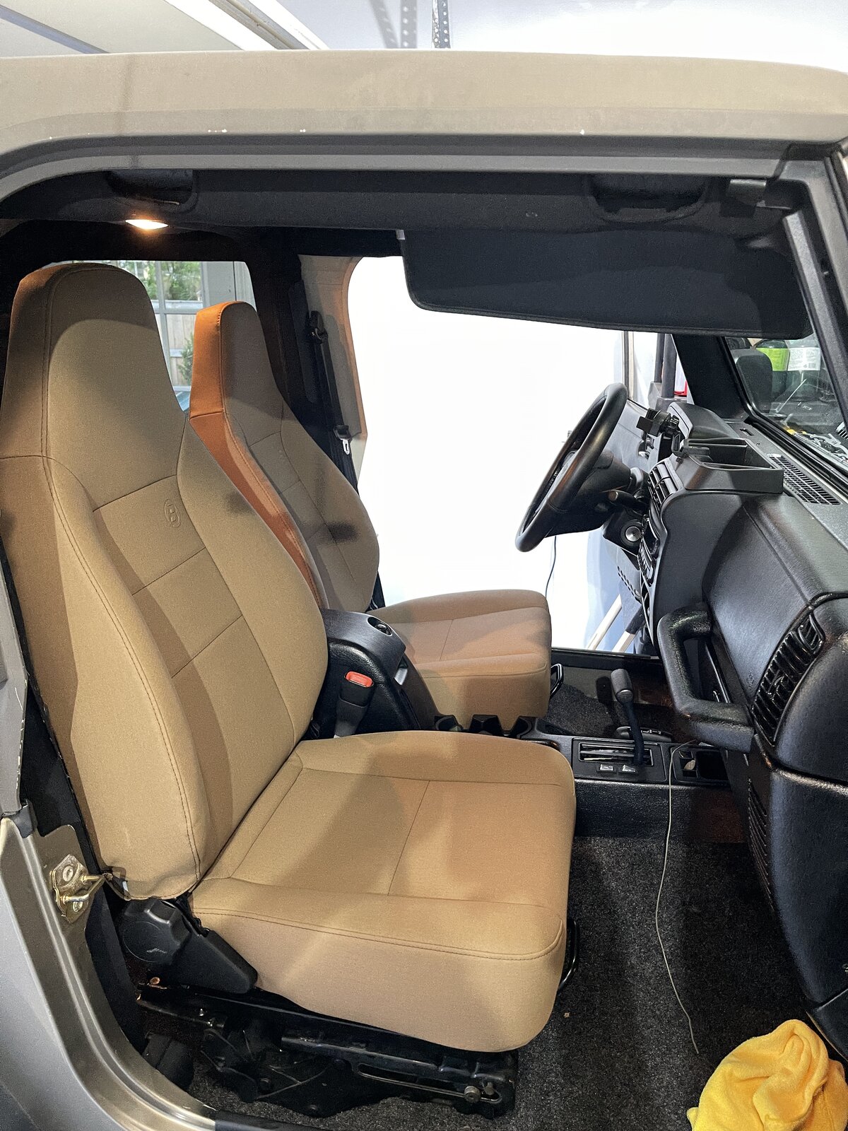

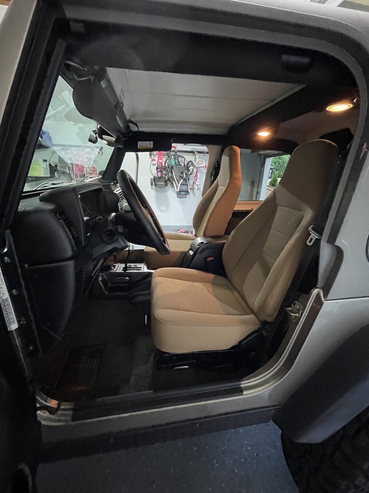

New Bestop seats went in today. Sit about 2 inches higher but work well.

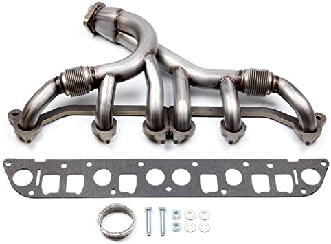

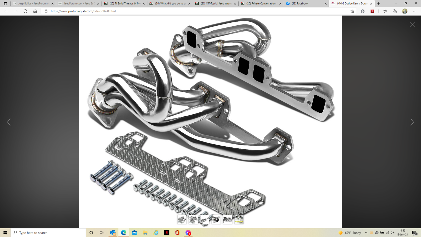

I've been wanting to find out of any of the shorty headers would work in a TJ frame and got lucky when someone posted in one of the FB magnum V-8 groups I belong to about these headers for a really great price. Even if I DON'T run these I can use them for mock up as I figure out my exhaust. Currently I have a pair of block hugger headers.
https://www.protuninglab.com/hds-dr96v8.html
They're suppose to be here tomorrow so we'll see.

How do these compare to the factory seats? Are they noticeably more comfy or more of a anesthetics thing? They look great!
they are a bit firmer and about 2 inches higher because of adapter. I’m 5’ 11” and still have headroom in car.
I assume they will loosen up a little. However you lose the fold up function for passenger seat.
I went with the trail max sport model which is middle of the line.

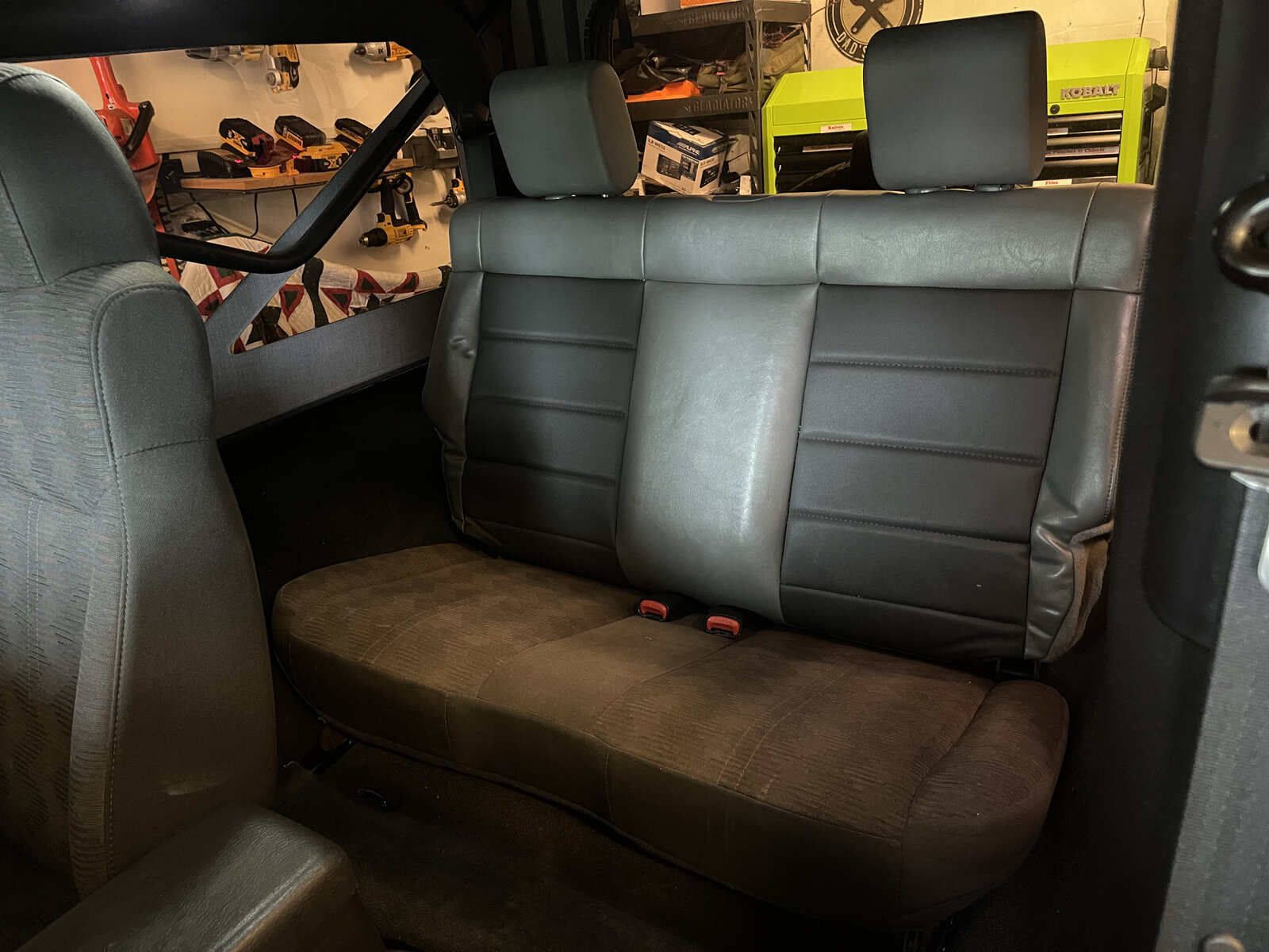

Put in my new to me seat with the JK back rest and headrests. Can’t sit to call Bartact on Monday and explain I need a TJ lower and JK upper for my backseat cover 😂
That's pretty cool. I didn't know the JK seat back would fit on the TJ seat. Was is hard to get them together?
