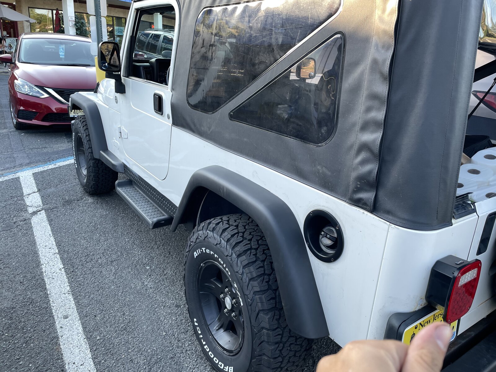

PO had oversized flares on the vehicle that had to go. Removed them - took a ridiculous hour and a half of cursing and wrenching.
Too dark to put new OEM flares on. Still can’t believe how long that took.
Installed the OEM flares today. More cursing. More wrenching. My hands hurt, but she looks much better. Anyone need oversized flares?

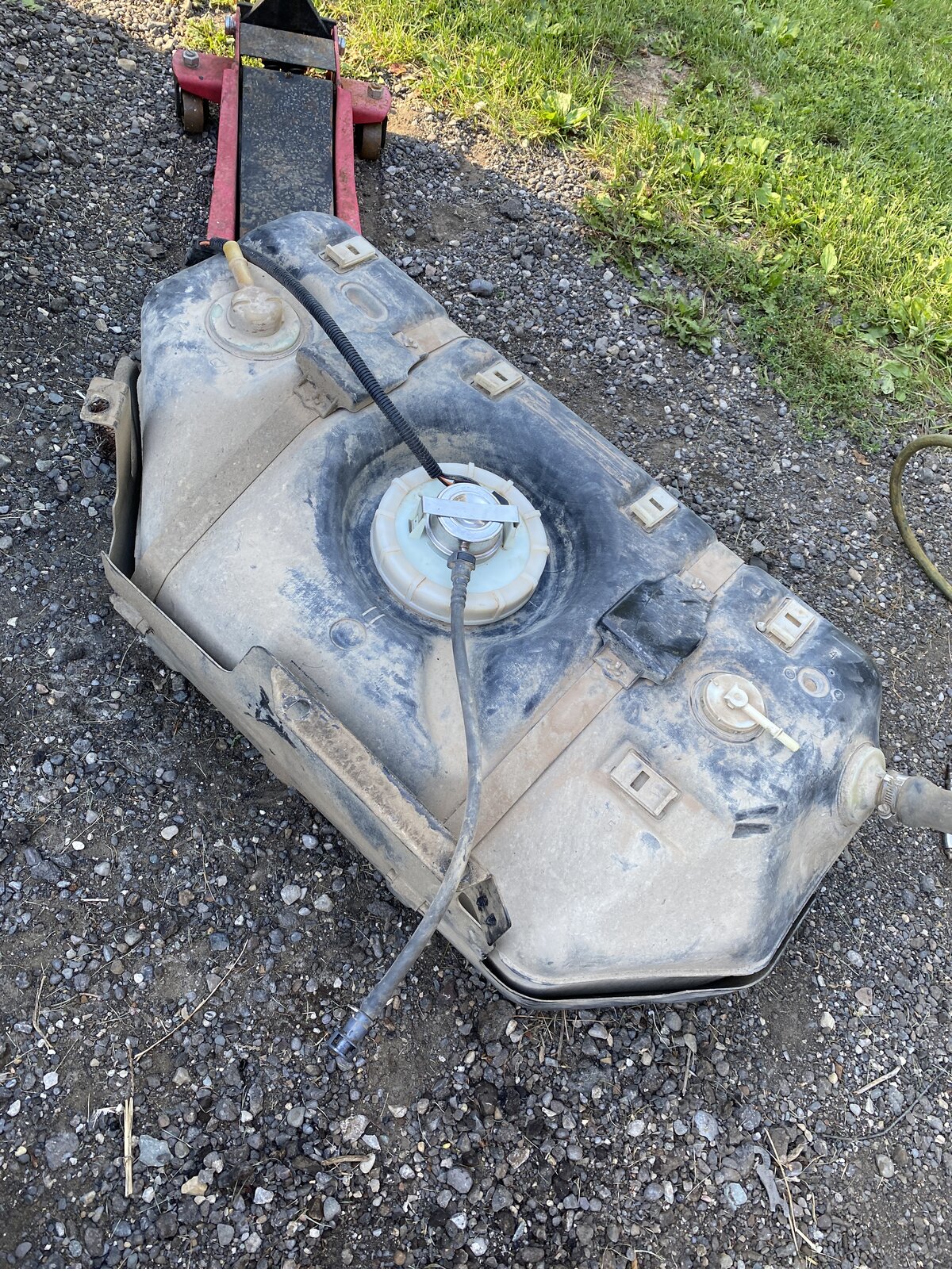

Dropped the tank in preparation for the arrival of the new Bosch fuel pump tomorrow... hopefully tomorrow.
the 4 week old Delphi DFG1221 pump took a crap already. This is the 3rd time ive dropped the tank replacing pumps, Delphi is not worthy of purchasing for the tj at least I dont care if it comes with a lifetime warranty. Im fed up with dropping the tank even though its fairly easy and about a 20 minute job. I want reliability, not questionability.
Pulled the pump out and took it back to auto zone and had them warranty it out... mainly just because F Delphi, they can pay for this ones warranty too. tossed the new pump up in the rafters of the garage in my parts storage.
It does look a whole lot better... and glad to see you have you Toilet paper, coz you never know haha
