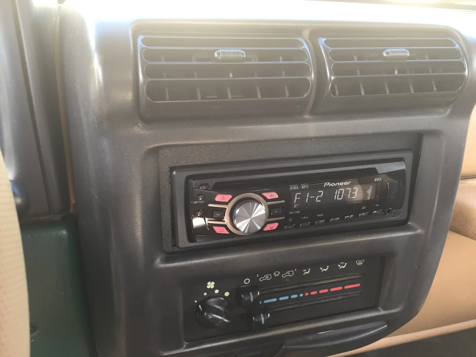

Installed a stereo today. I had never done it before. It didn't take that long either. Maybe 1.5 hours. I can't get the back speakers to work and the fronts are garbled. I'm sure I need new fronts. Not sure what's going on with the back speakers. Still, nice to have tunes after two years of ownership.

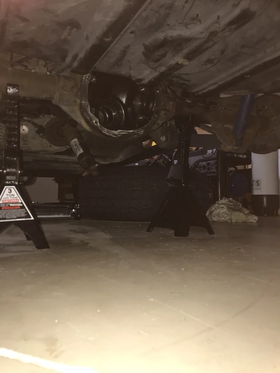

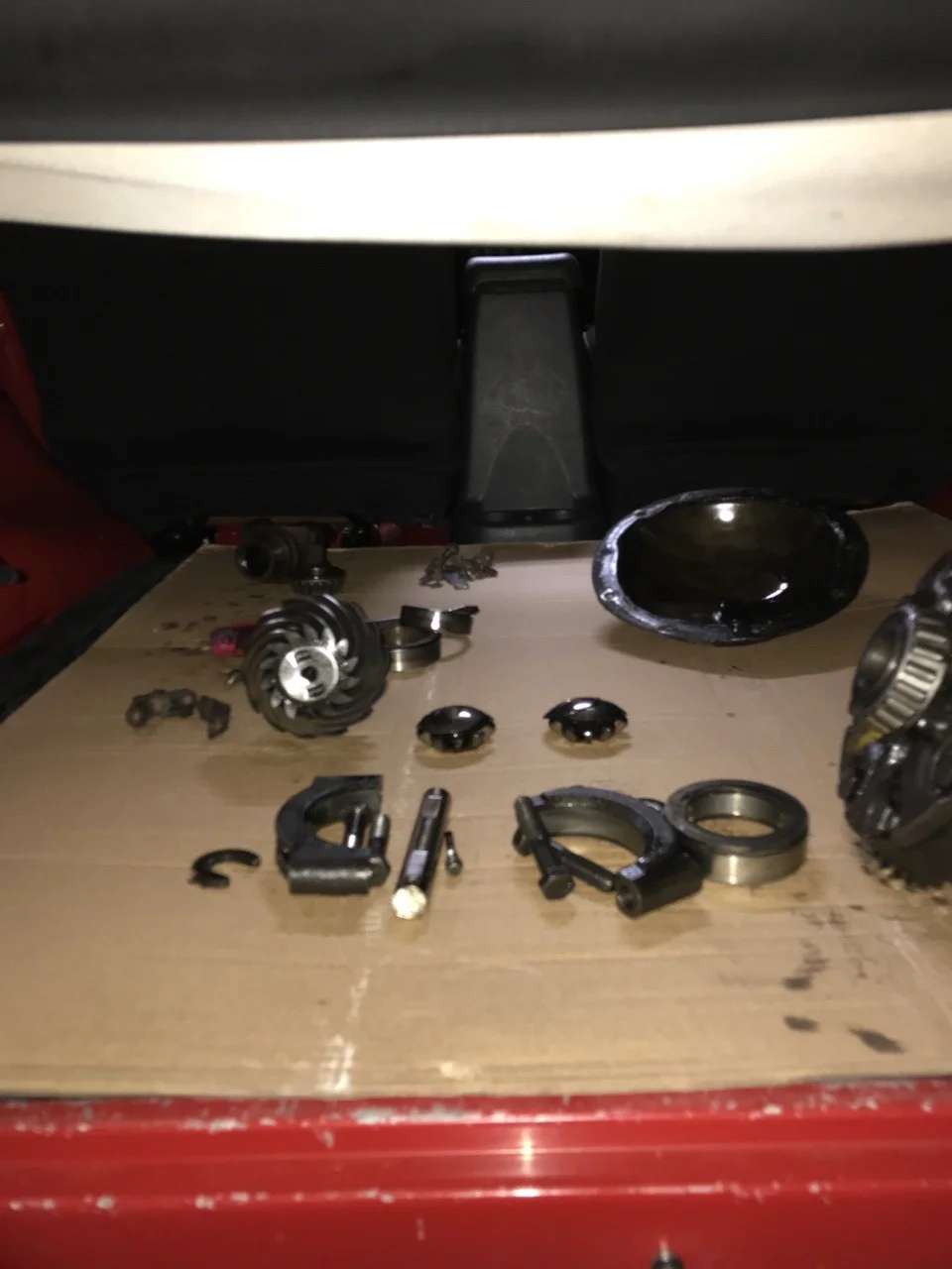

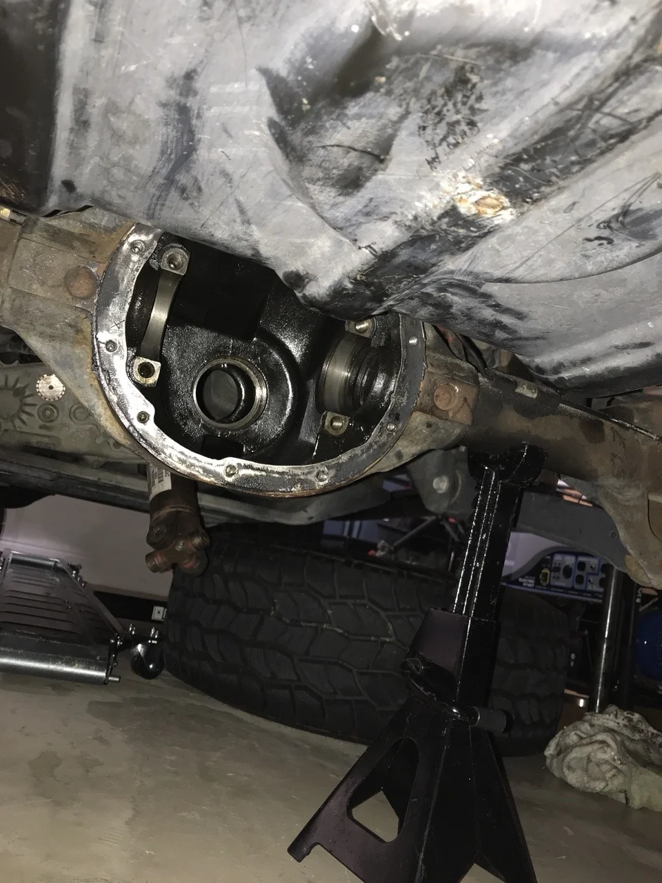

Started regear and locker.
So after reading the write up about how to regear... I have a couple of questions if anyone can answer.
1. The pinion had no shims or washers. Wondering why? How to showed their should have been as well as a washer for oil.
2. Shims on either side off carrier. There was only one on each side that appeared to be same thickness. I’ll measure soon. Curious why? I was expecting multiple thin thicknesses that I would have to measure.
Dana 35. Rear
Going from 3.07 to 4.10 with a truetrac in rear

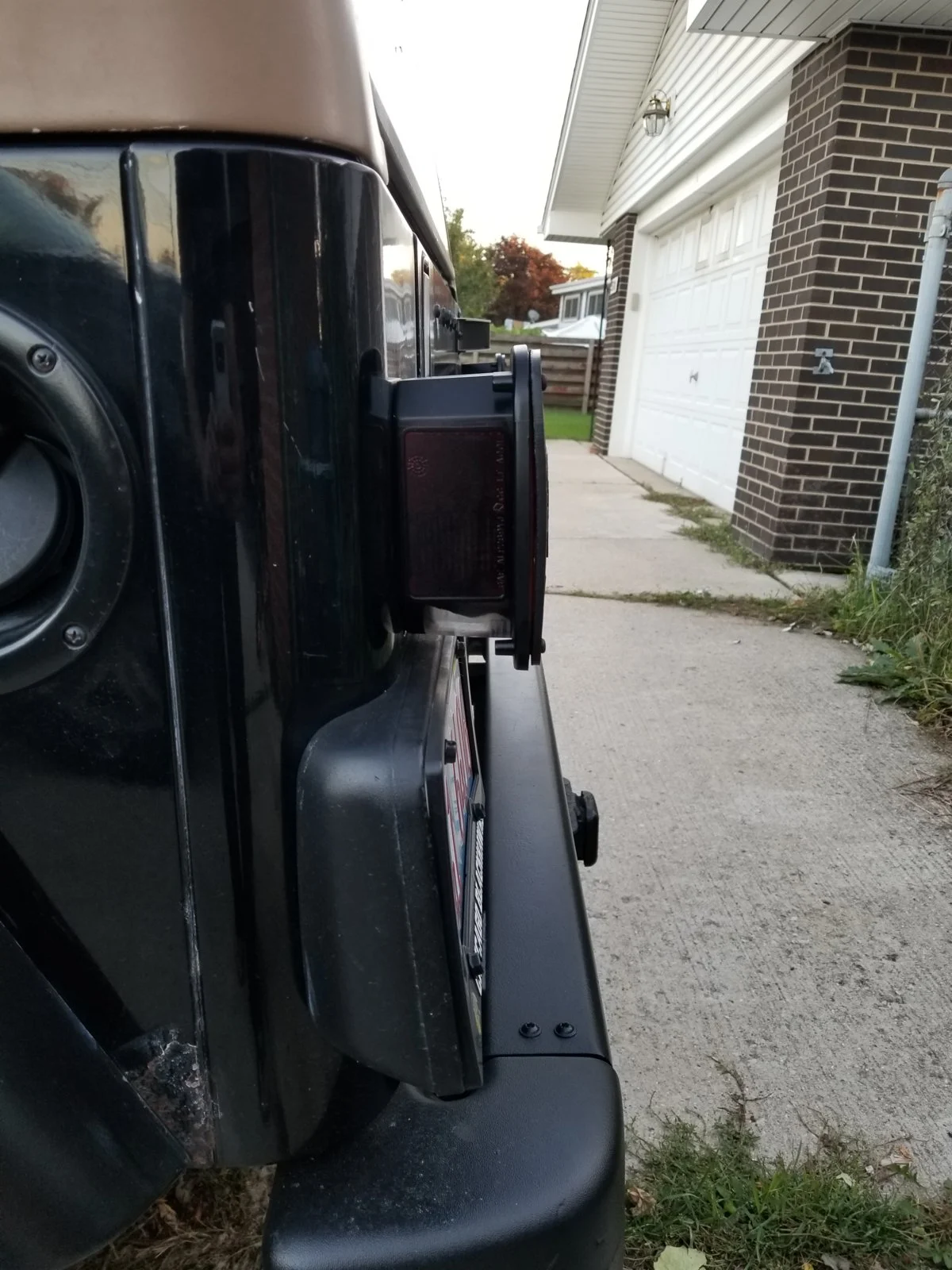

Was bored and wanted something to do, so I tinted tail light reflectors with a few coats of VHT night shade. I dig the outcome.
Dana 35. Rear
The pinion depth shim is under the rear bearing. You need to pull that bearing and use the shim as a starting point. There isn't always an oil slinger. If there is, it needs to be reused as it adds to the pinion depth. The carrier shims may look the same thickness but aren't. When you measure you will see. Those are only a starting point as well. You will need a variety of shims or a multi shim style to get carrier preload and backlash correct.
