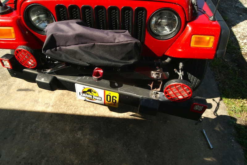

Tightened a bolt... ;)
Going back to the steering box skid - the third bolt that you have to drill a hole for: Its kinda hard to tighten it up yet have the skid in the perfectly correct position for the other two. So - I removed most of the bolts holding the bumper on, and hinged it outward. Put the appropriate sized wrench (15mm) on the nut on the inside of the bumper, closed the bumper back up, and re-installed the other two bolts. There, now the skid is in position. Tightened the 3rd bolt, letting the wrench inside the bumper rotate to the forward side and hold the damn nut. Remove the other two, hinge the bumper back open, remove the wrench from the inside, then re-assemble the whole mess.
I hadn't yet figured it out yesterday so the bolt was snug but not tite, but it came to me last nite how to do it. Thank you guardian angel!
