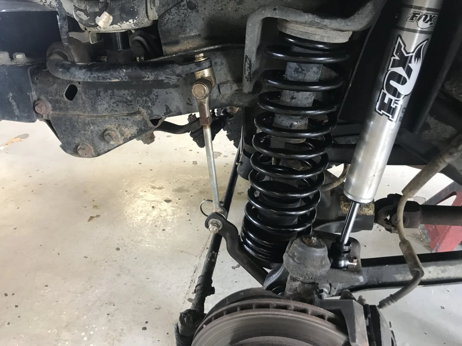

Got Stinger back. It has air! Air conditioning that is. Mac's Radiator in Bend did the plumbing. Cascade Auto Electric wired it. Again Mac's evacuated the unit and charged it. 39 degrees at the vent. Oh ya baby.:D
I may have to add a pusher fan. When I brought it home I was told to manually turn on the fan when using the AC. I did that and it still made the engine run warmer than I would like.:(
It looked like an easy job to wire it however I had three sets of instructions-- two from Novak, and the factory service manual. None agreed with the other hence letting the pros do it.
However for now I am focused on fabricating skid plates for the engine and tranny. Not a lot of hard points on which to mount these!:(

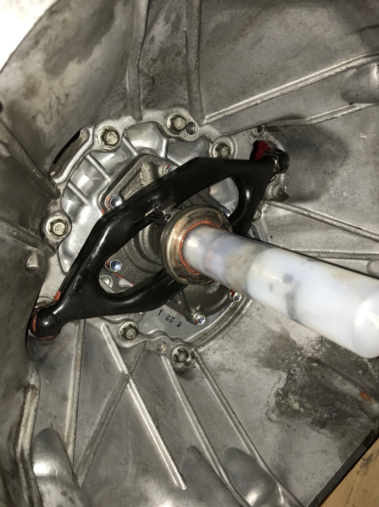

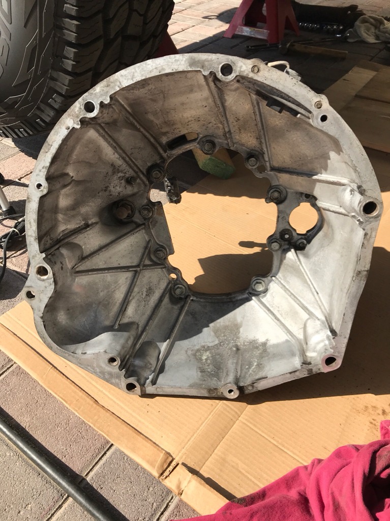

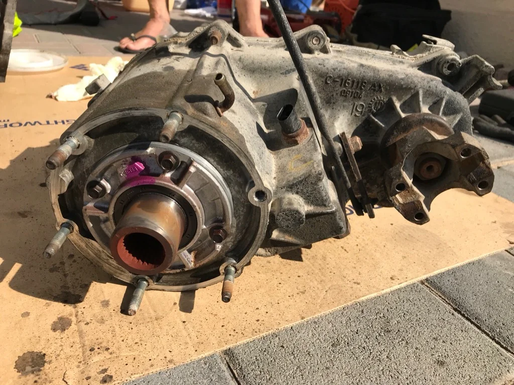

Removed noisy / binding NV3550

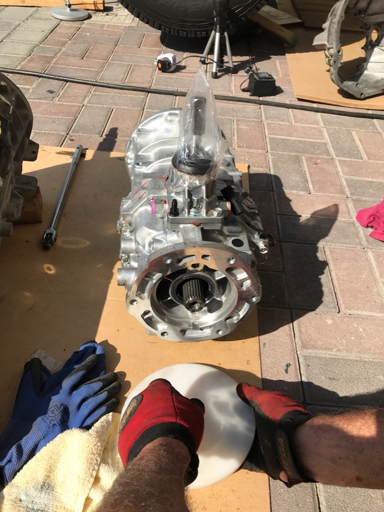

Comparing NV3550 to Aisin Warner AX15 from Novak
Had to swap input shaft with shorter one from Novak
Borla header was cracked so went to swap in this one....didn’t fit [emoji52]

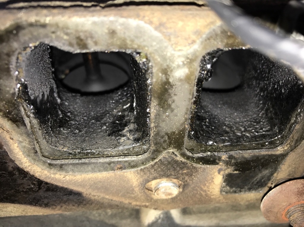

Inlet ports looked a bit gummy but otherwise ok
New shaft bent close to stock shape
And tunnel clearanced
Boot refitted
Gearbox filled with MT-90 and ATF for transfer case. Any idea how long a break in is for a new transmission?

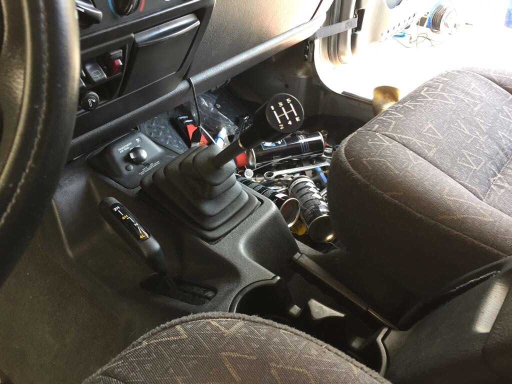

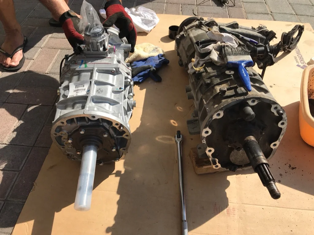

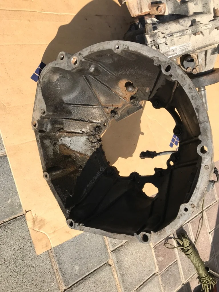

View attachment 26231View attachment 26232

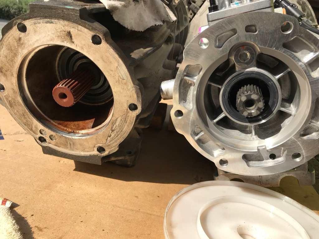

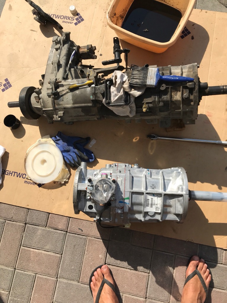

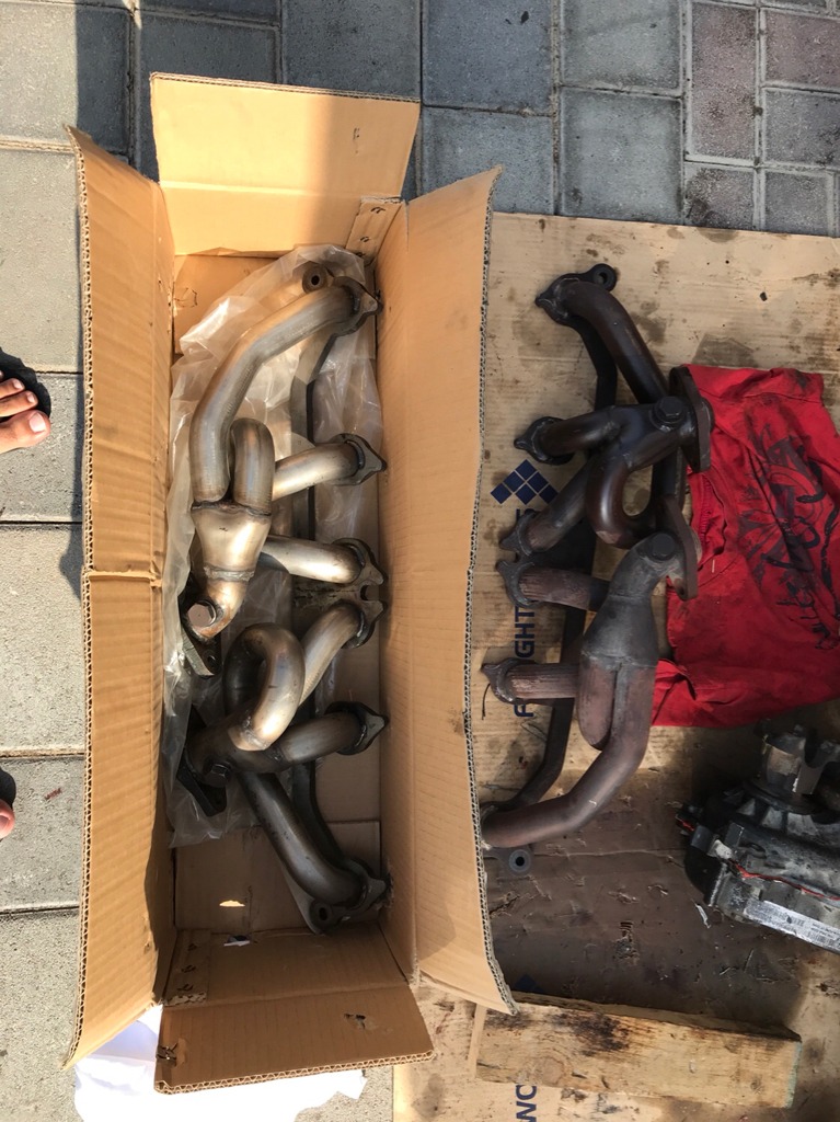

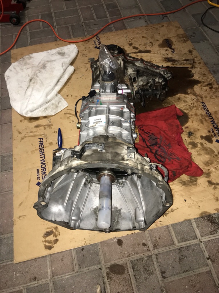

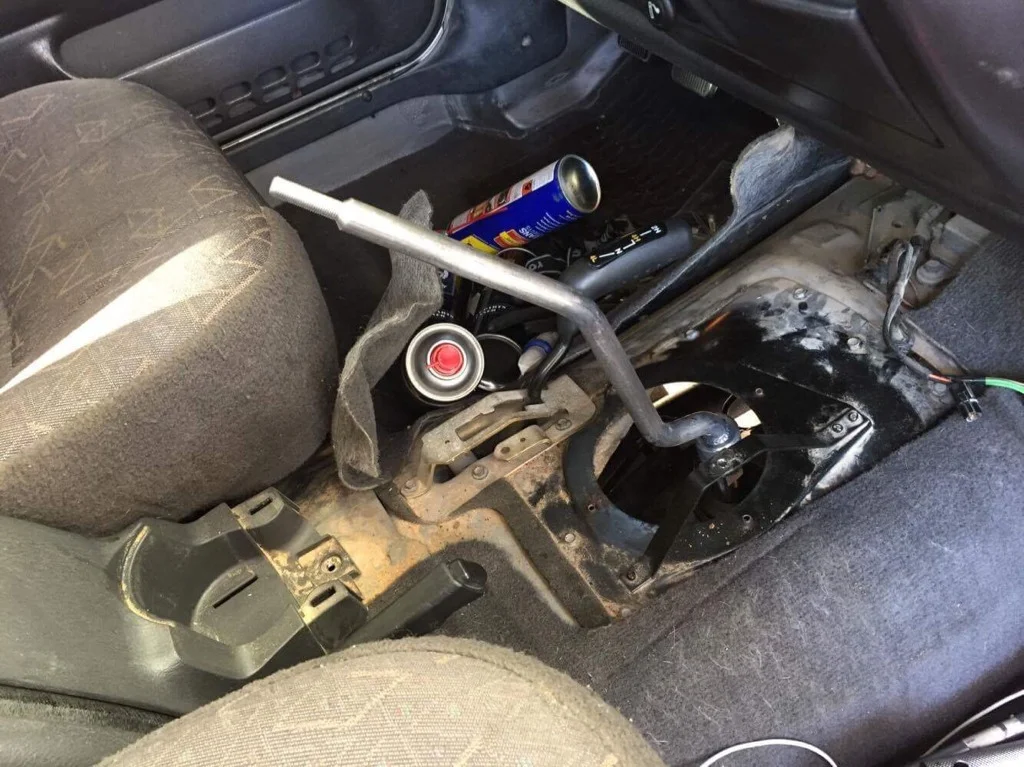

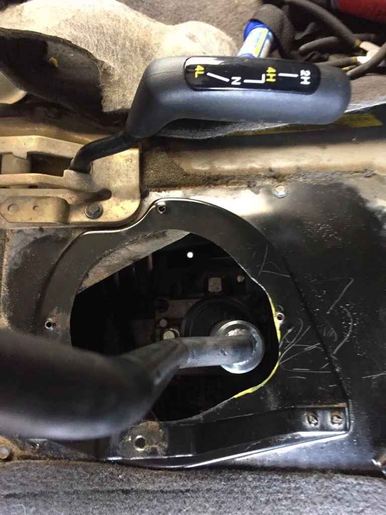

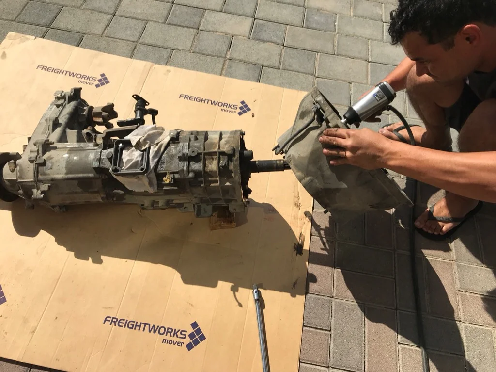

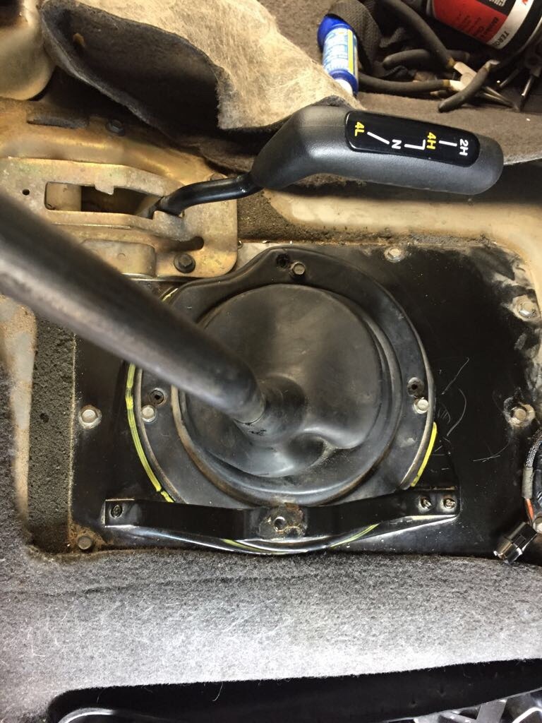

Boot refitted
Nice work! And lots of it!

What did you do about the cracked borla header?

So how does it compare and what kind of money are we looking at?
I havent driven it but watch this space! 1600 USD for brand new box and input shaft for nv231 plus fab work for bending the selector and new fluids. They offer a new transfer case linkage cable system if you have issues with higher lift but I didn’t need it for my 3.5” rough country setup.
