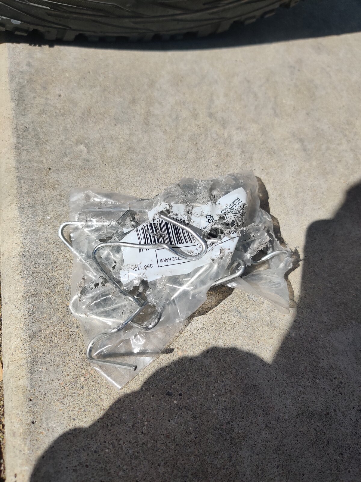

Ran over this sh!t in front of my house. There goes a thousand dollars. My tires were bad and I needed new ones anyway but I was holding out as long as possible because i'm not ready for a lift and bigger tires yet so 30" BFG k02s it is I guess. $183/ea Coming from Cooper Discover AT3's
T post clips?
Looks like that bag of metal did you a favor lol

T post clips?
Yep. Felt it when I was backing into my driveway. Thought I broke an axle or something at first.
lol ya, I was trying to hold out a little longer.
However, the tire didn't go flat yet *knock on wood*. Gonna see what its doing in the morning. Chris made me a pretty good offer on some used K02's. I think I might go new anyway just for the warranty etc... Just sucks because within the year I planned on doing lift and 33's

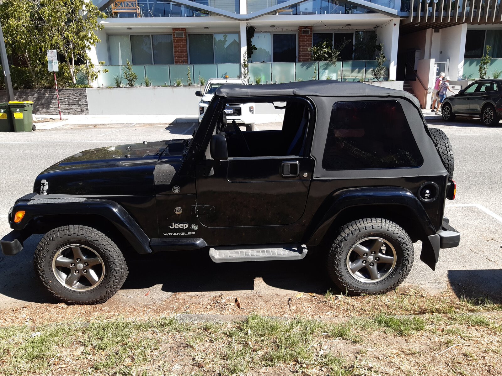

Put my Rampage bowless on today, took 3hours from box to on including removing Bikini and Tonneau cover plus a few sunrider bits from my door surrounds , no instructions whatsoever :( had to use utube for a few bits.
Surprised its not as fastback as I thought and these tops really are not made for jeeps with sound bars as the top looks lumpy at the sound bar.
Never try and put one of these tops on with the mesh sunshade still on! Took me at least an hour to get the centre tightening strap in the buckle under the mesh one handed blind lol
it'd look about the same without a sound bar due to the roll bar
The sound bar shape makes it lumpy looking but I am not used to soft tops so perhaps all the bowless look like that?
Anyway took it for a drive with both door windows open and it doesn't flap much, a little bit more at 100kph but I can easily live with it.

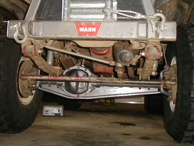

So what happened on my cj5 is the long side tube actually stretched the collar entering the diff housing. It had vertical movement which affected the meshing of the locker teeth. I could hear the slippage and the locker acted like an open diff. Fixed it with a homemade truss.
The easiest way to tell is place a jack under the pumpkin and watch for the slightest movement where the tube enters the pumpkin.
