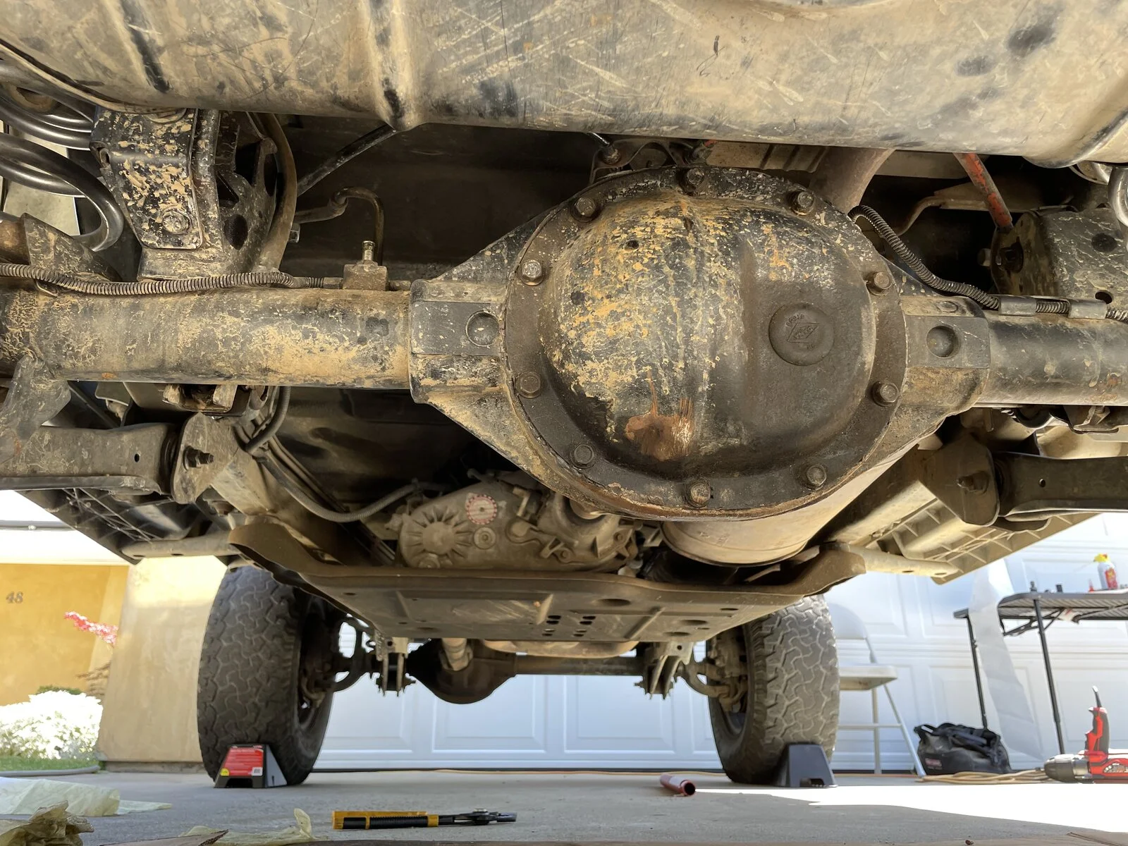

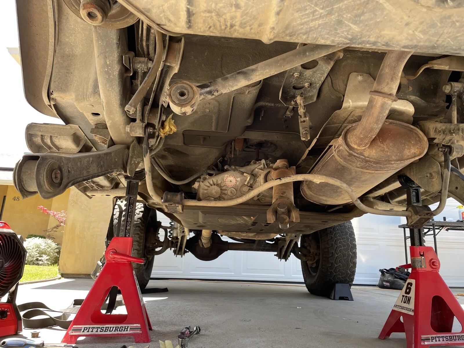

Swapped out the stock Dana 35 (3.07?) and bolted in a pre-built Dana 35 Super with 30 spline chromoly axles, 4.88’s, and a Detroit Locker.

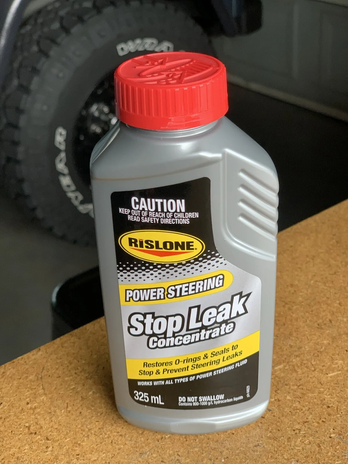

Added some of this stuff till I can afford to get my steering box leak sorted.

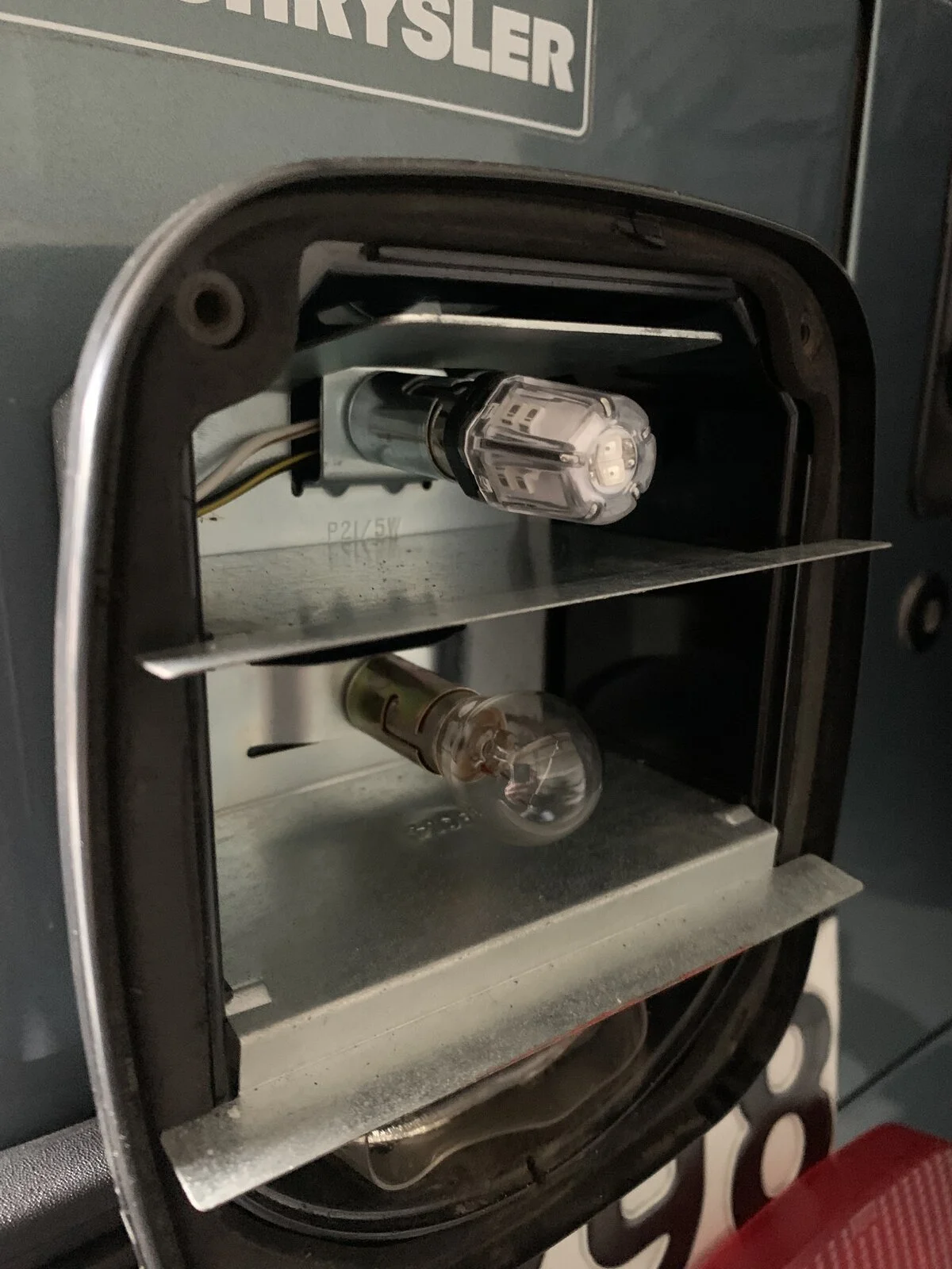

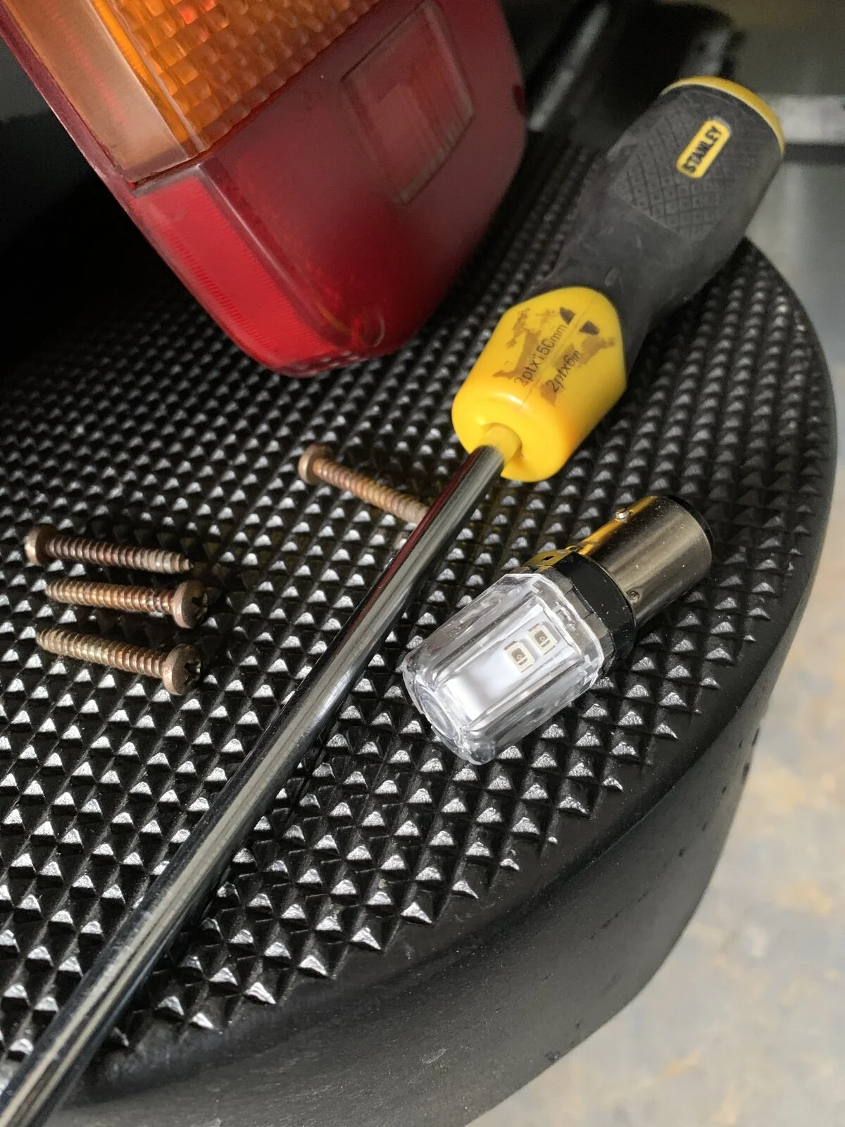

Then swapped out my regular taillight bulbs for these LED ones.. simple plug n play. Don’t trust the tailgaters here …🤔 these are so much brighter.

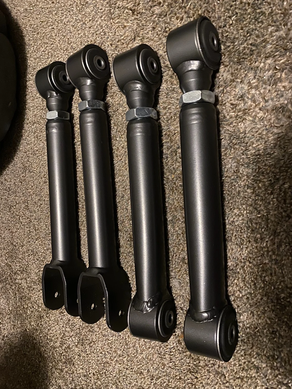

If your wheelin' involves a lot of full flex I would suggest tier3 with the jj on the adjustable end to relieve the extreme stress put on the mounts.
I agree but I am putting together a mild trail rig and I could have just stuck with the stock arms . I have a mild lift , 31 tires , putting in a SYE , Moly axles , limited slip front and rear , torsion bar front sway bar and I just wanted adjustability to be able to dial everything in. It just needs to be able to flex to ruts in the back road trails. You build things up for how you are going to use it right and it will only see rutty roads , mud puddles and creek crossings , we are in it for the scenic views and relaxing rides.

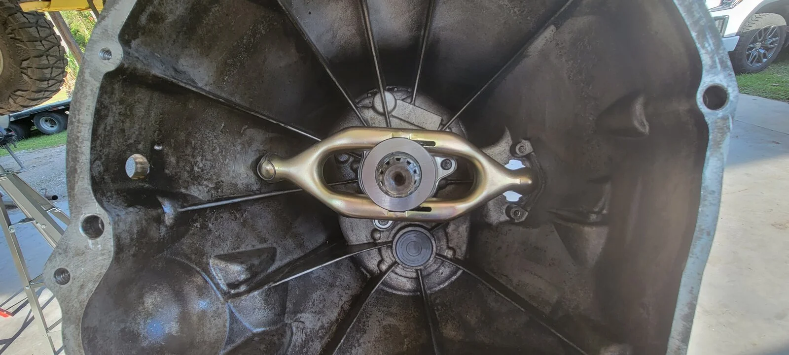

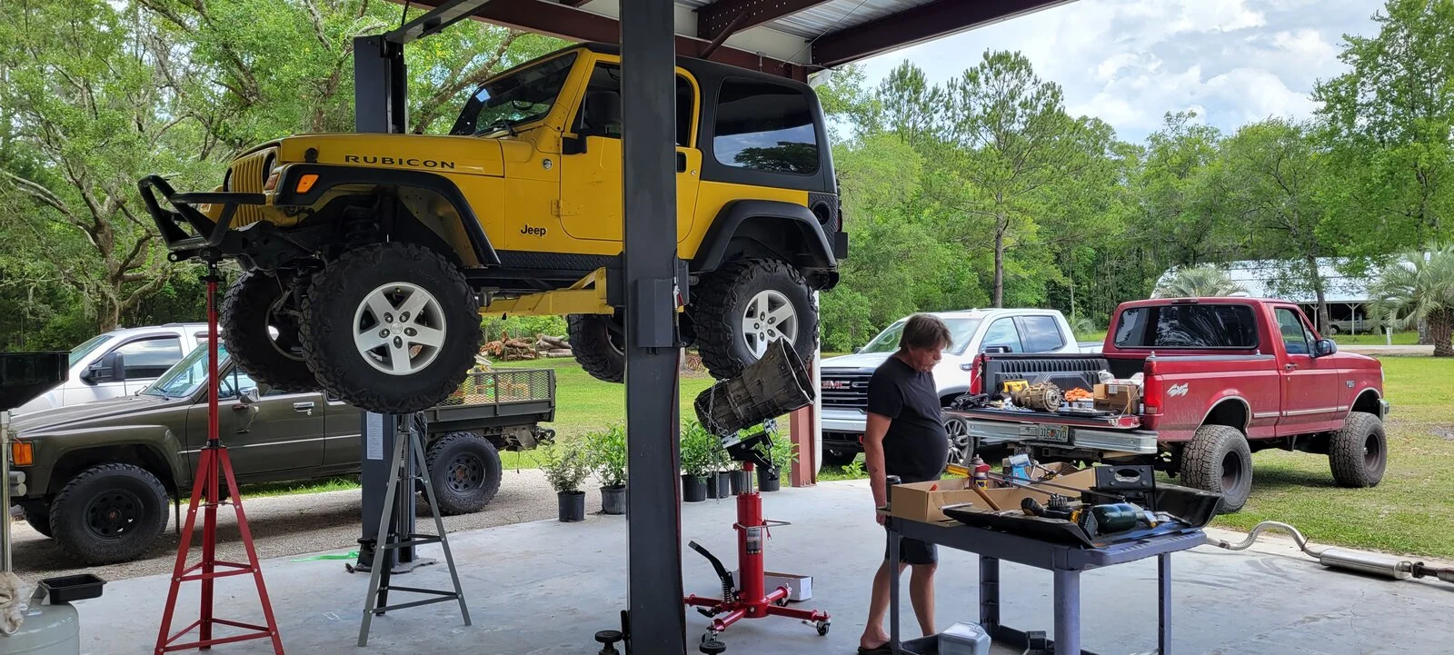

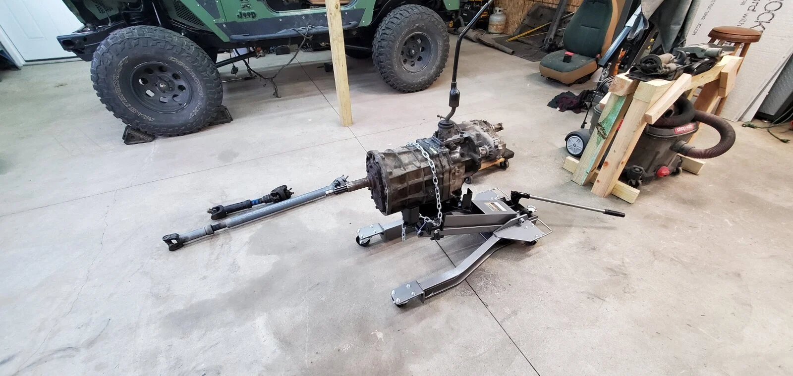

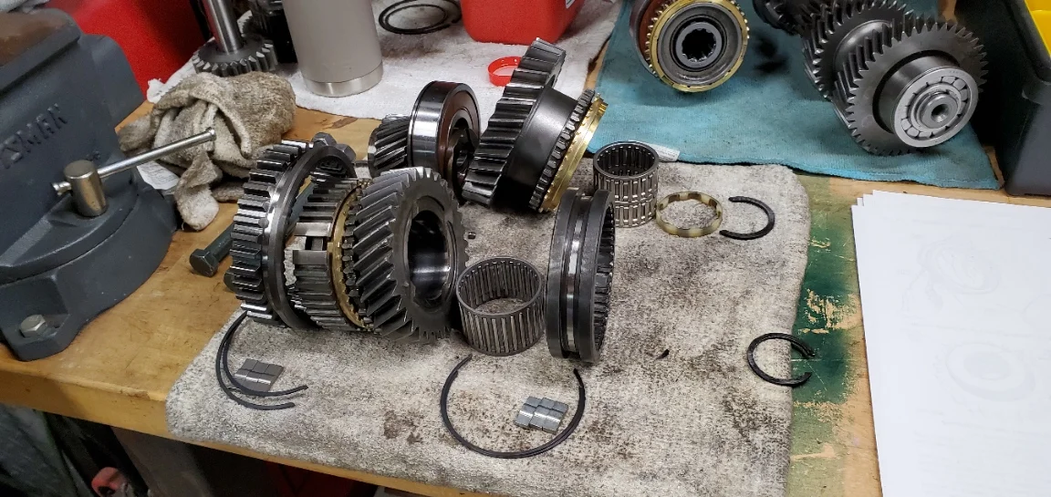

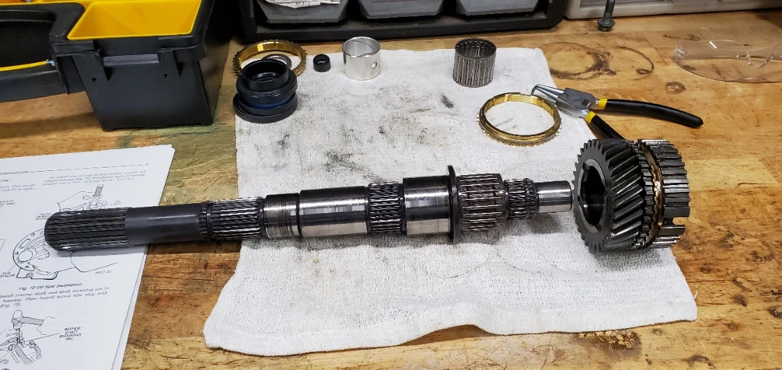

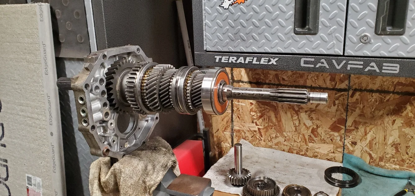

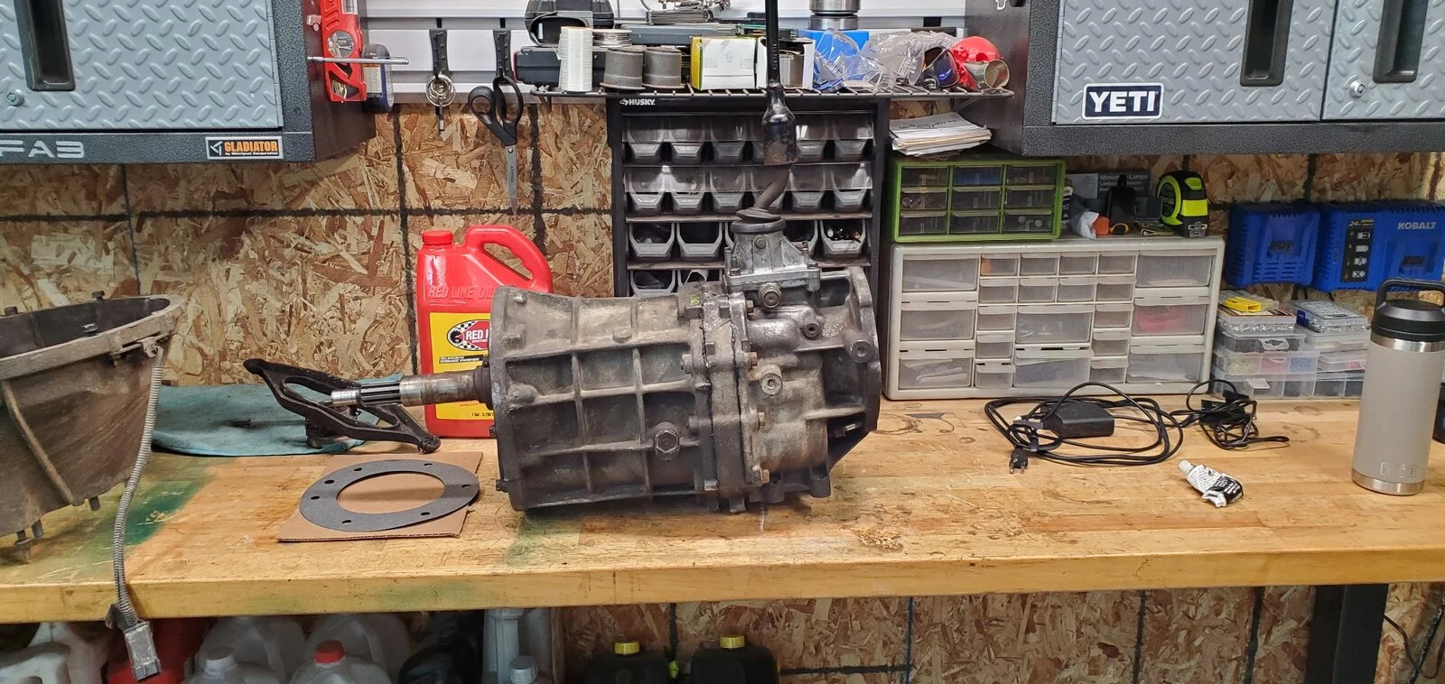

Yesterday and today I got rid of the rattle in my 2005 6 speed. Completely gone, but 45 minutes later it started stalling and I got U0155 code. I did replace crankshaft position senor while I had the transmission out because it was cracked and would not stay plugged in tight . Used Napa CSS634. Maybe the napa brand is why it's stalling.
