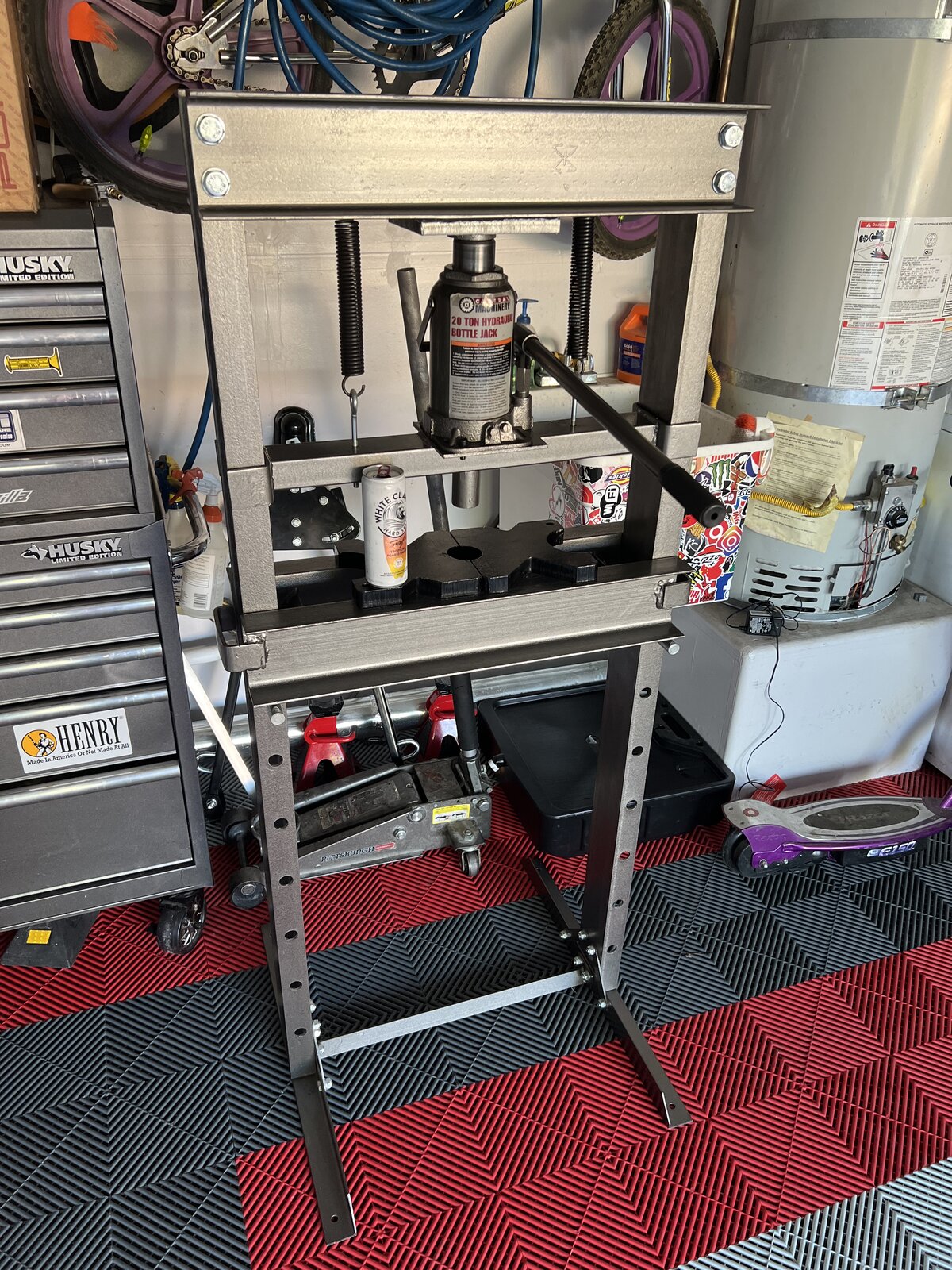

I had a bent passenger side axle shaft in the rear so I ordered replacements.
They were delivered and obviously I need to get the bearings pressed on. I could get some quotes on having it done for me.
Or……
I picked up the 12 ton press, worked well for me. other than the height was a little lower than I wanted I built a cube out of scrap 2x4's from work and bolted the press to the top of it. tolerances of the press are a little sloppy but it performed well for what it is.

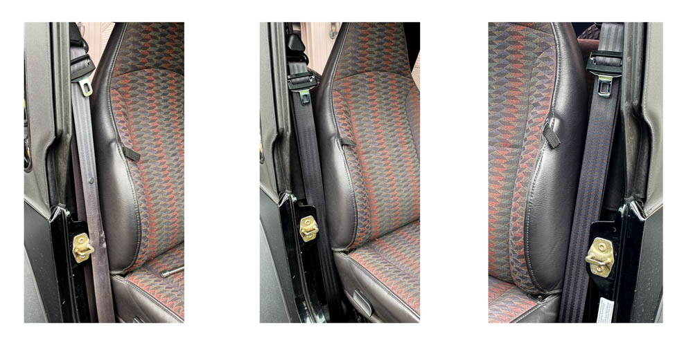

One very annoying issue with the TJ, given how old it is, is the worn out seat belts. The retractor isn't that strong and the webbing has become very soft and often folds over itself and jams in the sliding belt end. As a result the webbing often gets pinched in the door latch when closing the door.
Bought an extra set of stock seat belts with plans to have the rebuilt, but inadvertently threw them out. Bought the new set made by Seatbelt Solutions and sold by Morris4x4
Took just a few minutes to remove the old one and install the new.
They are more sensitive, as reviews have noted, and as a result lock easily when extending the webbing to latch them. And, the male end is little finicky when inserting in the female clasp. I've seen folks complain that these belts don't come with the little stopper button... they don't. But it took zero effort to transfer them from the old belts.
But they slide very easily, the retractors wind them in quickly, they look a thousand times better and they don't fold over themselves.. yet.

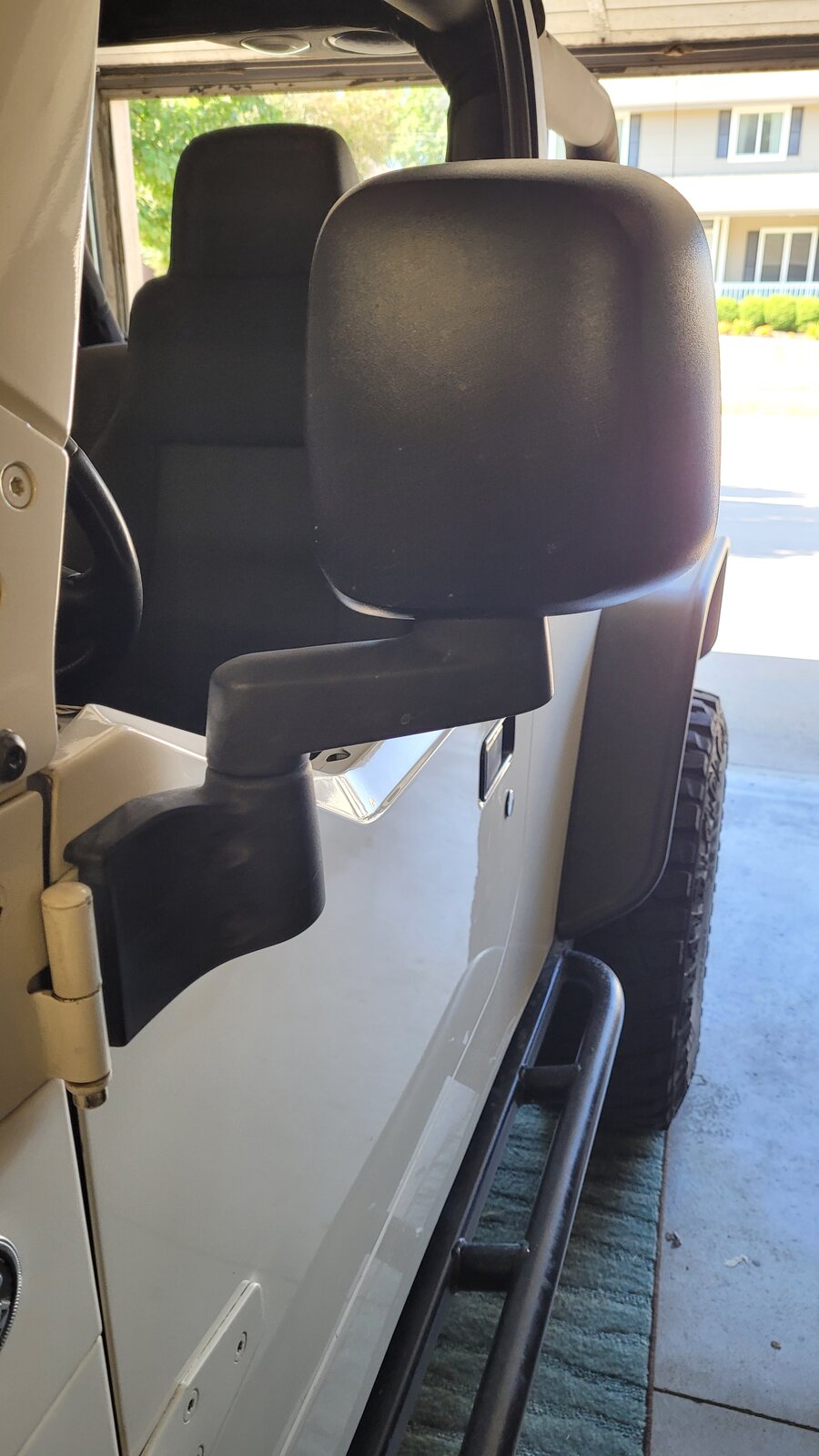

No more holes in the doors.
And if it looks like rain I can toss these on.
I also loosened the hinges and set the latches so everything opens and closes smoothly.
Now I'm going to shower and buy some rubber trim pieces, and mirrors so I don't have to swap them off my full doors.
Then list these for sale locally.

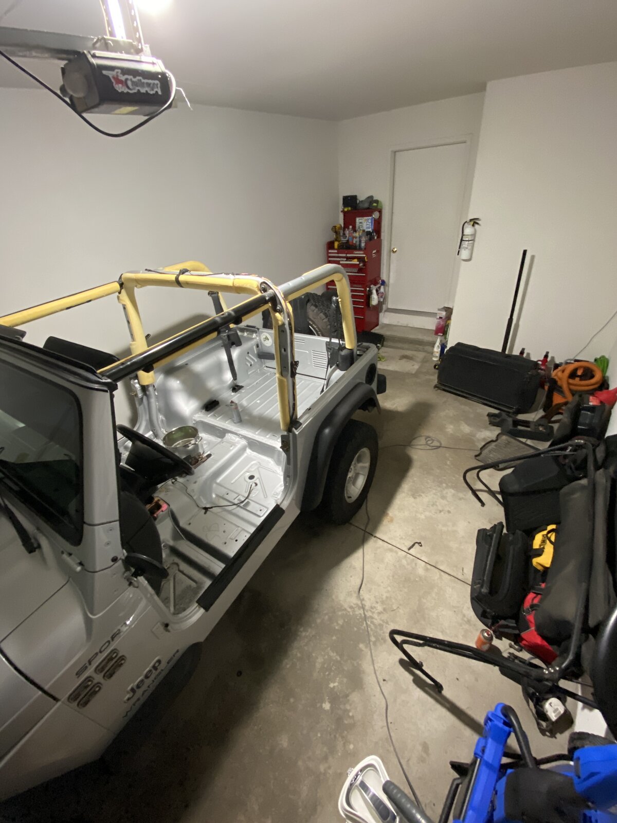

stripped the interior to clean.. in a narrow small car garage.
washed the tub with soap water, tossed the roll bar fabric in the washer with warm water and tide which cleaned up like new. reinstalled the roll bar fabric while damp. vacuumed carpet and reinstalled. cleaned the seat mounting brackets and lubed all moving parts. wiped dash and plastics with soap water. got the drivers seat back in so far. hoping to finish the work tonight.
