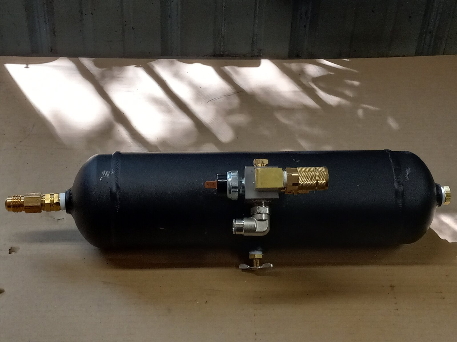

Got the bracket and york compressor installed and alternator relocated. Also installed the in cab air coupler. Getting the new serpentine belt on was a bitch. Even with the tensioner fully released the belt was tight. Took some extra colorful metaphors to get it in place.
Now I have to relocate the evap system to make room for the air tank.

I also did this 25yrs ago on my cj5. Built my own bracket then. Still used an old ac compressor. You still had to use a york oil bath style. If you use one that lubricates with the freon you'll burn it up. Even the old oil bath style needed attention as they don't have an oil ring so oil would get in the air system. This compressor has been modified with an oil ring and will put out 10cfm at 1000rpm.
