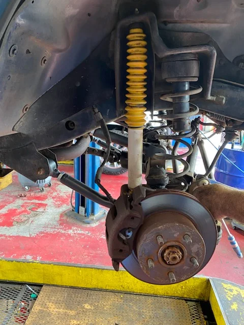

Well I have all the parts now to put the OME springs and Rancho shocks on , get all that crap PO put in, now 2.5 lift done right .
This should make for a much better ride, can't wait !

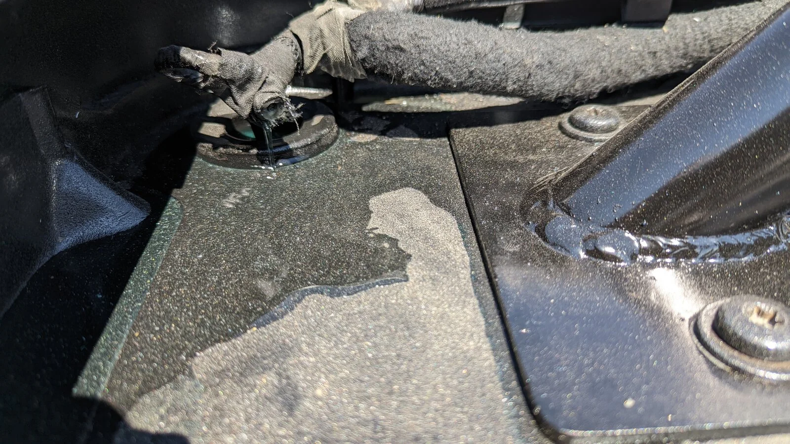

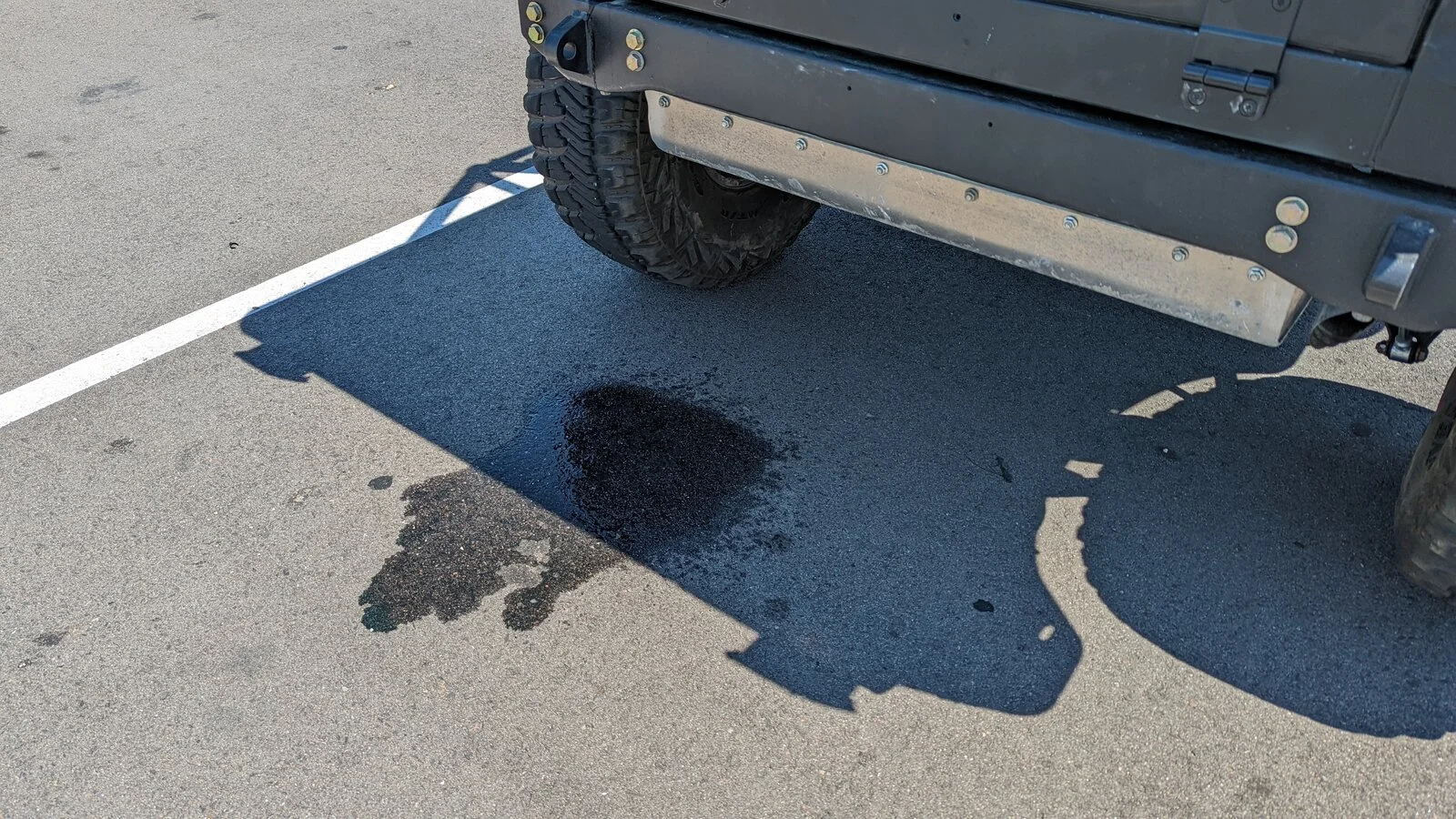

Finished it up for the most part, took it out for a test drive. Runs great and no awkward noises or smells! went to the hardware store though and came out to this...thought it was fuel from a distance and then discovered that wiper fluid was draining from the rear tube lol. WHEW!
We need to see more pictures than a rear bumper and leaking rear windshield washer hose.

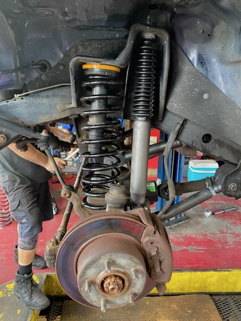

This is the mess PO had for a lift , shocks were shot.
Here is the OME set up with Rancho 5000x shocks.

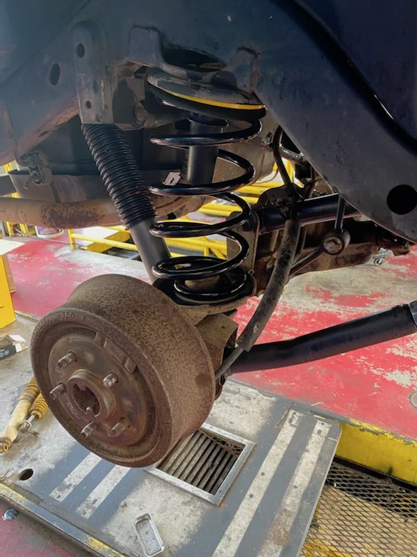

Here is the back OME springs and Rancho 5000x shocks.
The new springs lifted the jeep a good bit more , I like the stance but now I have another problem .
The rear drive shaft has vibration and I am going to have to lower the skid plate and hope that fixes it.
The problem is how to in such a short time.
Ran to Rustys Off Road and picked up a kit to lower the skid plate, hope that does the trick.

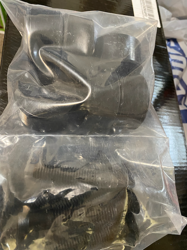

Poly bushings compress and the bolts cannot be torqued. IF you are interested; I have a transfer case drop kit available in the forums TJ Classifieds which I used steel fender washers so bolts can be torqued.
