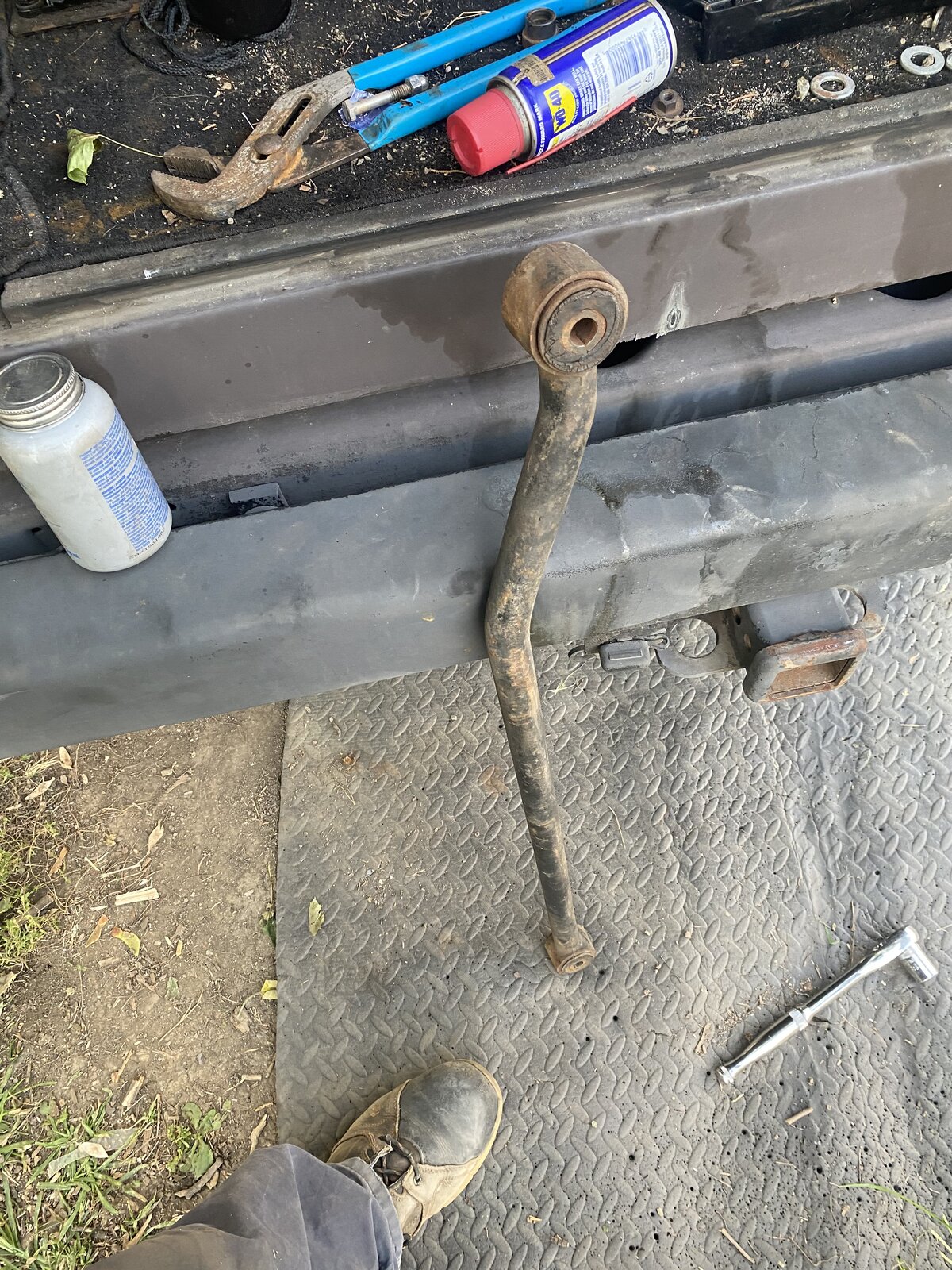

Had a few minutes before leaving for work so I decided to fuck around with the rear track bar as it’s been seized into place the two years I’ve owned my Jeep. With a few choice cuss words and some elbow grease I got it out. I have some Moog bushings to put back in and a bracket to try out to see if it will center the rear axle any better. It was a tight squeeze between the gas tank skid and the track bar so I’m not going to hold my breath on getting the bracket installed today.

I HATE rusted crap. Nicely done...
