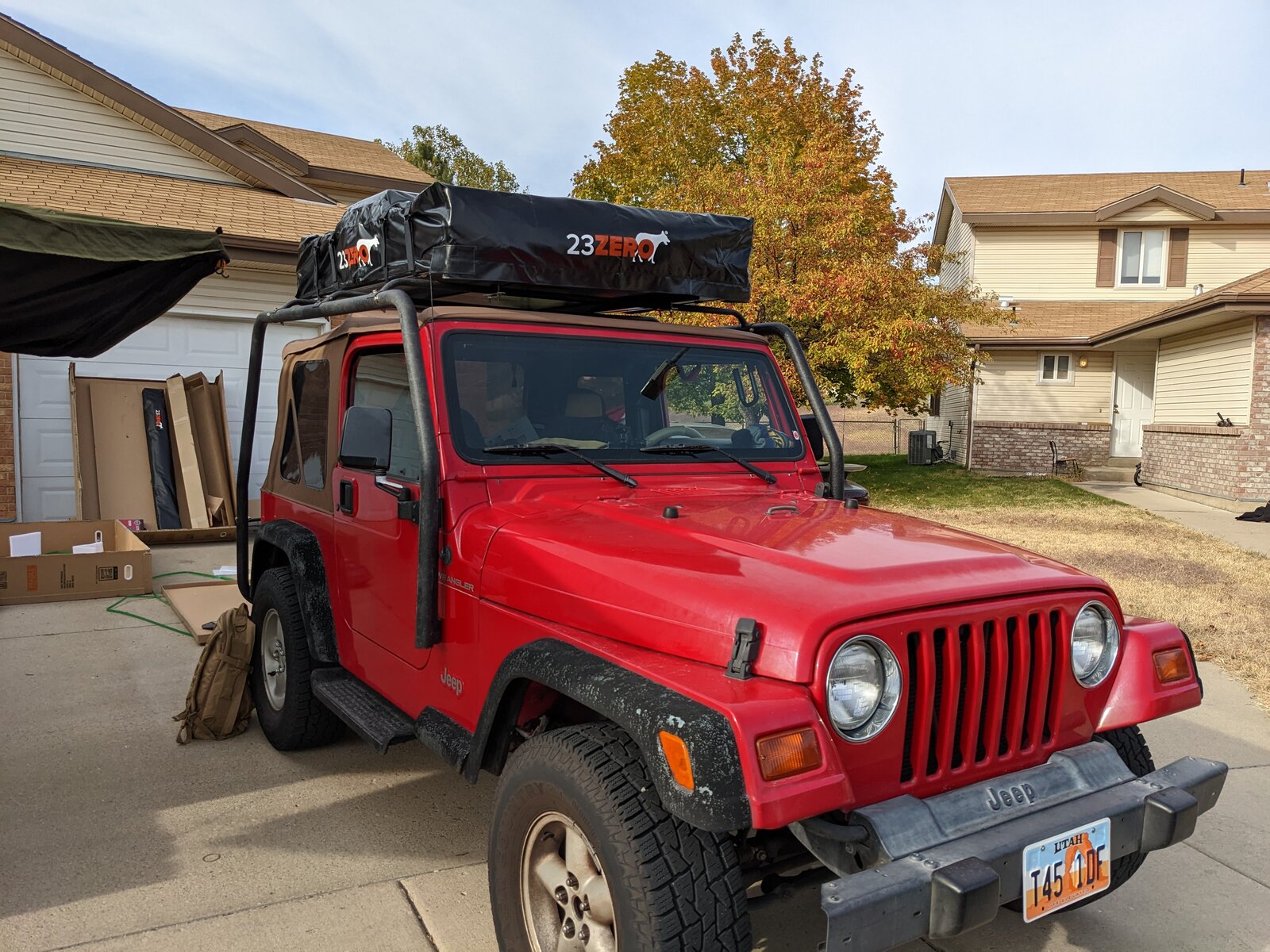

Don't care for the exoskeleton type roof rack, but love the tent.
I have an almost exact setup on mine. Here is what I have learned over the past three years or so:
Every time I get into terrain that requires 4 low, the rack starts squeaking. The flex of off camber driving stretches the bolt holes. You can tighten them to make the squeaking go away, but it does not fix the problem. I am trying to find someone that can take it off and weld the three sides pieces into one solid tube. It would still be an easy removal when circumstances demand it.
You may not be as hefty as I am, so this may not be a problem for you. I was 260 pounds and climbing in and sleeping in the tent caused the thin crosstubes to sag. I have lost at least ten pounds since September, but I still want those tubes to be strengthened. I think the simplest solution would be to weld a piece of flat iron along the bottom after heating and straightening the tubes.
I also replaced the bolts that hold the crosstubes to the sides with eyebolts so we can hang items around camp. We once used them to hang my large tarp and we sat under it all day and enjoyed our fire as we tried to empty the beverage cooler.
One more thing to look out for is that the bolts on the lower rear will get pushed into your body corners as you flex that suspension like a yoga instructor I used to date. Maybe turn them around until you get the tubes welded.
I apologize for rambling. I just thought that you could learn from my experience. Not everybody tolerates body damage the way I do.

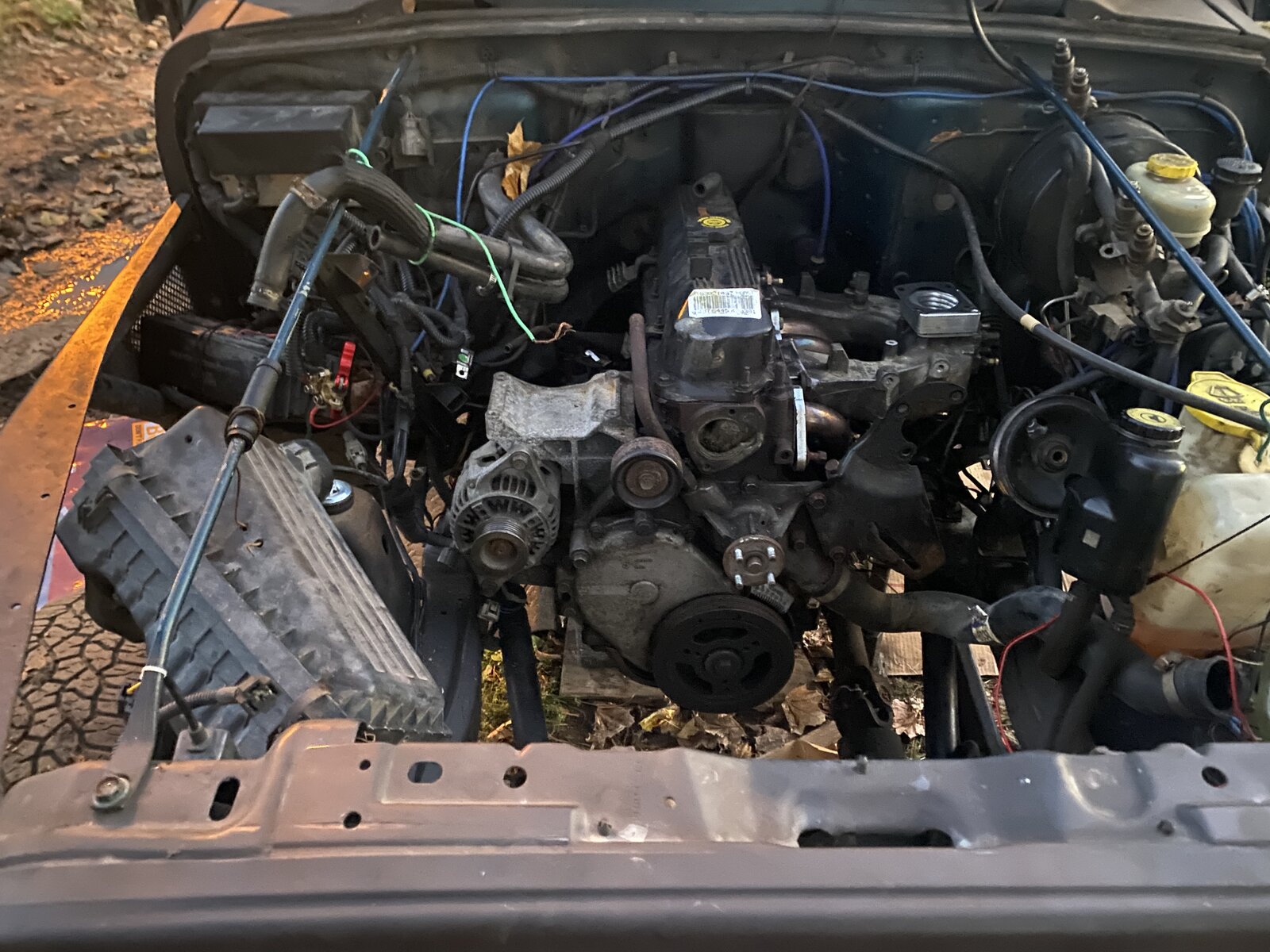

Got the engine mated back up to the transmission and bolted the motor mounts to the frame. If anyone wants to know the thread pitch for the 2.5l block it M12 x 1.75. I had read somewhere that the 4.0 had standard sizes 3/8 and 7/16 but all of mine were metric. Tomorrow I’ll hook it all back up and go over it all to make sure I’ve put all the nuts and bolts in the right places and plug all the harness back up and hopefully it will fire up 🤞🏻

Fingers crossed for you. Hope it goes great !

Keeping it alive! Love it!
