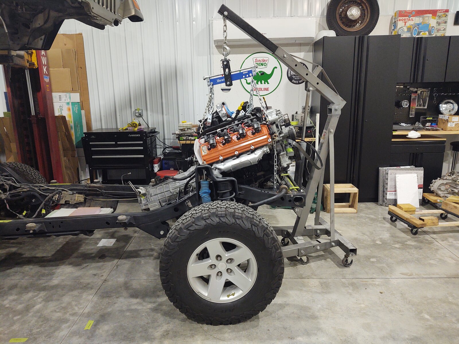

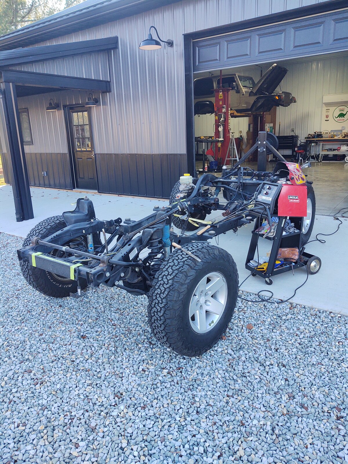

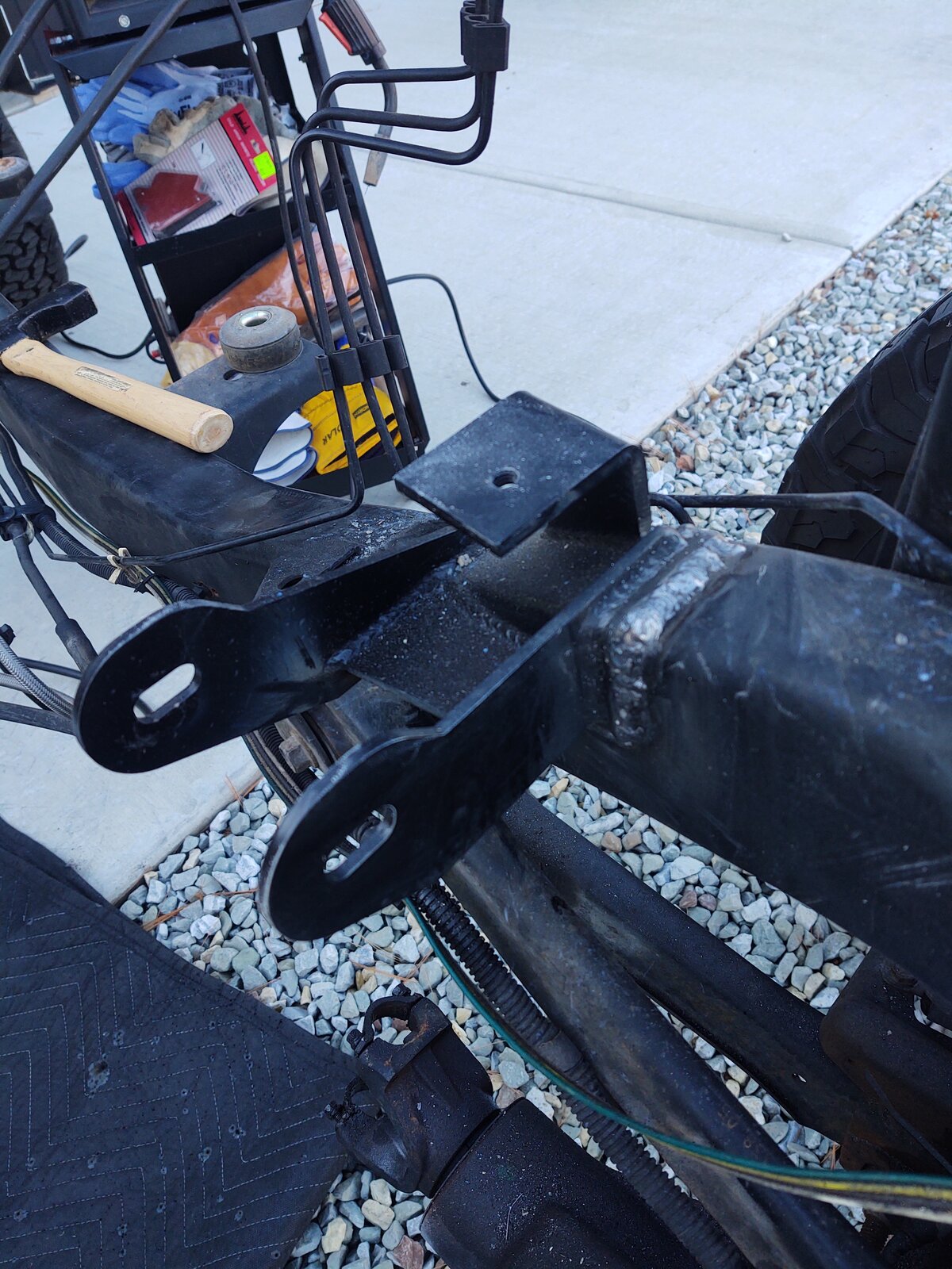

View attachment 379509Weather was pretty good today so I rolled the chassis outside to go ahead and weld in the new motor mounts after finding out the engine hoist I borrowed from my buddy won't reach out far enough to lift the HEMI in the frame... So off to HF in the morning to pick up their 2 ton hoist that reaches out about 16-18 inches farther and a couple of inches higher.. As luck would have it, they are on Black Friday sale this weekend.
I'll have to figure out which motor mount goes on which side of the motor. The Advance Adapters instructions don't specify which side..that would be handy for them to spell that out for you since they will both bolt up on either side..
Would like to use a separate transmission cross member like what Nashville TJ used. Maybe he'll let me know what he used since I couldn't find where he got the kit he welded up for his in his build thread.
Man i haven’t seen a Sinclair sign in 50 years
The cross member was originally the Genright unit I used for from my old 4.0 - I modified it to fit the trans mount on the 545RFE. The detail is over on Jeep Forum where I detailed the build at the time. Post #1512. Here is the link:
https://www.jeepforum.com/threads/nashville-tjs-coilover-build.3838225/post-40016097
@Daubie3, you should really start you own build thread. It's a great way to keep track of your build, and a very good way to get instant help on questions like this as your build progresses. Things like this get lost in this thread. I for one would love to follow along.

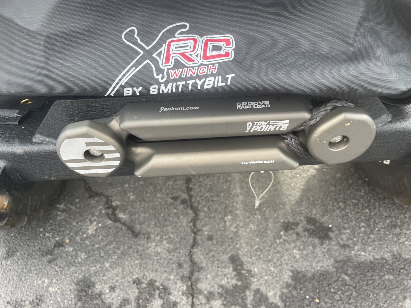

Check out his fairlead - holds the rope too-
