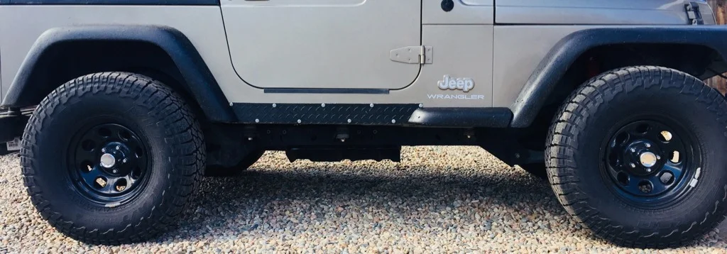

Today was a beautiful day in Colorado (before some snow moves in tonight) so, I made my own diamond plate rocker panel amor...End result: $20 worth of Aluminum Diamond Plate, self tapping sheet metal screws with rubber grommets, a can of rubberized undercoating, and silicone adhesive...BOOM [emoji95]
Sent from my iPad using TapatalkView attachment 32059
I'm surprised you didn't take off the extra trim piece for the front fender flares and just extend the diamond plate all the way up to the front flare. Either way, nice addition!

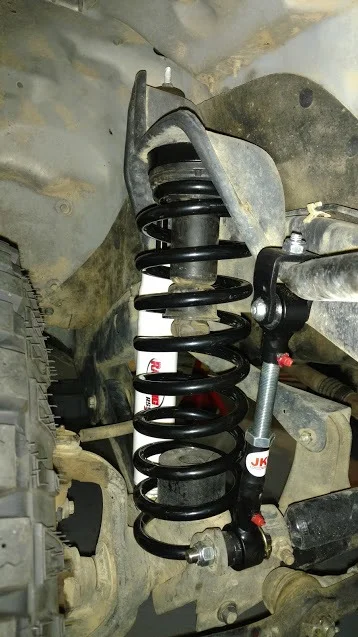

Installed BDS 2" coils. Front is done, found a leaky axle seal in rear, will have it tomorrow and finish up. The front spring with bumper, plate, winch, was 14.5" so 2.5" over stock. I also added a .75" spacer which will hopefully set up an acceptable rake. With the Moog coil and 1.25" spacer in the rear, it sat maybe 1/8" rear high and the BDS coil will be more than that. So fingers crossed.
Looks good buddy! 2 questions, how much bumpstop extension do you have there, and why? 2nd, your quick discos have a ton of thread showing. Are they 0"-2" lift discos?
Reactions: StG58
2" RE stops. They are spot on with the shock travel. I run 2" in rear also and could go to 1.5" but didn't feel like cutting off 1/2". The disco's are the 0-2" and I have them at their max length per the instructions. I haven't really looked at them and the Jeep is currently ass in the air waiting for that seal to finish up.
