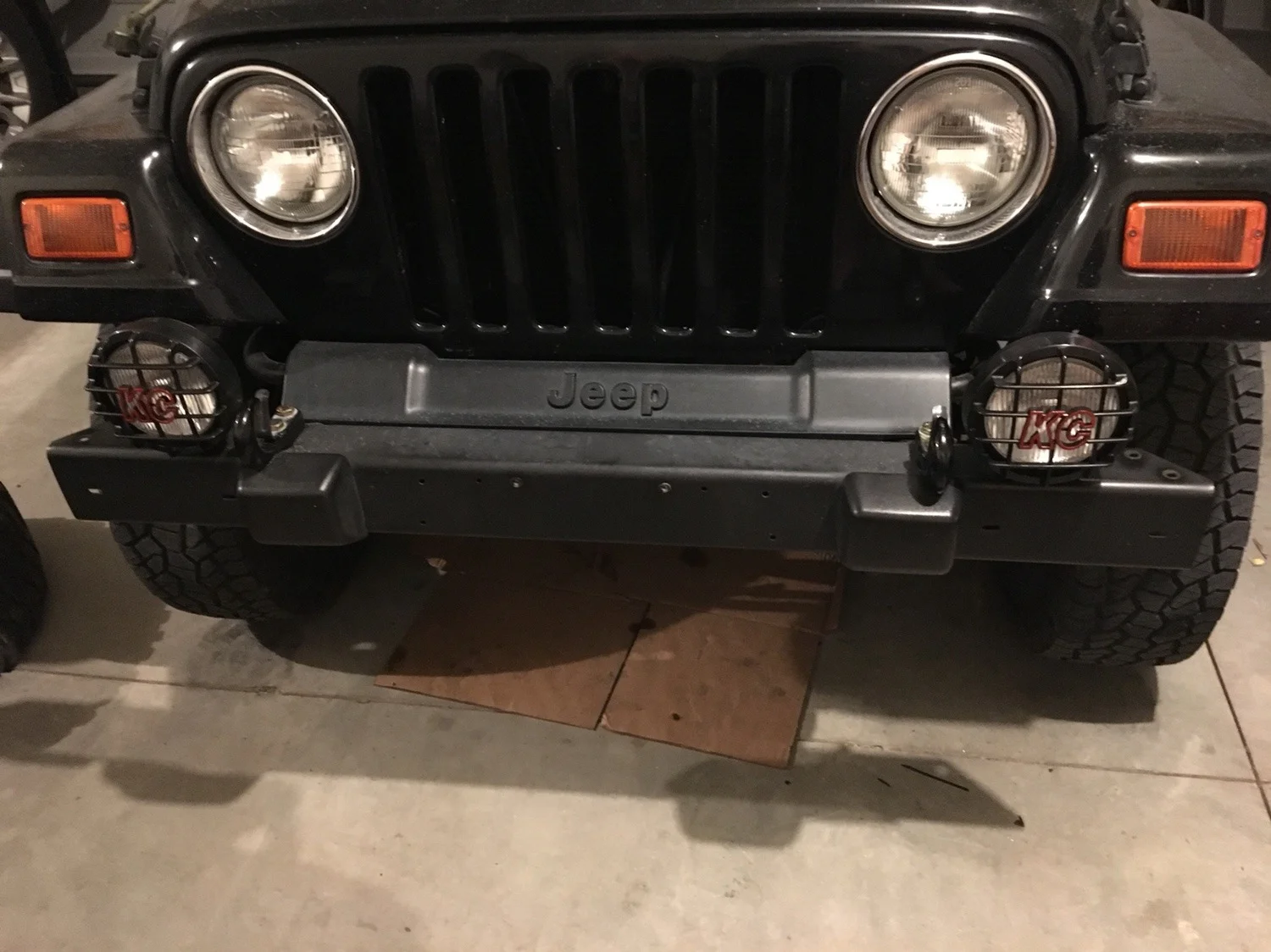

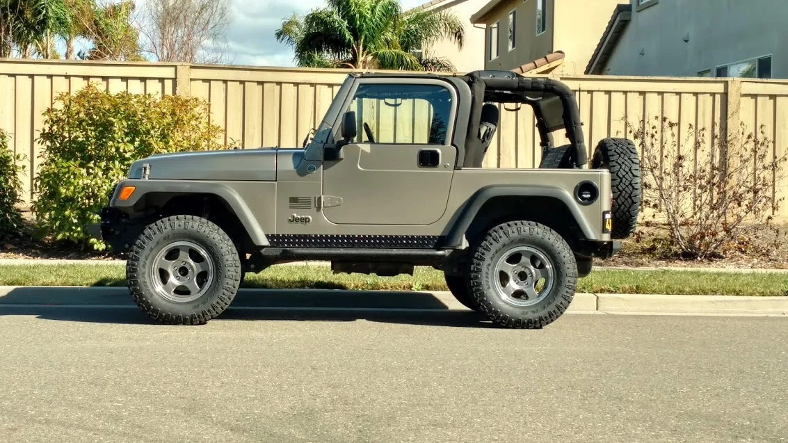

Finished up the BDS coils. Rides great, about the same as the Moog coils. I took a chance and went with a .75" spacer in front and glad I did because it is sitting about 1/4" rear high. I'd prefer a bit more but I will take that. Without the spacer it would be a solid 1" which is too much. It did induce some vibs from 20-25 and worsened a very mild vib at 40-45, both on acceleration. Ran it up to 75 and no vibs beyond 45. I already have a MML and am going to hold off doing anything with the t-case until it settles in. With winch/plate/bumper front is 14.5", rear is 10.5" coil lengths.

Sitting perfect @Rob5589 !
Looks great! We are in the BDS crew! @dla is on to something with BDS. I think 3” coils in front and 2” in the rear makes it look perfect without adding any spacers to level it out.

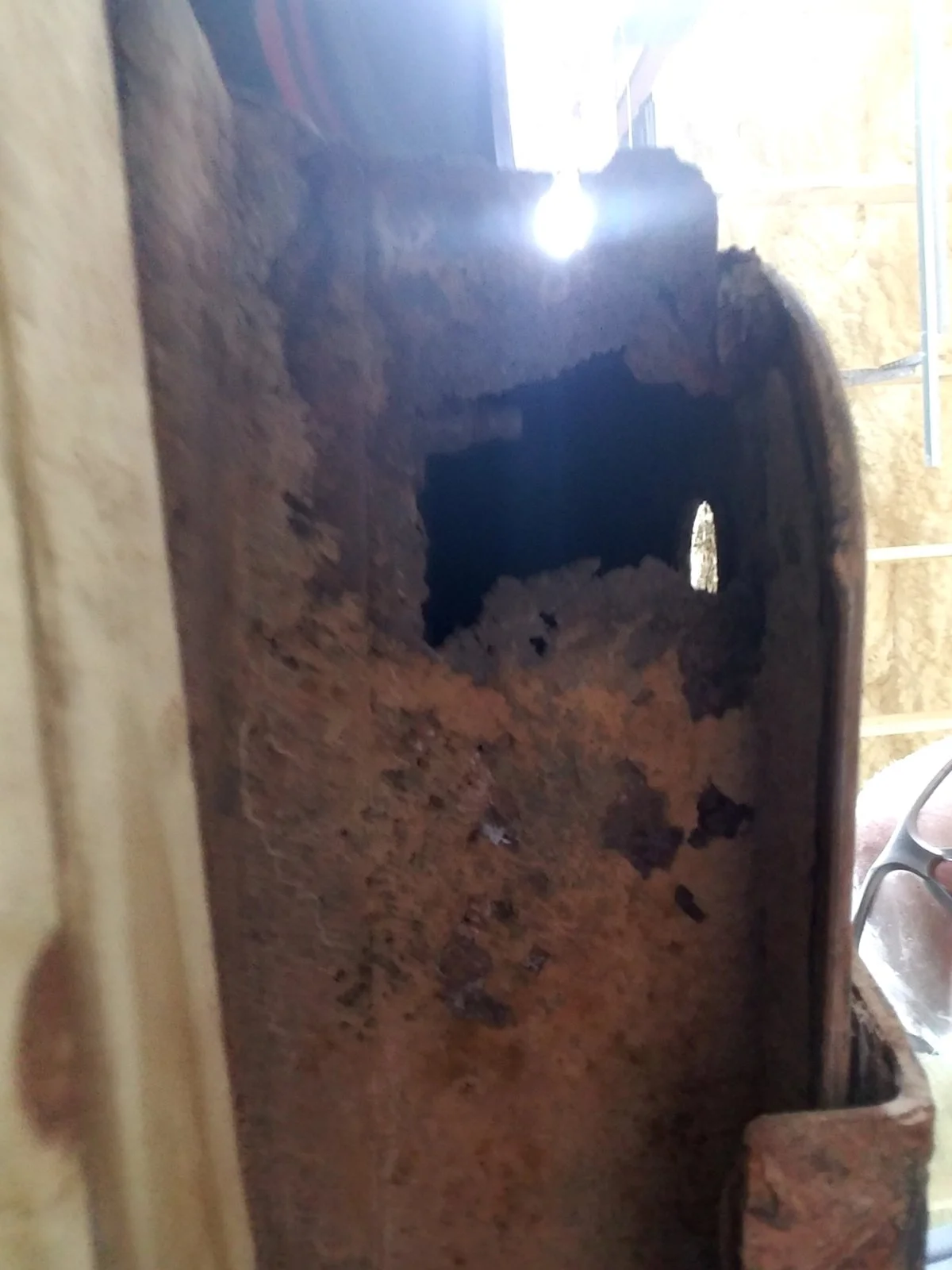

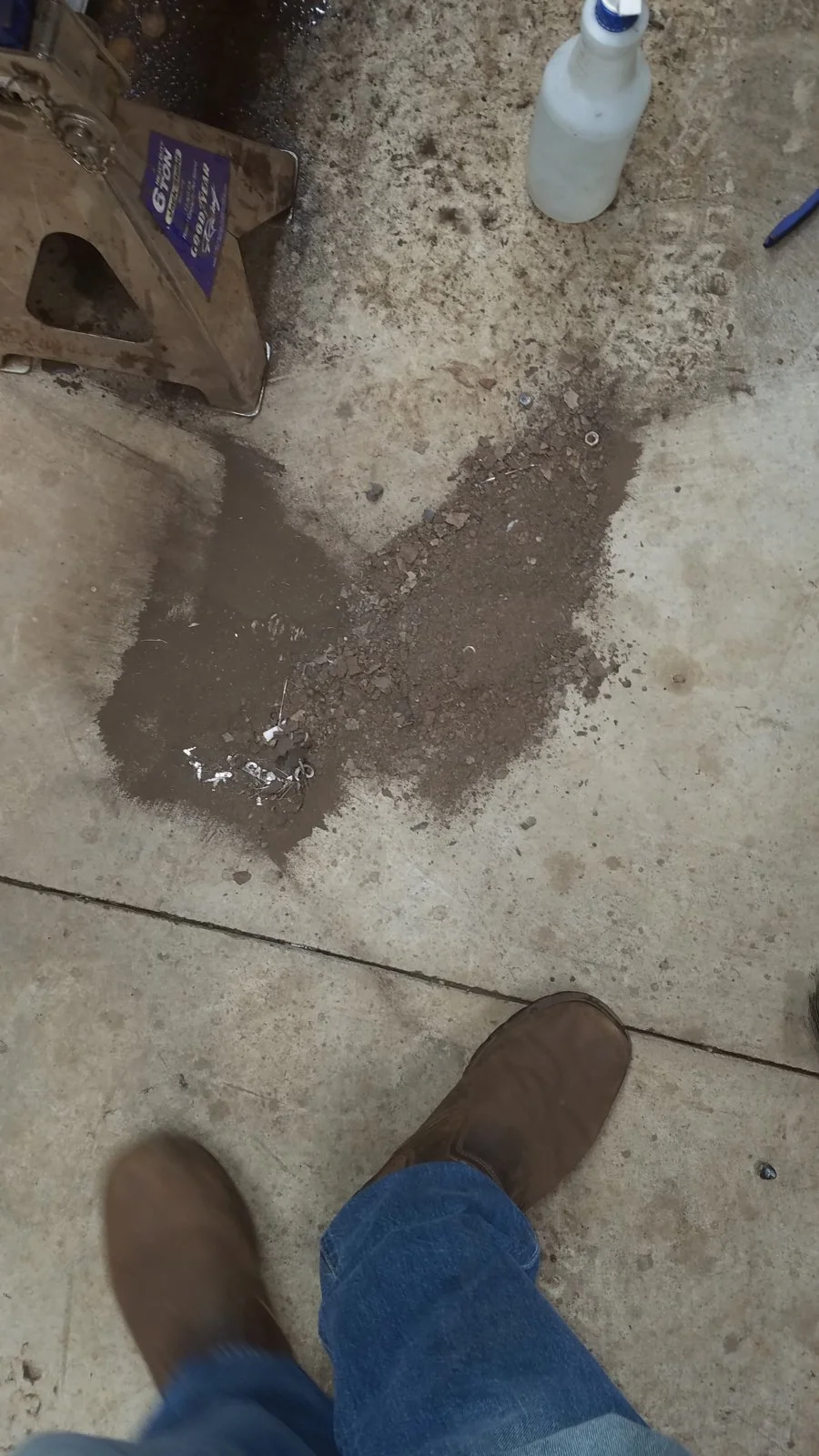

I sucked a bunch of rust dust up my nose...
This pile is from my passenger rear well well...View attachment 32386
Oh, and found a hole :mad:View attachment 32387
I think that those of us who have suffered at the hands of the dreaded tin worm should no longer acknowledge it as rust, but instead refer to our TJs as the "Lightweight Edition", or LE for short... :D
Ha! I like that. I now have a Rubicon LE. Even better. Problem is, I'm going to cut and patch, and the way I weld, there isn't going to be anything lightweight about it!
