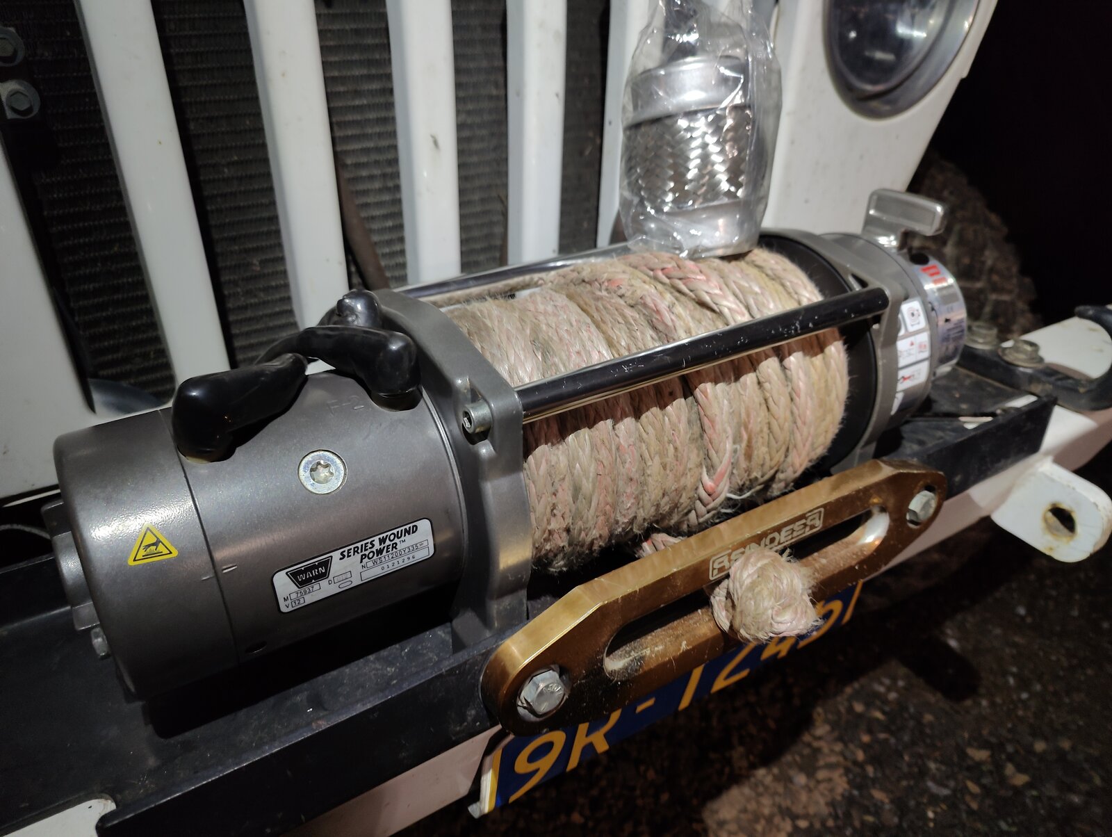

Winch got back from Warn. New motor and drum. Bolted, wired and spooled it up. Ready for whatever adventures we throw at it this weekend!
Also my flex pipe arrived from Amazon. Going to pull the front down pipe off and put a flex joint and v band clamp just forward of the CAT.

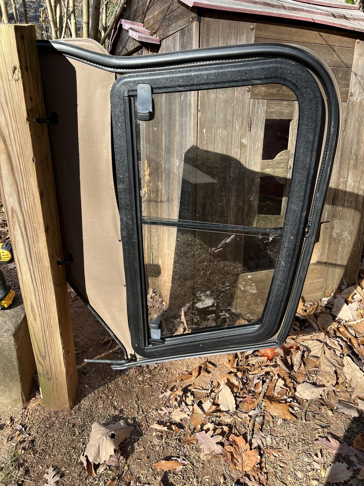

My next obstacle is the passenger half door soft top uppers doesn't seal worth a damn against the hard top.
Try bending them first, just not while in the door. I drilled holes in a fence post so I could tweak the angle, my new uppers needed an adjustment and are now leak free. Before I got the new ones, I did 5/8 nylon rope pulled through with fish tape. Pain in the ass todo but worked really well.

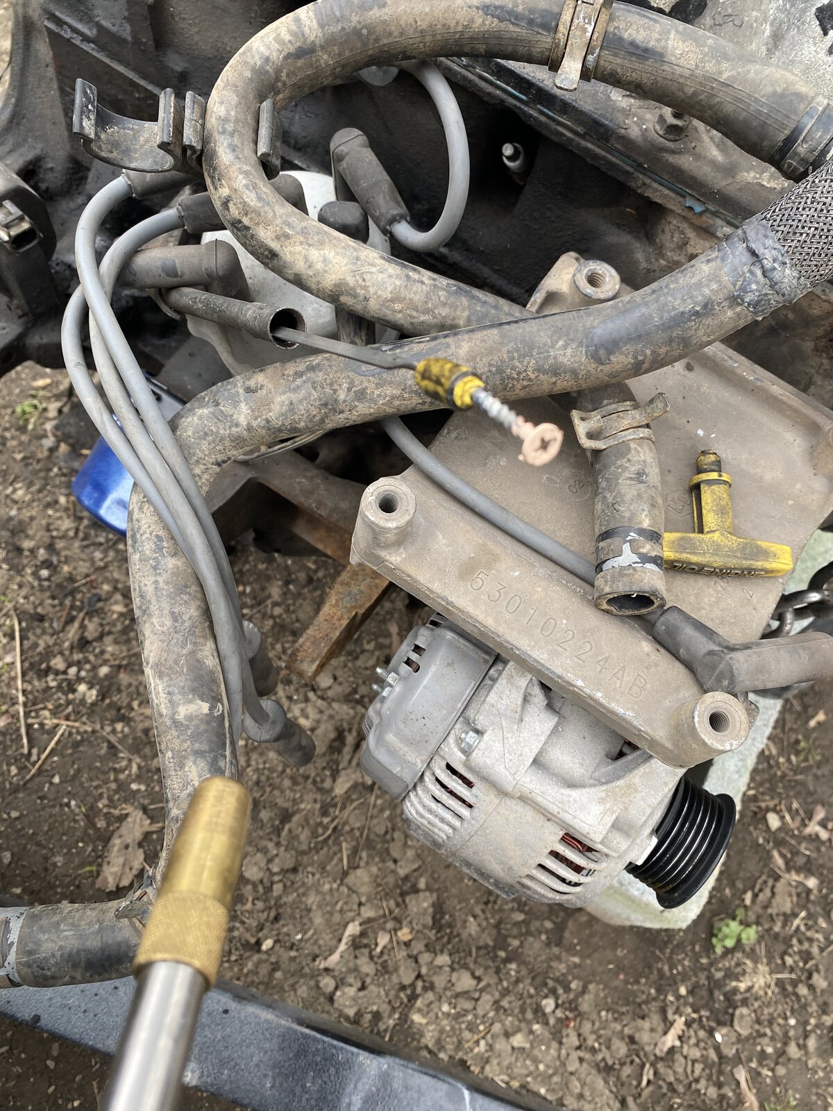

Got a replacement dipstick delivered today. The engine I picked up last weekend has a broken one stuck in the tube. I’ll try some old injection molding tricks to get it out before pulling the tube out aka heating up a wood screw and sticking it into the plastic and allowing it to cool down. Hopefully there’s enough plastic to make it work.

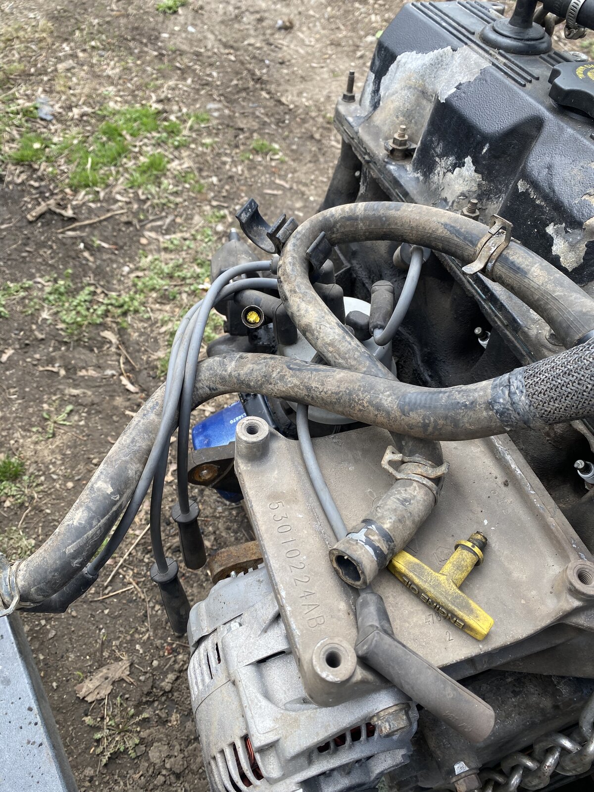

Got the old dipstick out and the new one in. Worked a little bit on cleaning up the crud and caked on grime. Pulled the heater hoses off and the old radiator hoses too. Still need to pull the valve cover and inspect everything but a little progress is better than none. My daughter has the flu so I’m taking care of her while the wife is at work.
